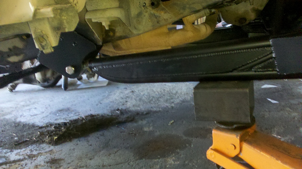

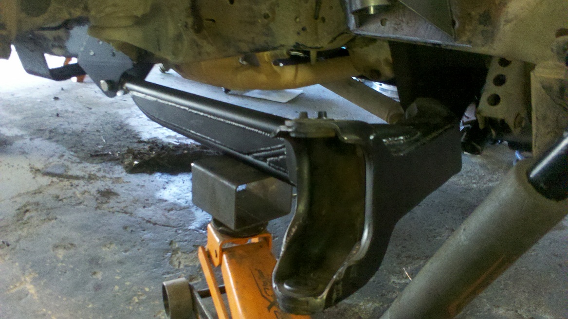

Ok here we go guys......by the way Dave builds thing tough so if it looks over built to you.....it maybe...... but not in his eyes....That’s his style keep all 4 wheels on the car at all time…..and foot to the floor
It is set up to have the 44 from the left of the pumpkin to the pivot. it bolts up to the stock bronco/f150 4x4 pivot point on the frame on sides with both beams they are about 5 over per side due to the Hummer wheels he is using......started off at 2.5 / 3 but the wheels are deep off set so he extended the beam out a little more.
Beams are built strong and can use 44 or 50 center section. This is not just a scabbed on outer and knuckle it is a total reconstruction off the beam…..It can also be set up to run the 44HD outers with lower ball joint mods as well….44hd and 50 beams are a different spread were the outer are…not a lot but just enough…the 50 also have a thicker lower were the cut and turn is done…….
Note....if you were to use Dana 44HD it can be drilled to 5 on 5.5 the Dane 50 I think you would have to go 6 on 6.5 Trophy Truck....this is if you did not want the 8 lug stuff
I am feeding you info second hand from Dave teaching me and showing me he can explain a lot better…..so let’s look at cool stuff

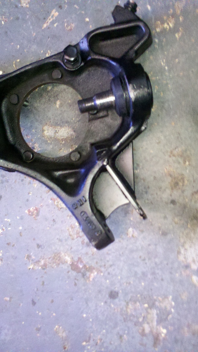

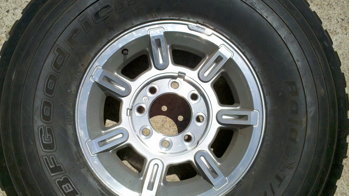

setting up the Steering and wheels
- hummer bfg.jpg (287.48 KiB) Viewed 9663 times

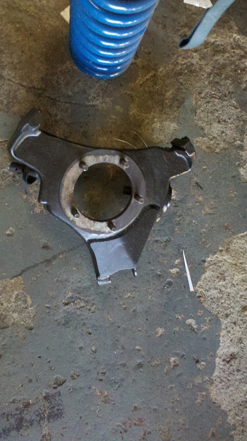

- dana 4450 knuckle2.jpg (278.74 KiB) Viewed 9663 times
- dana 445o knuckle 5.jpg (287.15 KiB) Viewed 9663 times
- dana 4450 knuckle3.jpg (275.13 KiB) Viewed 9663 times

- dna 5044 nuckle1.jpg (190.64 KiB) Viewed 9660 times
- dana 5044 beams3.jpg (226.93 KiB) Viewed 9660 times

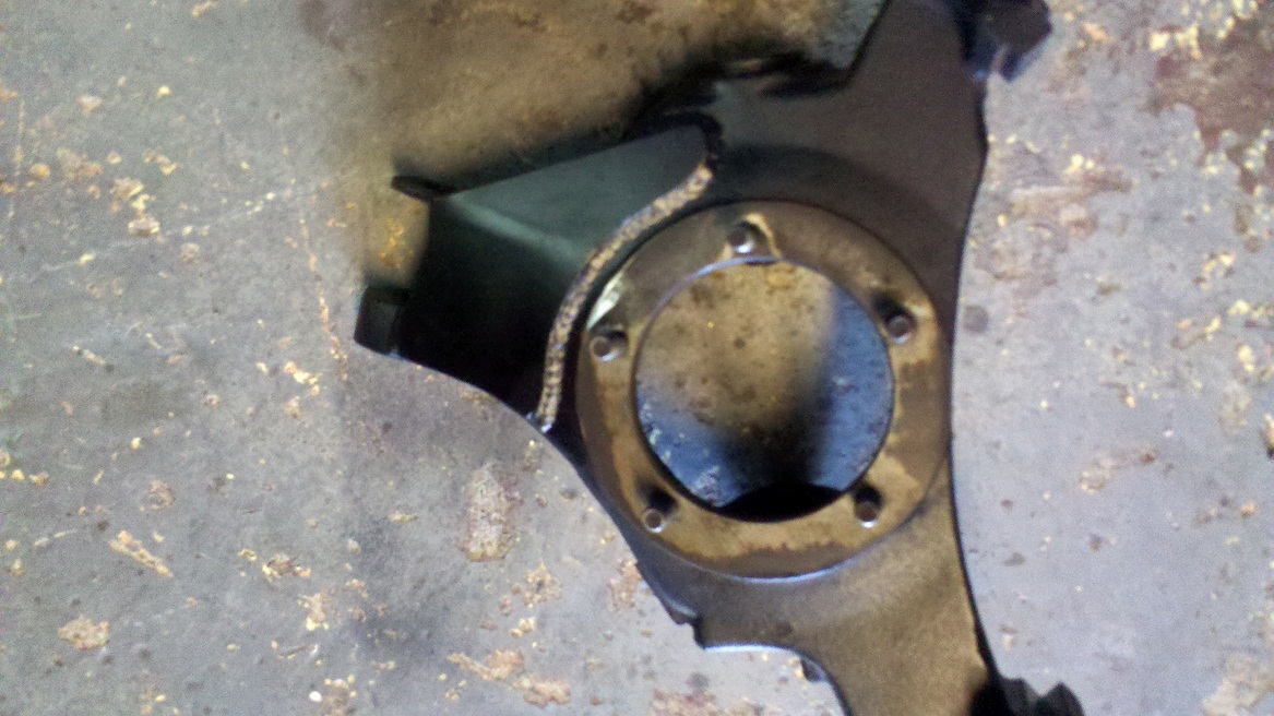

I see alot of people welding to the stock knuckles. I assumed they were a cast piece? Are they actually forged? How are people getting away with that?
I think they are cast but can't say for sure as I haven't meesed with many other than ripping them off trucks & just selling them.
If they are cast, pre heat, weld with a high Nickel rod (stainless works well), post heat & slowly cool.
They are cast.ESHALLBETTER wrote:I see alot of people welding to the stock knuckles. I assumed they were a cast piece? Are they actually forged? How are people getting away with that?
You can use high nickel or stainless rod with preheat/post heat to weld to them.
You can also use silicon bronze and braze to them I think.
I've uses silicone bronze & TIG welded on cast before & it seemed to hold. It was not in a high impact/stress area though so I can't say how well it actually works.

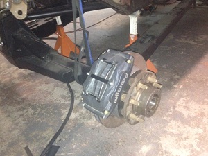

Dave has been working on the bronco again.....
Rear 4 link done
new sheet metal done
Fuel tank in
14 bolt snouts in a Dirt Tech housing 35 spline .....
Rear 4 link done
Fuel tank in
