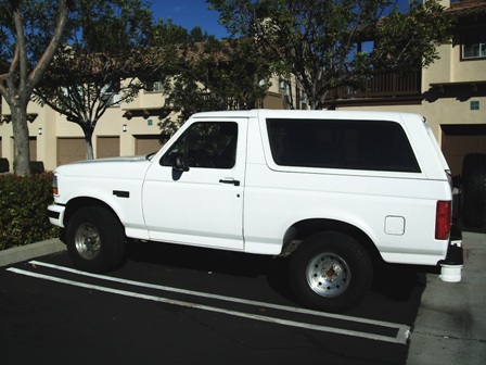

I traded a pair of seadoo's for this thing aprx 3mo ago. It was nasty. Looked like it was stored with the top off under a walnut tree. Everything that was in arms reach of the driver was broken. Outside mirrror, rearview mirror, armrests, gauge bezel, shifter trim, door handle missing. Passenger glass was smashed. The everything was leaking. Brake caliper bolts where stripped out. everything was covered in mud/clay(used in the salton sea area=naaaasty mud) A/C didn't work. Radio didn't work. headliners torn and sagging. Abs light on (thinking a abs tone wheel missing from a brake job)
So on to the good. It's a 96 w/ maf so cams and go fast goodies should work well on it. This also turned out to be a downer now knowing that with the obd system smog laws aren't as forgiving and there are very few go fast goodies marketed for it because it's the only year of the obd bronco.
So... I threw a couple hundred bucks of parts at it. Tore out the rear carpet. Put in a ham radio and went to mexico for the thousand! It was a learning experience to say the least. The list of things I thought it needed doubled but I forgot the first half from all the exhaust fumes I huffed on the trip so what was I saying....

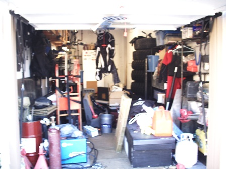

- The closet I have to work out of
- PICT0051.JPG (70.63 KiB) Viewed 5121 times
- How it sits as of now
- bronco resized.jpg (65.89 KiB) Viewed 5121 times
