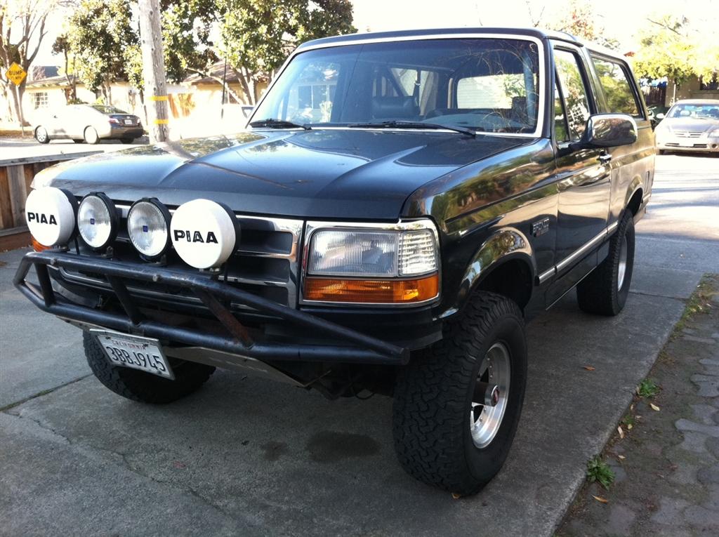

I’ve been wanting to build something with 4 seats for a while now. With two kids, I was tired of not having a backseat in the Ranger. But I loved the TTB 4wd of the ranger, so it was either going to be a bronco or explorer…I think the bronco will be an easier project, especially since this one is well on its way.
The story goes that this bronco was built when it was brand new from the dealer, delivered straight to Spirit Racing. This is kind of cool to me, since this was right around the time I first got into offroad racing and attended my first Score race, the Fireworks 250 in Barstow. So while by today’s standards it is a little old school, it’s period appropriate for a 20 year old truck. This is also around the time I had my first car which, coincidentally, was a black bronco (an ‘81)…and I was so jealous of my best friend’s older brother who had white fenders and a cool prerunner bumper. Here’s what I know about the truck now, but the further I dig into the more I find out…
*351W with Vortech supercharger, CA smog legal.
*E4OD – I assume original trans. I don’t know of any modifications…who knows.
*Front suspension by Spirit Racing. Custom coil buckets, 3 bilstein 2.0 shocks per wheel, steel braided cable for limit straps.
*Rear suspension by Spirit Racing. 8.8 Trussed and tabbed by Spirit, 3.55 gears. 10 leaf spring pack, manufacturer unknown…my guess is National. 2-link traction bars. Two separate bolt on rear shock mounts. Front one mounts 2 shocks each side angled forward from axle. Rear mount supports gas tank and has upper mount for 2 shocks that mount on rear of axle and angle inboard (one each side).
*Front and Rear bumpers were done by a shop in Santa Cruz.
*Simple cage also done by the shop in Santa Cruz. It terminates to large plates on floor of cab. Bar behind front seats is removable for regular driving and easier access to backseat.
*2 Piaa lights and 2 Hella lights on a removable light bar attached to front bumper…Rear facing rectangular Hella light.
*Bumping Stereo. 12” sub in back, and amps/wires going everywhere. I doubt I’ll keep all of it in there, the sub is HUGE and not a priority. Hopefully I can figure out how to elimate some of the ridiculously complicated stereo while still keep it sound nice. Wiring is not my specialty.

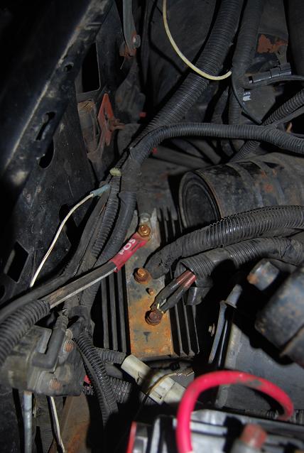

Here is the isolator by the battery. Middle post = 2 wires to alternator, top post = one cable to + battery terminal and one goes into cab (stereo, etc?), bottom post goes into tow wires that disappear into wire looms, haven't been able to trace.

Does that have a 6 or 7 post trailer plug on the back? If so that isolator is for charging a trailer battery.
Optimas are still a good choice, just not as tough as they once were. Still the best bang for the buck price wise.
Anything better (Lifeline, Odyssey, Northstar, ect) will have twice the price tag. A group 65 Odyssey is about $300-$350 vs $200 or so for a yellowtop.
I do recommend the deep cycle Optimas over the starting. FYI, Red = starting, Yellow = deep cycle, Blue can be either (bottom color denotes deep or starting).
The top color should be ignored. Light grey = deep cycle. Dark grey = starting.

What changed?philofab wrote: Optimas are still a good choice, just not as tough as they once were.
What does the blue top mean? So, ignore the colors?philofab wrote: I do recommend the deep cycle Optimas over the starting. FYI, Red = starting, Yellow = deep cycle, Blue can be either (bottom color denotes deep or starting).
I have a red top optima that's probably 3.5 years old now and it still works great.
Re: Wood's 92
Blue top means Marine. Marine uses starting and deep cycle batteries. Biggest difference is an automotive terminal and a stud. Reds and Yellows have side posts and auto in 34/78.Phoenix0783 wrote:What changed?philofab wrote: Optimas are still a good choice, just not as tough as they once were.
Optima was acquired by JCI (Johnson Controls) and manufacturing was moved to Mexico a couple of years ago. Many people have voiced issues since this happened.
Re: Wood's 92
hmmm...maybe, I'll have to look again. It was wired for winch front or rear also, and has a pretty elaborate stereo system. I figured those things might have been running off a second deep cycle battery.philofab wrote:Does that have a 6 or 7 post trailer plug on the back? If so that isolator is for charging a trailer battery.

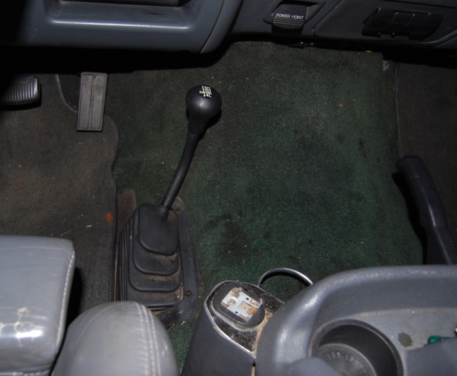

Man, upon tearing into this thing, it's crazy...I found the craziest alarm system wired into it. A custom box was built under the center console. I thought it just housed a 10 disc CD Changer. Turns out that's where the alarm was...an old clifford alarm, seperate remote start unit, and a separate Smart Windows unit. I guess someone wanted to go prerunning but still be able to disarm alarm, start the truck, open the windows, and crank the stereo all with the push of a button. This is going to be a pain in the butt to sort out....maybe I should just stuff it all back in there and forget I ever saw it!
Re: Wood's 92
Some general maintenance over the last few days. New cap/rotor, new spark plugs and wires, new belt, air filter...next to change all the fluids. I will tackle all that but I think I will take the transmission in for a proper flushing.
I also decided to remove the rats nest of alarm wires under center console...I was very careful to trace wires before hacking away. Then when I got it all out I still couldn't start the engine. After hours of following wires and staring and scratching my head I found out the fuel pump inertia switch was tripped... I must have triggered it when I was fighting the kick panel to get it out from behind a-pillar of cage. What a pain. Still need to clean up all the wiring, bundle everything back up nicely and wire power window and locks switches back up. They were relocated to center console because of custom speaker install in doors.

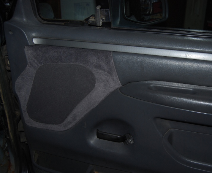

custom speaker install in door panels

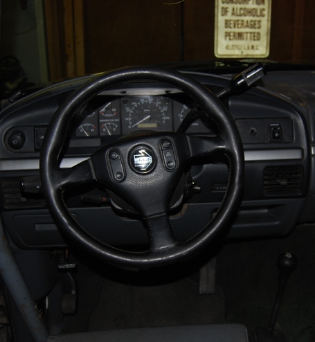

Momo steering wheel, with cruise control buttons.
- momo.jpg (105.38 KiB) Viewed 1927 times
Re: Wood's 92
This truck has a some super cool features. I dig that steering wheel.
