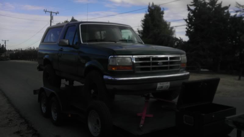

87 Ford 302 Bronco 4x4 we plan on one day racing this new toy of ours, currently it will be set up for the new Stock Truck class Lucas Oil SC series, but I did notice there are a few other desert races I can take this to so I'm going to keep my mind open to both rule books in case we decide to compete in the desert series out there...

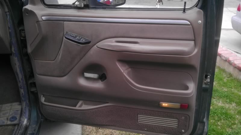

I pick up the bronco this weekend and plan on stripping the bronco and prepping it for the cage and other items to allow us to race, so if anyone is interested in door panels grill and lights front bumper rear bumper, let me know! I will post up the stock seats and dash and other items I will be not able to use including the rear cab shell, stock fuel injection, heater core, AC, etc., etc.... So if you’re looking for something let me know... And I might be up for trades on the items I will have up for sale...

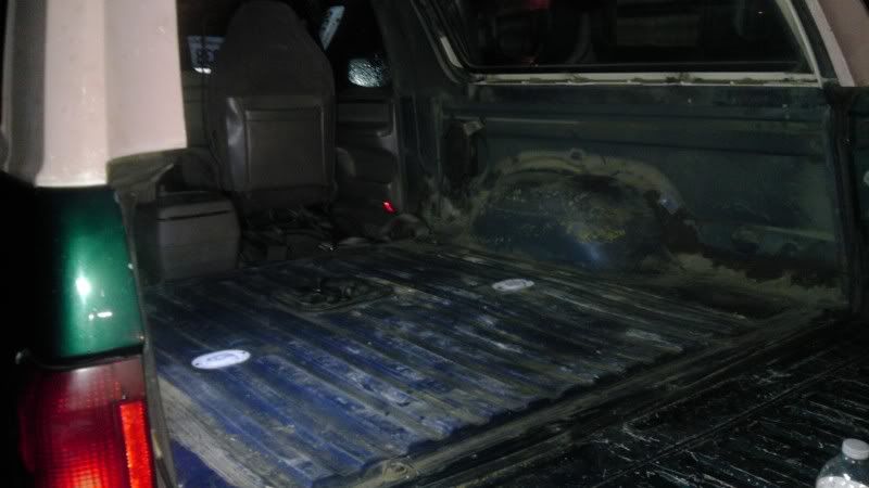

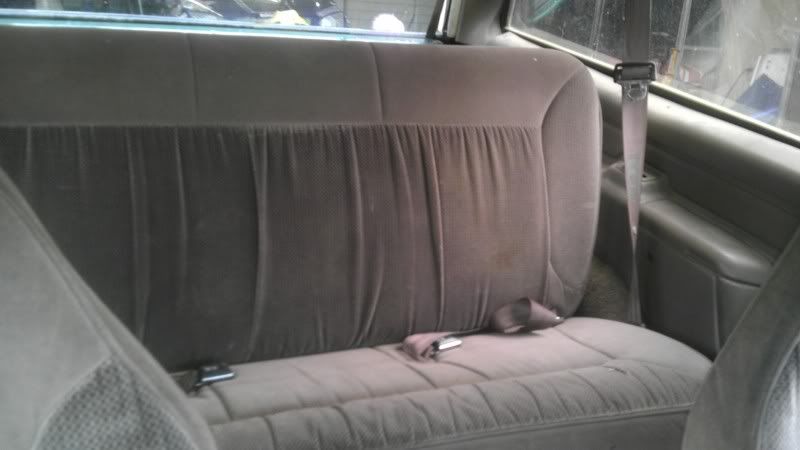

I stripped out the head liner front and rear last night, and the rear seat and the carpet, and all the rear interior, which is now going up for sale once I've had a chance to clean the parts... Here are some pictures I took yesterday...

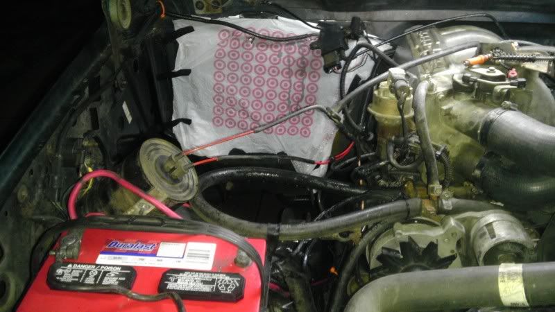

Update, Bronco is running after I pulled the dash, heater core, and all the wire from the electric 4x4 and the wiring harness for the Pwr windows and other accessories that will no longer need to be in the harness... Talk about fun...!

Now that it has been cleaned and started, I'm finding all my oil leaks. So I've moved to pulling the motor, so I'm picking up my cherry picker tomorrow.
The oil pan shows signs of leaking (which unless someone can tell me how to pull the pan with out pulling the motor?) which I wasn't really shocked about, and since I've been hearing that a lot of the trucks in this class are burning up or blowing up I would like to start off with a advantage of not showing up with something that is just thrown together...

Unbolt the motor mounts and lift the motor up. You should be able to get the motor up far enough with the trans unbolted from the crossmember to drop the pan enough to replace the gasket.

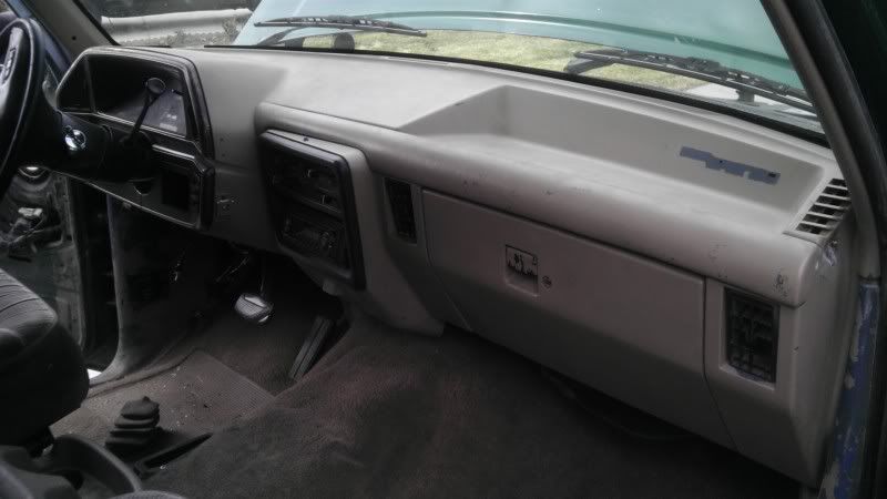

Finished cleaning up the harness last night, removed all stereo wire and heater control harness, interior dome lights, anything that wasn't needed was removed.
Now my next question is for the guys that do run stock fuel injection do I have to keep the dash in order for it to work correctly? My Bronco starts up and runs like it should with all the stuff I removed and I don't want to go too far and find out I made a mistake, and not have it start up and run like it should...
BTW I'm addicted to my new toy!
Already cleaned up the stock cover for my dash in case we still have to keep it...(I also removed the vents to allow for other gauges)
