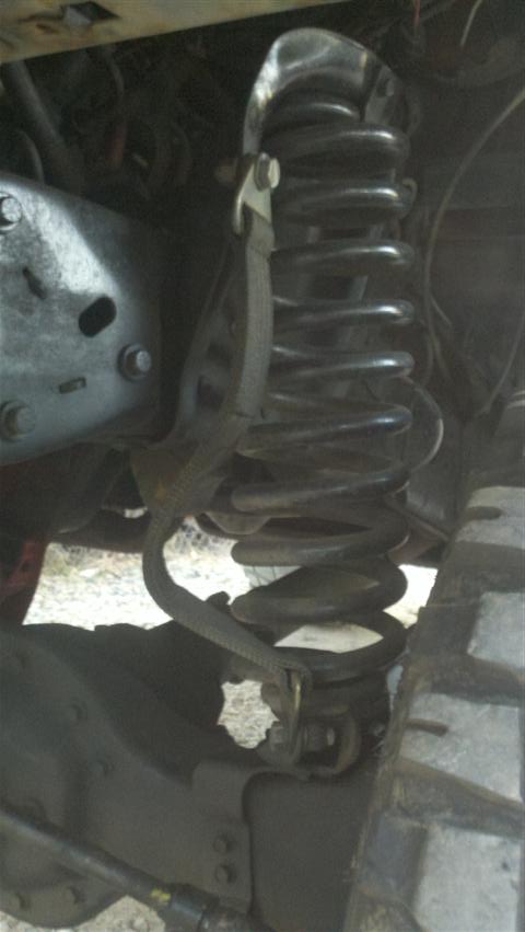

Suspension
2011-10-31_17-45-41_396 (Small).jpg (49.36 KiB) Viewed 5882 times
2011-10-31_17-45-48_5 (Small).jpg (87.37 KiB) Viewed 5882 times
2011-10-31_17-53-00_757 (Small).jpg (101.28 KiB) Viewed 5882 times
Re: Josh aka greaslifes 86
Is it missing shocks in the front? That coil bucket could be a real good start if you reinforce them. A shock mount could be simple. Definately remove the limit straps that could be dangerous though. Good start!

Looks as though the radius arms are an old dick cepick kit and the steering is a super runner or copy of one.
Yeah the steering does look identical to the super runner set up.

How is the supper runner i have red mixed posts on it. The previous owne told me he thaught the steering box was going out because it felt lile it would lock in surton spots. Is that the nature of the beast? Any thing i can do too improve the system. I do have fab skills
I would not run the super runner steering. It adds complexity and does not do anything to help bumpsteer.
You know the stock steering works really good. If you can get it on the cheap you can replace the parts easily.

Bronco looks good, it also looks to me as though it is missing shocks haha, but its a great start.
That roof rack won't help gas mileage at all. Let me know if you decide to parts with it ;)
As for the coil buckets - stock ones can be modified pretty easily for a taller shock and can be cool. I've got a set of stock ones here if you want to start messing with some off the truck. A few pics of people's setups with these are around here somewhere.
