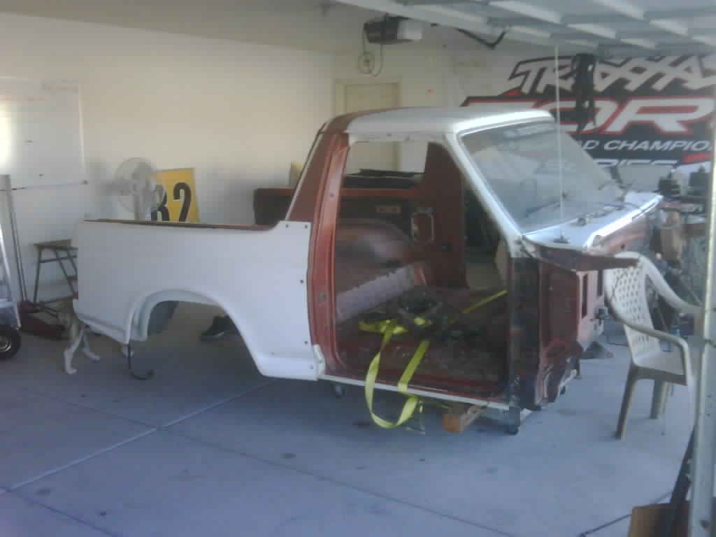

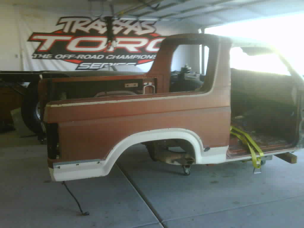

Finally got my body back to my house. Been cutting bedside off and starting to remove dash. I'm going to strip it out and then paint shell. Hope to get it back on frame in a month or so. I should get it in running condition in a few more months.

Have any pix of how much was cut? Also what brand bedsides are those?

i used cut odd wheels to trim it off. I need to trim it some more and grind off sharp edges. Autofab bed sides. Shitty pic, more to follow.

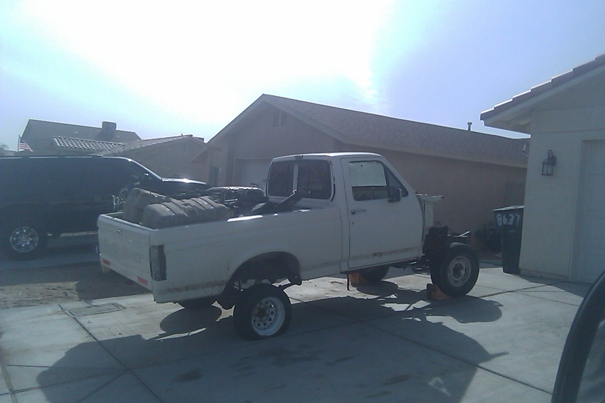

Finally getting some work done on project again.I ended up buying 91 f150 4x4 for 800 bucks sold wheels tire,fake hood and assorted crap and got my money out of it.I took out motor 75K....seems right for the mileage and wear and tear. I stripped all the fuel system,wiring out and saved whatever I could, then gave away what was left. I told the guy he could have the truck but he had to take everything that was in it! So I'm installing fuel lines,wire harness everything is starting to take shape. I cleaned out gas tank from other beater Bronco that I had previously. Starting to look like it may all fit back together! I hope to get the body back on before fall, then work on building cage when it cools off here (111 degrees today) Neighbors think I'm nuts....I was washing the chassis before I put it back in garage to work on it. Keeps me off the streets at least!

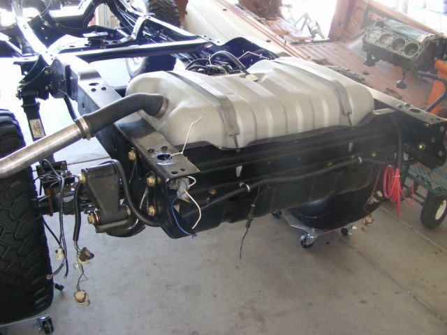

Some new pictures...I have been working on brake lines, wiring, fuel system. So far all original ford stuff, I have been cleaning stuff with wire wheel on grinder. Simple green cleans stuff up really nice. Wiring,fuel lines from 91 F150 I bought.

The driver side rear leaf clamp on compression will whack the gas fill tube... put a new hole in the clamp so you can cut it down as far as possible and round the edges.

10-4 thanks Kris

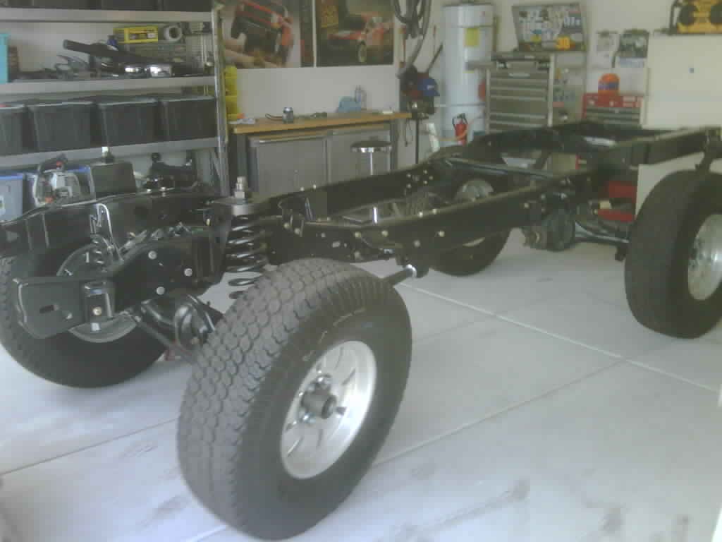

I thought I would throw up some pictures of the Bronco. Coming together a little at a time. Money been short so a lot of cleaning rebuilding,painting polishing etc. Hope to get the body shell painted and back on the chassis in the next month or so. sorry but just getting Photobucket going so excuse the order of the pictures. I'm trying to get everything separated and in order.
