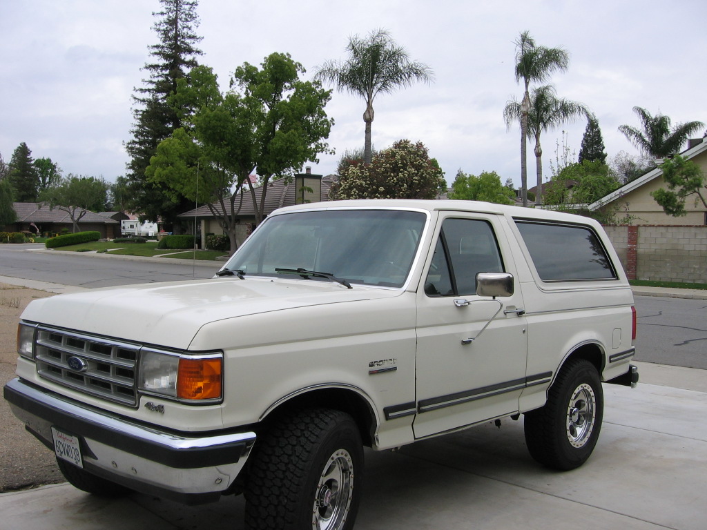

It's getting close to tear down time so I thought I would get the info that I have up on the GFB. Some History on the ride:
1987 Bronco XLT 5.0 AOD 3:55 LS rear. This Bronco was purchased by my Mom from Jim Burke Ford in Bakersfield in May of 1987( I have the Ford build sheet/window sticker and 20+ years of documentation on the Bronco). This was her first new 4 wheel drive and second brand new vehicle purchase in her lifetime. This rig was her daily driver until 2007. At that point we were going to give it to my son as a first car since he was turning sixteen....Well the kid got cut out it was too straight and too clean for a new driver.
So I began driving it and having a blast with it......fast forward to October of 2007 and I got plowed by drunk driver so now the Bronco was not cherry any more( it got popped in a big way).
I ended up getting parts off a 1988 with the same paint code fixed it and drove it. I got Rancho stuff for a lift and just as I was going to install I started talking to Steve G.....well from there its downhill with big wheels.
When I hung out at Pismo with the GFB folks I got a better idea as to the way I was going to execute the build on the rig( use good stuff, or good used stuff as much as possible- Stole the page from Nick's playbook :P ).
I started building my Pile'o Parts last year however I got sidetracked when my Mom was diagnosed with terminal brain cancer and the last 10 months have been spent being with her thru radiation/chemo and ultimately hospice and her passing at home in her bed. She fought a good fight and lived life the way she wanted. She knew I was going to rebuild the Bronco and the idea was very appealing to her.
Soooo the 1987 is going to stay in the family for a long time and the tear down will begin in the next month or two.

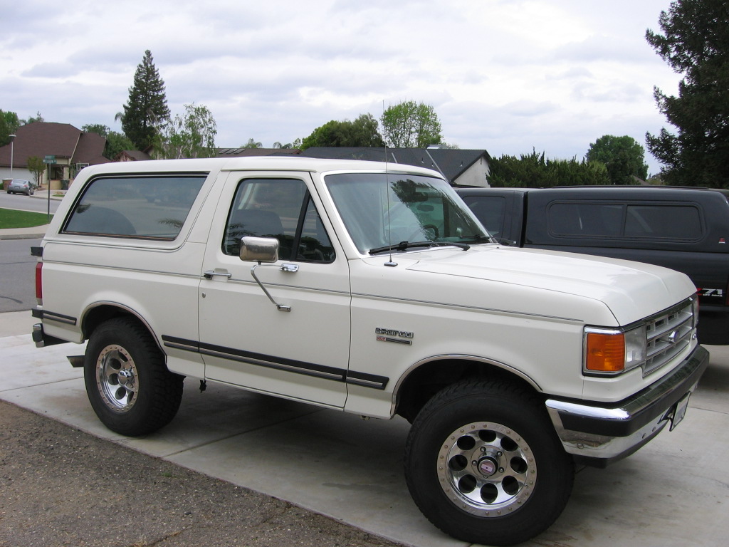

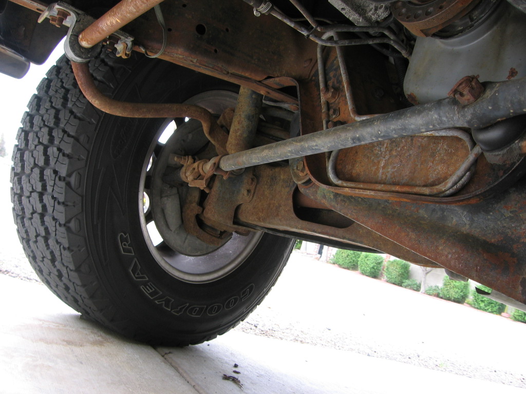

Stock 1987
Stock 1987
Stock 1987
Stock 1987
Where's Waldo
Where's Waldo
87 Pose2.JPG (28.81 KiB) Viewed 5664 times

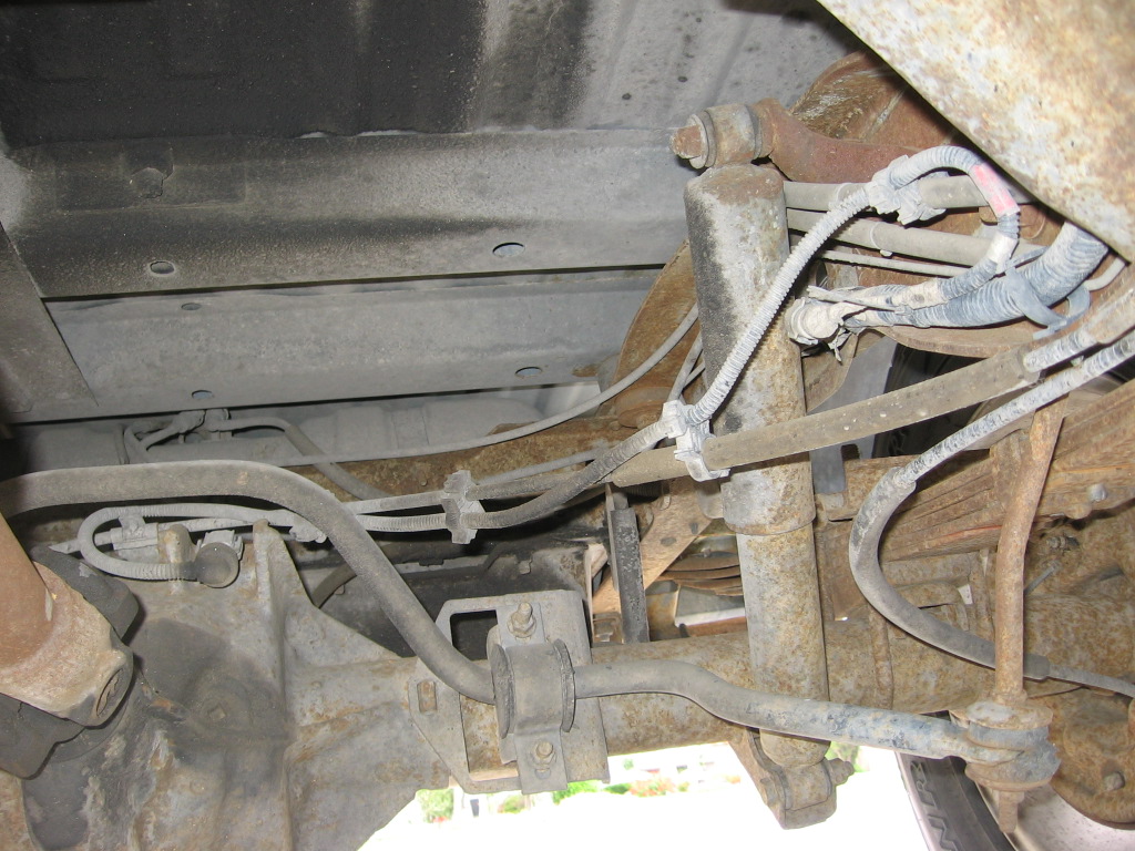

More Stock Pics............
Elwood Blues -1980

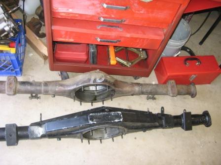

Gunnit's old 9" housing via tony/steve

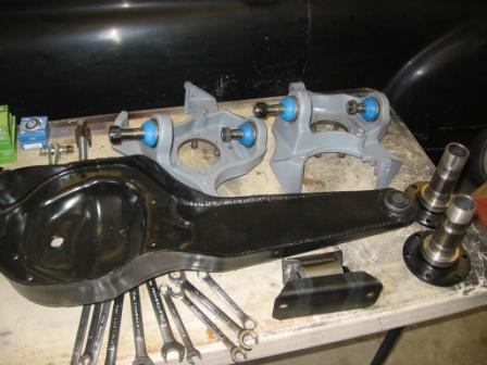

Autofab C&T plated/Knuckles/spindles

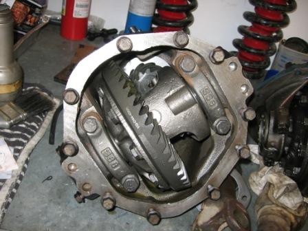

D44 pumpkin..1982 bolt in style w/4:56's-Kritters old springs and inserts

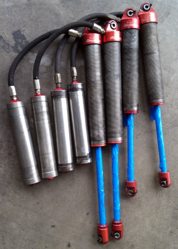

Cleaned, sealed, valved and ready to roll.
Bondobob shocks.jpg (218.72 KiB) Viewed 5498 times
