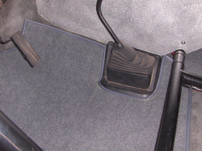

carpet shock enclosures.jpg (140.32 KiB) Viewed 4016 times

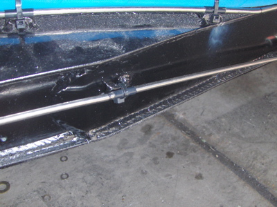

brake line mounts.jpg (72.06 KiB) Viewed 4016 times

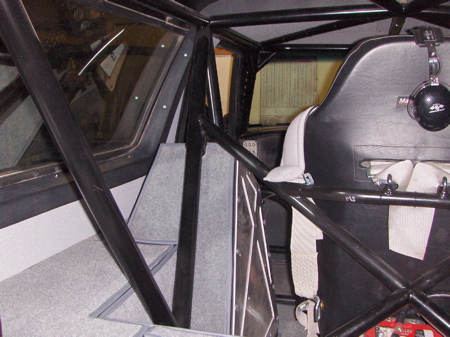

behind dash.jpg (99.73 KiB) Viewed 4016 times

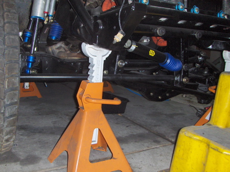

front sus4.jpg (105.31 KiB) Viewed 4004 times

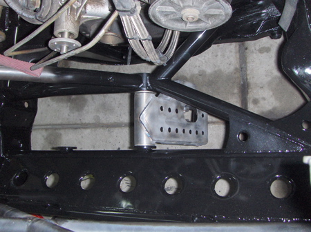

front sus10.jpg (129.34 KiB) Viewed 4004 times

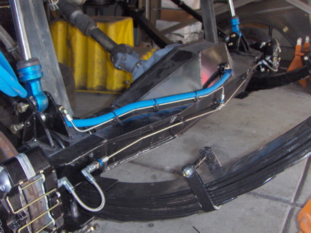

ryan B
Posts: 90
Bronco Info: prerunner
Re: Ryan's 91
Post by ryan B »

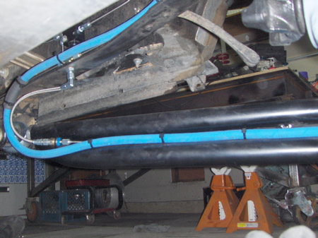

philofab wrote:Holy crap that is nice!
Are you running a two link above your 64 kit?

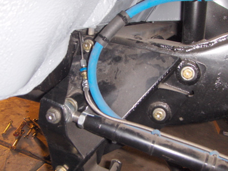

Yes sir. I cracked two lower u joints on my rear driveline when i first drove it, and was inspired by autofab's 2 link. I thought why can't it work with a spring under. It does! No driveline issues now. I also ran my brake line/rear diff vent down the driverside arm.
