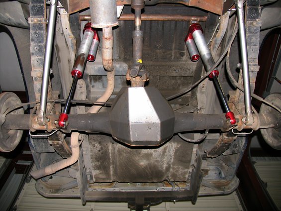

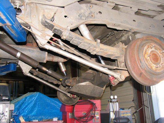

Rear
  • Long travel leaf springs-Autofab
    read differential (9") skid plate-Autofab
    2-link kit-Autofab
    2.5"x12" Swayaway shocks-used
The Fox Shocks were actually purchased for another project that I ended up scrapping prior to building up the Bronco. The Swayaways were used in the rear because they're collapsed length (19.05") allows you to keep them under the floor while still using the stock lower mount.

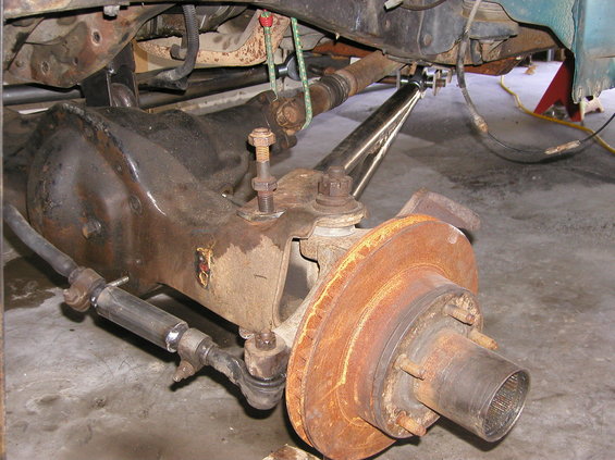

I originally installed the front end with the stock quad-shock coil-buckets and mounted one shock in front of the coil. I welded a temporary tab onto the front of the axle-housing for this.
I don't have a very good picture of this, you get the idea....
I ended up driving the truck like this for a few weeks. I didn't take it off-road, but it had great road-manners. I drove it from the Central Coast to Southern California a couple times and was very happy with the ride and handling.

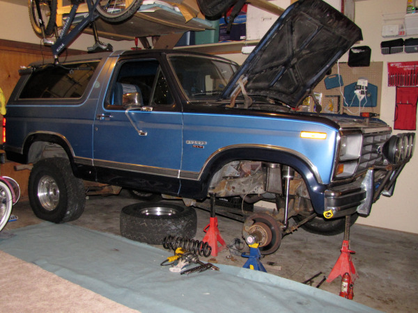

First quarter update, 2010.
The Bronco has moved less than 2 miles in the last six months. Not much more in the last year. I have started it periodically to let it warm up and run the A/C, though.
On to the good stuff. The less than two miles got it home so I can work on it when I want and not have to worry about freeing up the shop for paying customers.
Brian is making me look bad, so I to I had to get to work! The goal for tonight was to get the Bronco IN the garage instead of in front of it. I picked up some momentum and even got a wheel, coil and coil-bucket off of it... DANG! I even Vise-Gripped the new coil-bucket and hung a shock on it! KABLAM!
That's enough for now. See you next quarter!
