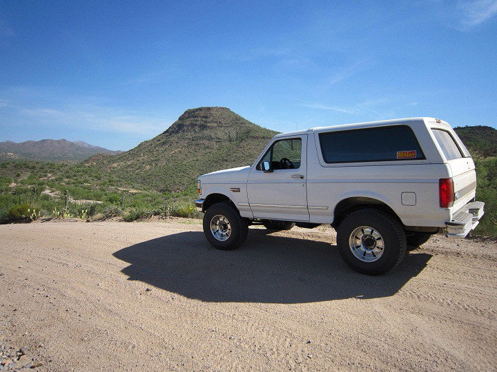

Im the new owner of this 96' and bought it as is. I will be adding my own finishing touches and will update this thread along the way.
147k miles
5.8L V-8 with Edelbrock power package (aluminum heads, upper and lower intake, headers)
Ford Motorsport E303 camshaft
New timing chain and steel timing gears
Crane gold roller rockers
Aeromotive Adjustable fuel pressure regulator
Bassani Y pipe w/hi flow cat
Magnaflow 3" SS cat back
E4OD with Mag Hytec transmission pan
B&M trans cooler with e-fan
Curt LeDuc VSS relocation kit
1350 CV to 1410 U-joint rear driveshaft
Autofab Cut and turned beams and coil bucket kit
2.5 inch SAW's
Dana 50 differential (9-inch ring gear) with 4.88 gears and an Ected limited-slip/locker, 12 1/2-inch disc brakes
All new bearing, spindles, U-joints, and seals
Warn locking hubs
14-bolt full-floating 10 1/2-inch ring gear rear axle with an ARB air locker, 4.88 gears, 1410 pinion yoke, 12 1/2-inch disc brakes
Autofab 2 link
Sway-a-way 2.5 inch shocks
Camburg rear shackles
Deaver J40 rear springs
315/70R17 Goodyear A/T Extreme tires
17x9-inch APP forged aluminum wheels
Pioneer deck
Polk audio 6.5's (all 4 speakers)
Polk audio 10" sub
JBL 300w amp
Clear headlights and corners
HID's
147k miles
2.5 inch SAW's
Warn locking hubs
Autofab 2 link
Pioneer deck
Polk audio 10" sub
JBL 300w amp
HID's
- 45030_1525512971602_1047973827_1485270_1071980_n.jpg (116.09 KiB) Viewed 14700 times
- 44530_1525508691495_1047973827_1485224_5986459_n.jpg (147.05 KiB) Viewed 14700 times

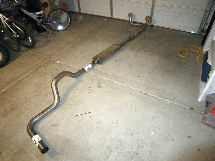

Bassani Y pipe with cat, 24" magnaflow muffler, magnaflow 3" tailpipe. 3 new O2 sensors will go in also. Cant wait to hear it!!
- full exhaust

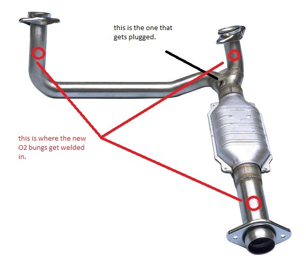

So the 96's have 3 O2 Sensors? And a MAF? Do they have more HP then the older model EFI 351's with all the engine management that they have?
- RyanDS650X
- Posts: 1868
- Location: Mesa, AZ
Re: Ryan's '96
http://www.autoanything.com/exhausts-mu ... kc=ffskupoAndy Jones wrote:Where did you pick up the y pipe at?
They dont make the one for the 96's anymore so you have to weld in 3 new O2 bungs and plug the one that comes with it.

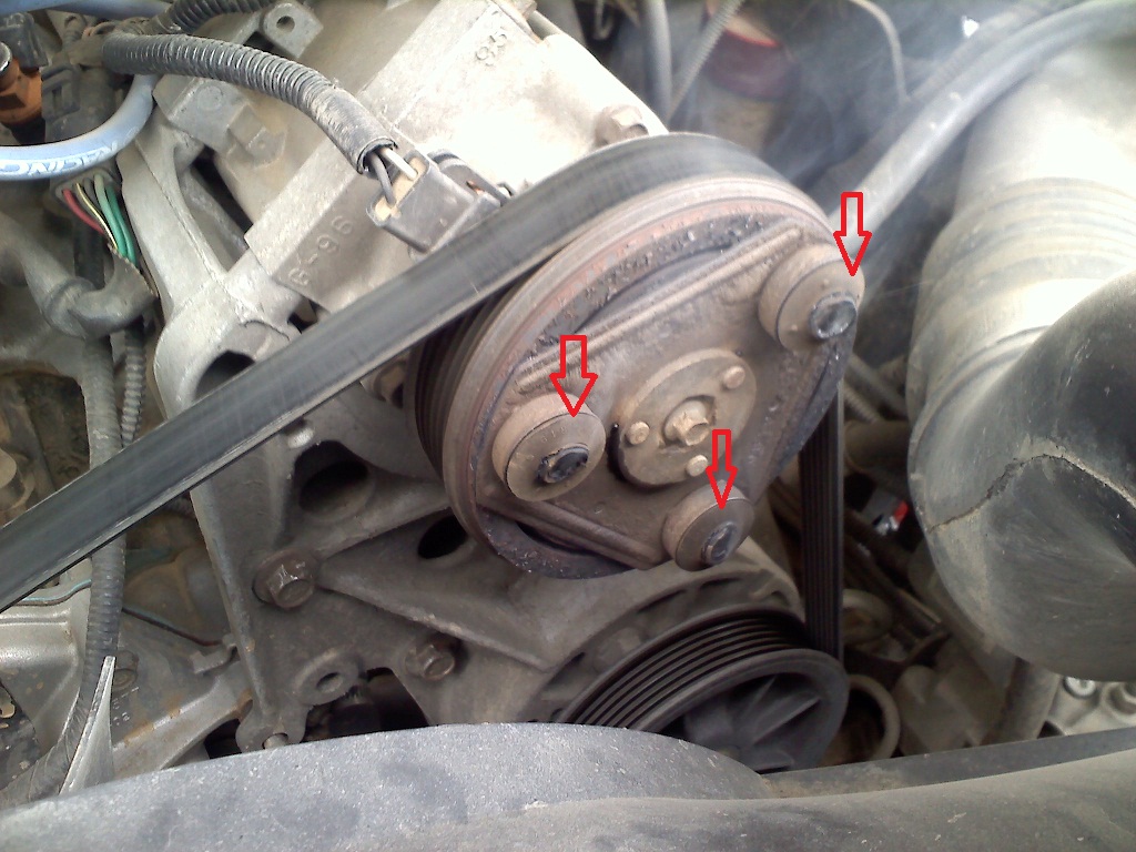

The bronco goes to the shop some time next week for a few finishing touches and some maintence. Wiring the compressor for the rear locker, installing the punisher valve body and trans cooler,installing the new drag link, rear diff service, deaver coils and limit straps front and rear.
Now my brother tells me the ac compressor might have taken a shit. He says the 3 bolts on the pulley for the compressor were smoking when he took the bronco to get registered, it lasted a few minutes then went away... Anyone else ever heard of this? He sent me a few pics, ill attach them when im off work.

He said the smoke was coming from these beneth the red arrows, any ideas??

Anyone ever seen or heard of this happening?? Seems pretty odd.

I imagine the compressor is locked up. It smoked the A/C clutch. Either that or the electro magnet is going to crap and smoked just the a/c clutch (not likely).
