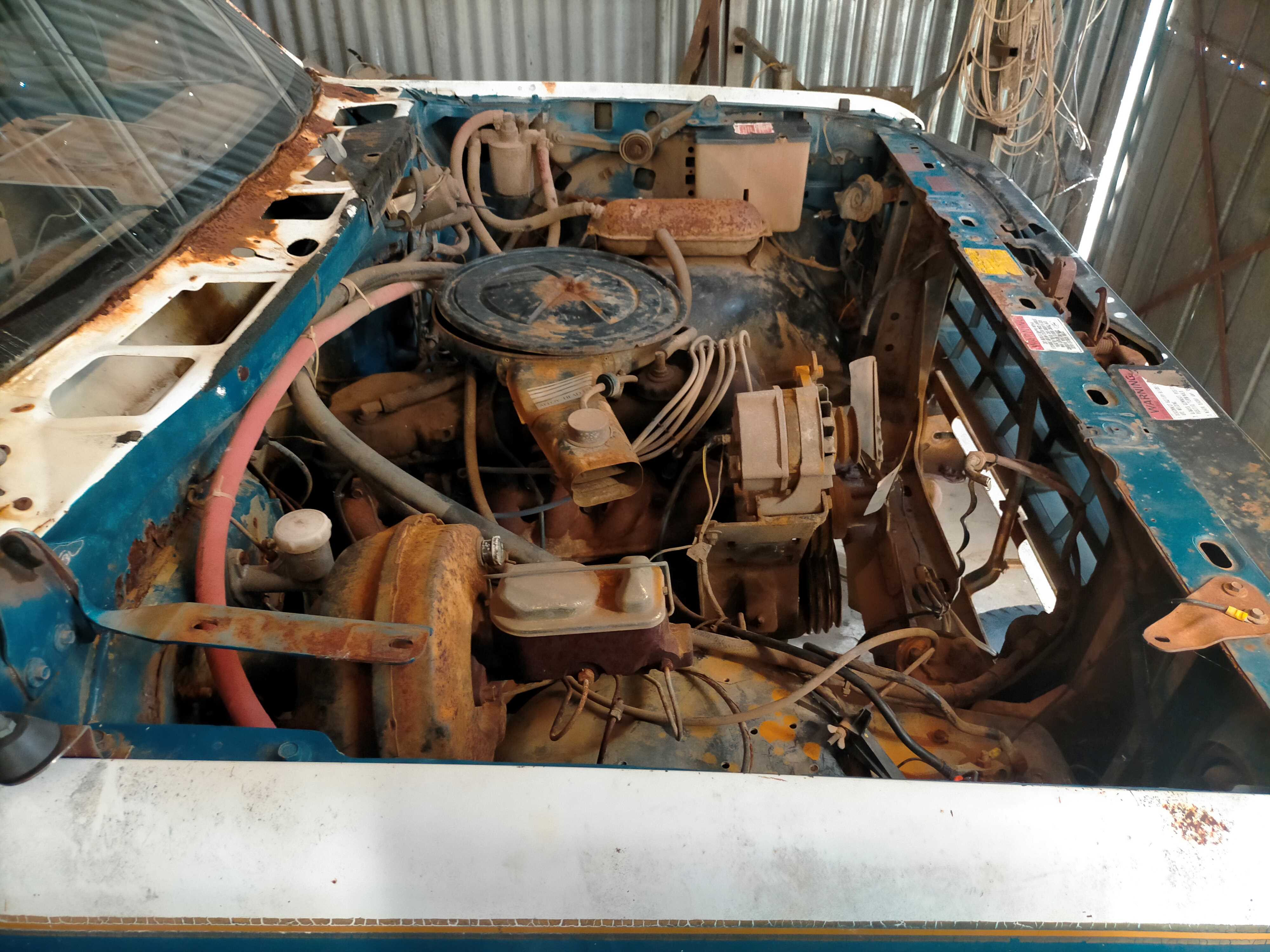

Yes, I bought a Bronco. It is in POOR condition, but I believe it is saveable and it has almost all the parts that are necessary to get it running again. It's an '81 or '82 model, 6 cylinder alloy head 250 c.i. six, NP435 4 speed, 4.11:1 rear 9" with the braced housing, 4.09:1 front with bolt-in third, the power steering box is still there (pump and brackets aren't), no steering column or connector shaft, driver's seat is missing, along with the radiator and shroud (have those from the F truck). It needs a LOT of work, however I believe the body is in better condition than Mick's Bronco, so I have a good starting point.

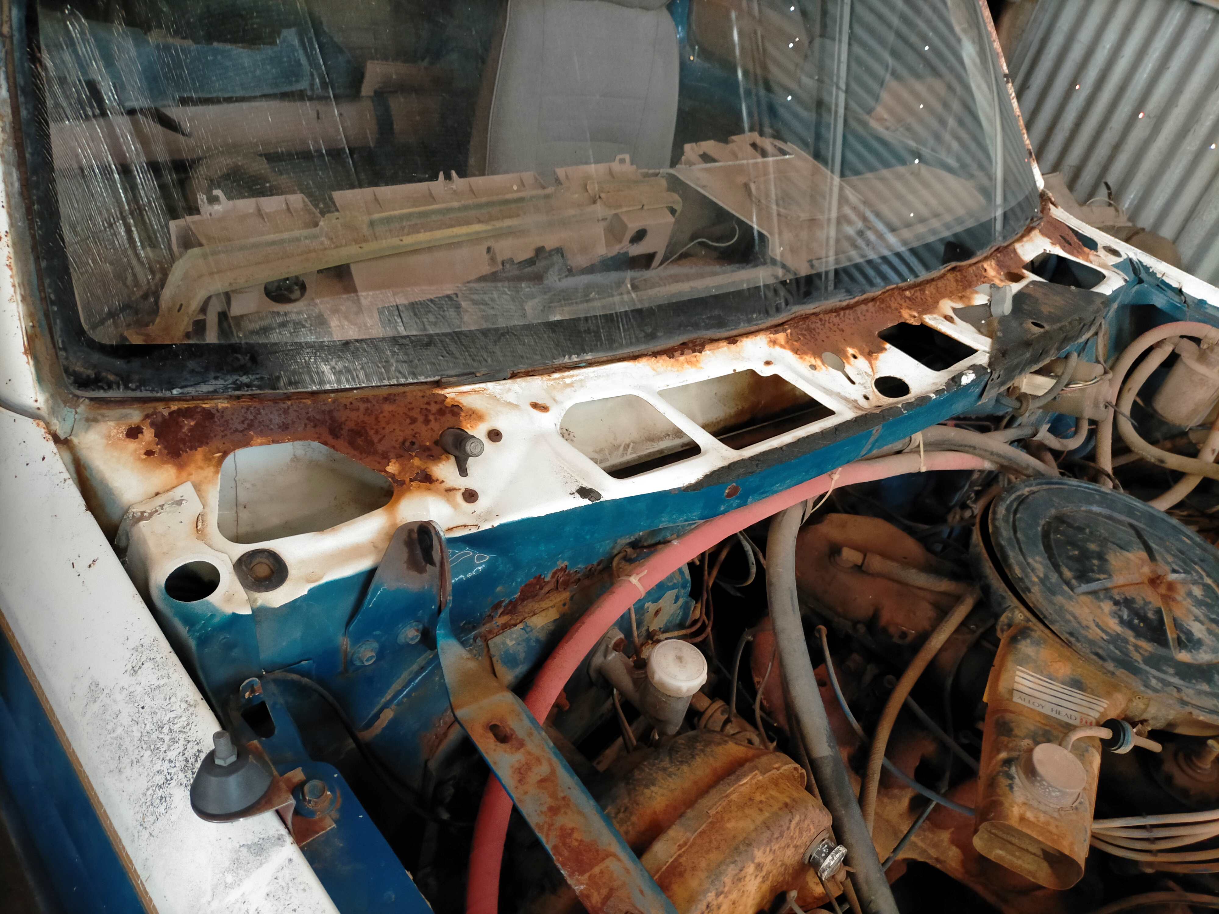

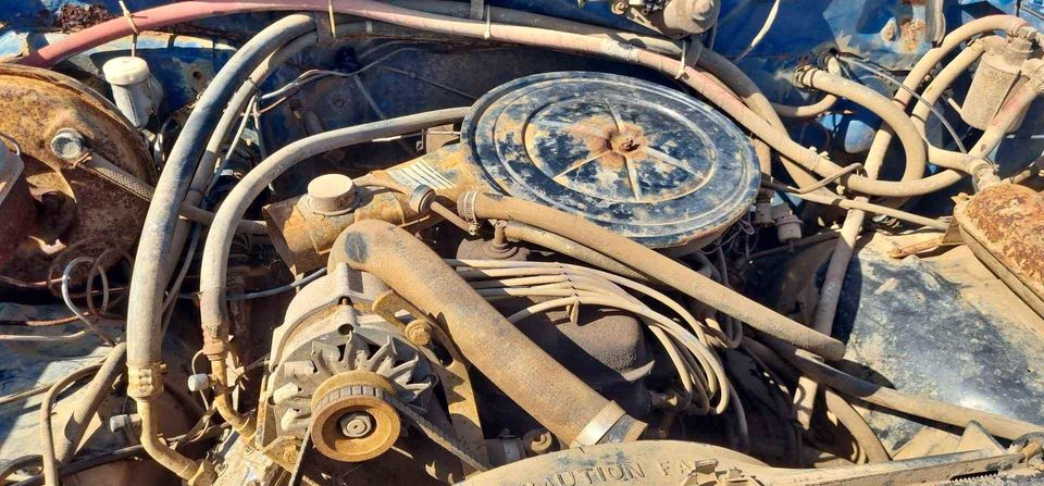

It has the usual rust for Australian Broncos, in the cowl, upper firewall, etc but nothing I see is unrepairable. More pics:

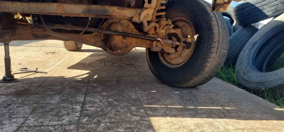

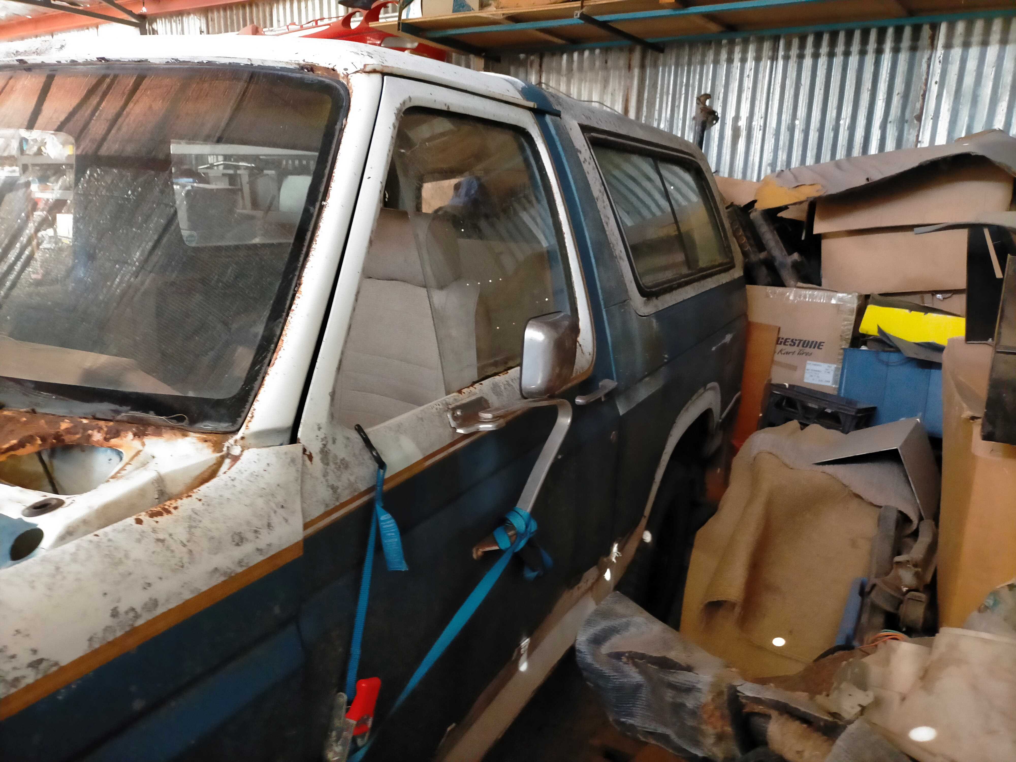

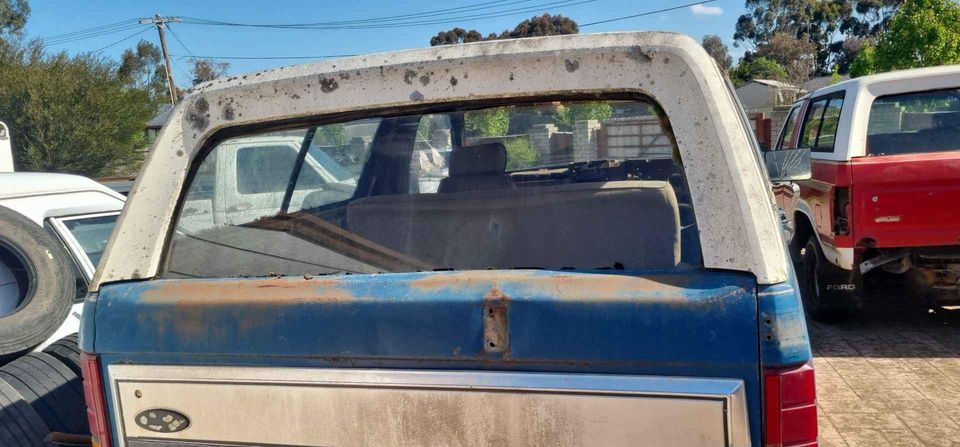

Some of the pics are from FB Marketplace, prior to me getting there. He sold a few things off it before I could confirm and pay for it, but I have the foundations of a project, and I am chasing up a steering column and shaft, power steer lines, and other stuff I need to make it run. Once it runs, I'll strip the cab to a bare shell, evaluate it, then pull it off the chassis , make a dedicated wheeled dolly for it and get it sandblasted back for the repairs it needs. The rolling chassis will go up the yard under a tarp until I have the body in white, then it will get some love and be reunited with the cab. I'll think about it more closer to Xmas, as I have the F100 to get finished first.

Hell of a project. Respect. Didn't know rust was that bad down there. As an ignorant American I assumed more desert climate v. coastal living. Brake booster on the wrong side too.

Nah,the rust is mostly only surface rust, from being left exposed to our shitty weather. I'd have to move north west to be in desert climate (thinking of doing that soon, maybe). Booster is on the correct side for Arse-tralia.
