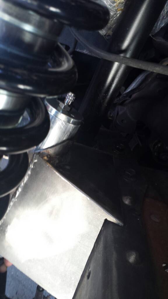

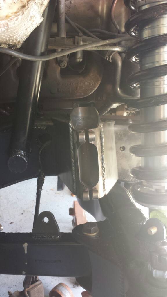

Hey thanks guys. Looks like I'll be heading down to Henderson this weekend for his celebration of life. Didn't get anything done on the bronco over the weekend, the wife had me doing home improvement projects. Today I started on the bump stops. Not sure if I like em.

Post by fomoco51 »
Opinions? It just seems massive.
Re: "project orange juice"
I just thought of something... Take the the radius arm bolt turn it upside down and make a screw on bump pad. I could make them for you if you told me the thread and diameter of that bolt but what I just pictured in my old noggin was a piece of round stock drilled and bottom tapped the same as what's exsisting. You would still maintain the bolt and nut this would thread on above the nut on whatever remaining thread is left.
Massive is fine as long as its strong. That thing is your last line of defense defore stuff breaks so strong is good and massive is acceptable if that's what it takes to bump on something solid.
