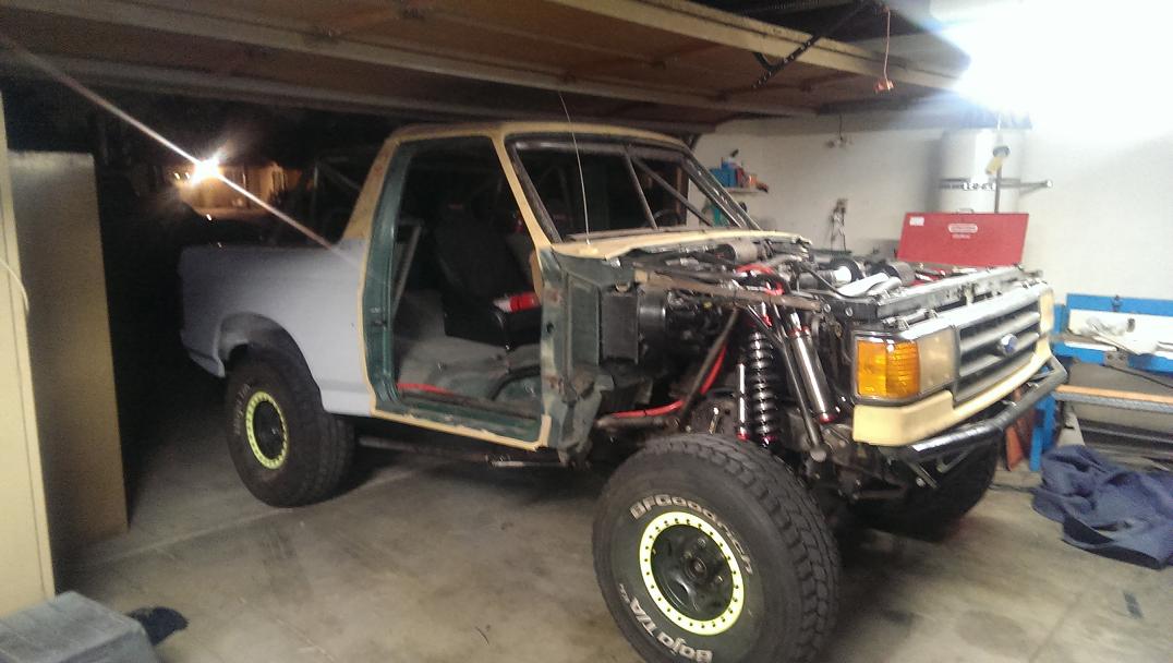

I will add something about the tin work. It helps that Mike was so detail oriented during his build that the panel on one side pretty much fit the other with minor trimming once flipped..... I was impressed all those little triangle areas were so close to each other from side to side.
Re: Michael Cox's Street Queen
Signs of a well built truck.
When you can't use the template for one side on the other it makes me nervous about how square the rest of the build may be & how much dog tracking/walking the thing will do in the dirt.
Yes. I am doing a jig for the ttb housings and radious arms like Glen from Complete Fabrication has made for Chris Wilson's race Bronco. Glen tig welded my uniball cups on my housings. Also if I ever bend or break a housing I can make a replacement.
Last of the pics..... the first pic is how he was driving it the night it got done. :D

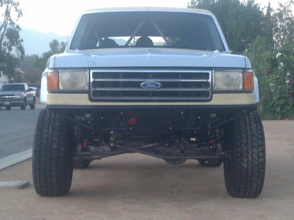

Super hawt!! That front picture looks incredible.
otter
Posts: 534
Location: Hawaii
Post by otter »
I love the fact that you didn't update the glass. This is one sexy Bronco! How long are the lower links on this thing?

otter wrote:I love the fact that you didn't update the glass. This is one sexy Bronco! How long are the lower links on this thing?
If memory serves me right they are 54.5"
