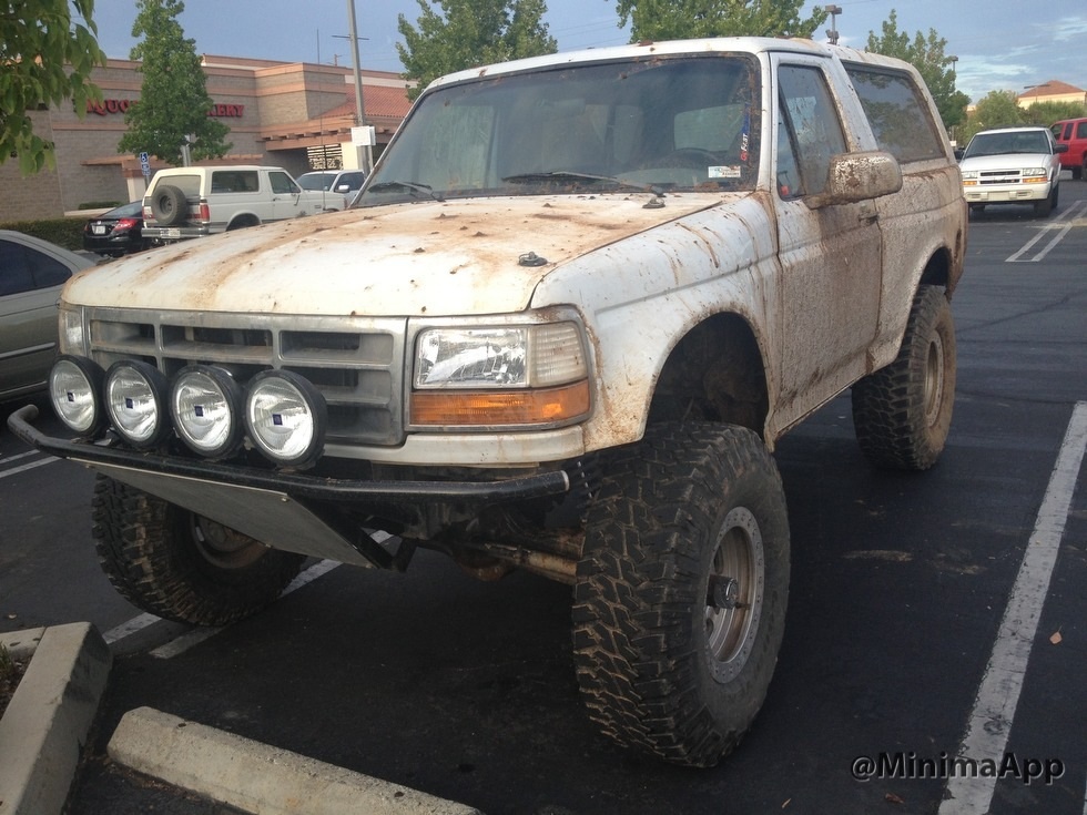

Proof that SoCal gets rain once in a while, took a short cut that turned drift fest between guide wires and high tension poles. On the wet clay it was like driving on ice, sideways pinned in 3rd gear drifting 25mph sliding for days. I started getting a little nervous in the super squishy sections. I really didn't want to get stuck.
Re: RMC's el hefe build.
I drove back n forth through a big deep puddle after so I could help the wipers with the big chunks.
