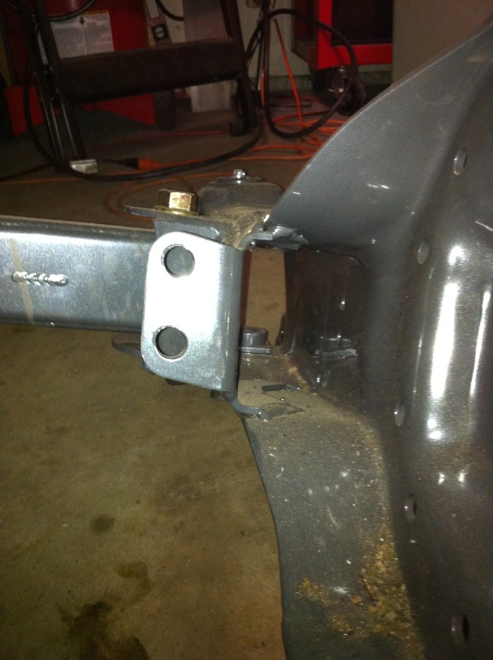

Looks good. You can make a single coil-over and bump work pretty damn well.

Only reason i haven't welded more is cause my wife is on a conference call and i need someone to hold the upper mounts ha ha :D i buzzed the tacks and repositioned just a few hairs so the bottom of upper mounts are level with top of the lower mounts through cycle.
Thought it was close but didnt want shock to tilt and rely on misaligns or have the cap sway towards front mount at bump... So i got ultra critical and buzzed it eventhough it probably woulda been fine. Man i annoy myself! Ha ha
Better to spend a little more time now to get it RIGHT than a bunch more time later trying to fix it if it is wrong.

the build looks awesome... and maybe I just haven't noticed on the other radius arms,,, but those mount inside the beam? 2wd?

That's cool how those arms mount up... it looks so clean.
I'm right there with you on that sleep pattern deal. Cant seem seem to fall alseep when I want, or stay awake when I need to.
...Thanks for posting those pics, I'd never thought about that as an option.
