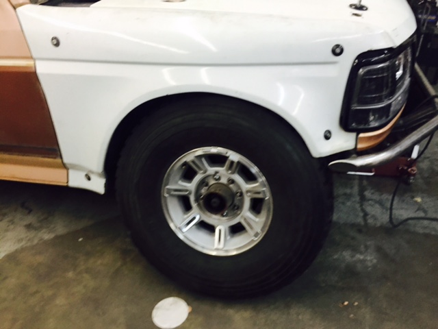

oh and your worried about being too wide, just cheat and run stock off set hummer 2 wheels.........yes

front with 5.5 over and 37.....note the hummer wheels fix a lot

- Posts: 2912
Nice! Autofab rears should work great with the hummer wheels!!

Looking awesome.
You will like how it drives with Hummer wheels... seems to make steering, balljoints, and bearings last longer.

philofab wrote:You will like how it drives with Hummer wheels... seems to make steering, balljoints, and bearings last longer.
very good to know Philo Thanks man!

so I looked up why this would be and it seems this is due to the KPI or king pin inclination....look at Philo teaching me stuff...philofab wrote:You will like how it drives with Hummer wheels... seems to make steering, balljoints, and bearings last longer.

Yeah I have a set of forged dodge wheels that I am debating running. But I also have a set of methods in the box waiting to go on my Dana 50ttb hybrid setup as well. I believe I am gonna run the dodge wheels for a while and see how I like it. And go from there. I got the methods cheap enough at swap meet to make a decent profit selling them off here in norcalfuninthesun95 wrote:so I looked up why this would be and it seems this is due to the KPI or king pin inclination....look at Philo teaching me stuff...philofab wrote:You will like how it drives with Hummer wheels... seems to make steering, balljoints, and bearings last longer.

Thanks to Philo.... I can show one reason why this bronco ended up with the TTB 50 outer
