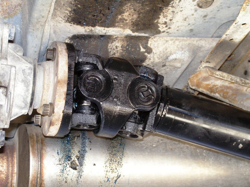

So...not sure if it was the missing wedge, but the additional lift really brought out the gremlins in the rear drive shaft. There were a LOT of drive-line noise issues, and the vibration and shuddering from the entire rear drive-line was driving me nuts.
So...as I mentioned above, I took the Bronco it to the local custom drive shaft shop here in south Salt lake City (Lehi, UT actually) that caters to Jeepers, Moab crawlers, and 4x4's in general. I had them upgrade the entire rear drive shaft to fully rebuilt and rebalanced condition...with new greasable Spicer 1350 u-joints in the double cardan, and a greasable Spicer 1410 u-joint just in front of the diff.
They also installed a Zerk fitting to allow me to grease the telescoping section of the drive shaft, and sealed the telescoping portion with a new seal.
They also said I did not need a spring wedge...unless I experienced further vibration issues. Which I currently do not. If I do, he said to bring it back and he will install a ~ 3-degree wedge. The shop also said that the drive shaft is equivalent to what a Powerstroke diesel has...not sure really about that...but regardless, it's pretty stout for a Bronco.
See pics...

Very nice bronco, I have enjoyed watching this thread. Any updates? Did the new driveshaft fix your problems?

Brad12...thanks for the comments. Actually, the new drive shaft did a LOT to address the vibration and noise from the rear end. I still sense a small amount of minor vibration (especially on the highway,) but I will deal with it.Brad12 wrote:Very nice bronco, I have enjoyed watching this thread. Any updates? Did the new drive shaft fix your problems?

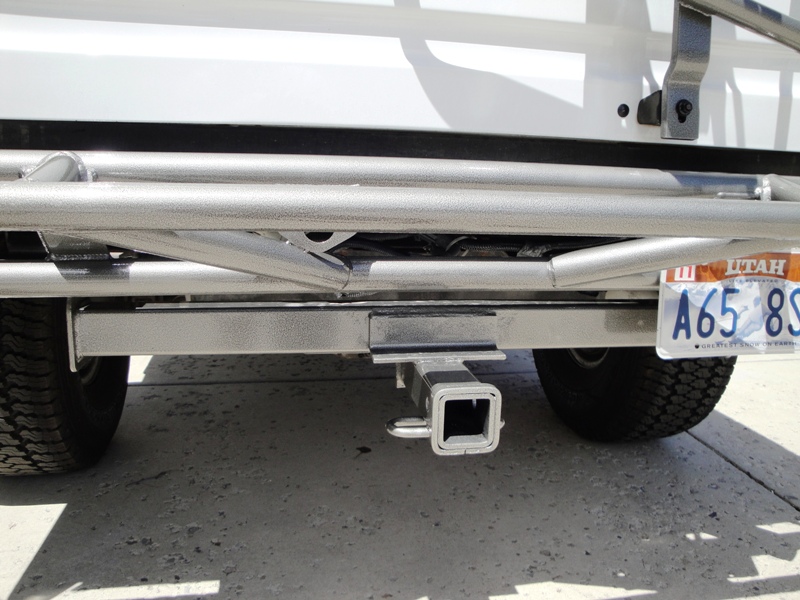

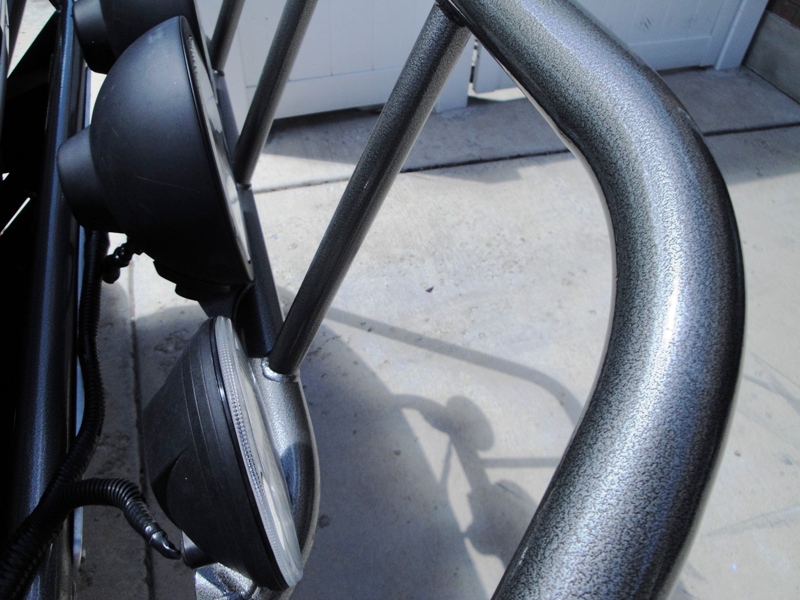

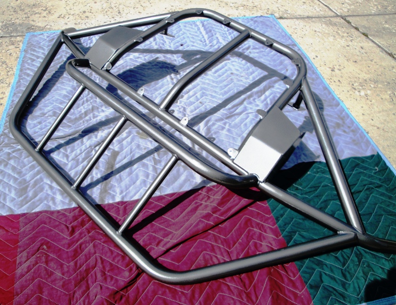

July 2010 Update 2 - Powdercoating Complete!
Got the rusty F&R custom fab'd bumpers, OEM spare tire carrier, and aftermarket receiver hitch all removed, sand-blasted and powder coated at the end of June. Got them all back on (a lot harder to bolt back on than it was to take them off!) back on July 2...just before a week of family vacation in Florida.
The powder coat was performed my a local SLC shop that I've patronized before, and I selected "Silver Vein" as the color. It is a textured 'hammertone' silver and black finish that also has a second clear coat applied.
All 7 pieces sandblasted and coated (silver vein and clear gloss) cost me $373.97.
Pics attached...
The monster F prerunner bumper after a little wax application:
All 7 pieces laid out after a little Meguiar's Carnauba wax treatment... Close-up of the F bumper showing the detail of the hammertone finish R bumper close-up...
Pics attached...

July 2010 Update 2 - Powdercoating Complete! (II)
A couple of final shots...

That looks great. Very good choice on the "silver vein" in my opinion. The only thing we need now is some video of that beauty in action!

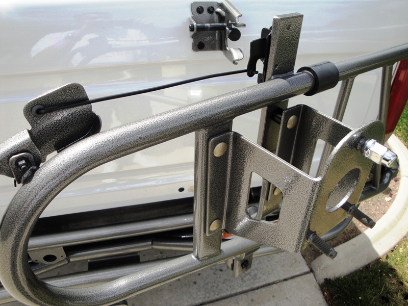

Nice looking powdercoating. Thought I might give you a friendly heads up to be very careful with your spare tire mount. Mounting to bed corner and tailgate is not the strngest when flogging it in the dirt especially with larger tire/wheel. Have seen latches tear out of tailgates, so might want to make sure there's a good steel mounting plate inside tailgate. Many abandon that mount setup and build them into a custom bumper, but understand that can cost a bunch and typical prerun rear bumper can't handle the load. Keep an eye on it in any case and nice rig! Sorry for the hijack, but hope it helps.

Broncodawg...appreciate the comment and suggestion! My fabricators said virtually the same thing when I told them to bolt it all back together. When I made that decision to keep the stock set-up, they immediately began planning some future mods that would:Broncodawg wrote:Nice looking powdercoating. Thought I might give you a friendly heads up to be very careful with your spare tire mount. Mounting to bed corner and tailgate is not the strngest when flogging it in the dirt especially with larger tire/wheel. Have seen latches tear out of tailgates, so might want to make sure there's a good steel mounting plate inside tailgate. Many abandon that mount setup and build them into a custom bumper, but understand that can cost a bunch and typical prerun rear bumper can't handle the load. Keep an eye on it in any case and nice rig! Sorry for the hijack, but hope it helps.
- Support the locking mechanism (where it connects to the tailgate,) with an internal plate (as you suggested,)
- Cross-brace the existing swing arms to hold the weight, and...
- Add an additional vertical brace that would transfer the load bearing duties (from the locking mechanism area) down to the lower tubular bumper
So, in the mean time, I'll pray that what I have doesn't break (heck, I don't even have a 35" spare tire yet!,) and budget your suggestion for a Fall 2010 mini-project.

I've been running around in the desert with my stock tire carrier and 35s. It bounces around a little bit, but I haven't had any problems. Granted, the previous over backed into something with the spare tire and did a number on the tailgate so I'm not really worried about it, but still. I can't build something to support the tire from the bumper or else the tailgate would hit it when opened.denhabr wrote:Broncodawg...appreciate the comment and suggestion! My fabricators said virtually the same thing when I told them to bolt it all back together. When I made that decision to keep the stock set-up, they immediately began planning some future mods that would:Broncodawg wrote:Nice looking powdercoating. Thought I might give you a friendly heads up to be very careful with your spare tire mount. Mounting to bed corner and tailgate is not the strngest when flogging it in the dirt especially with larger tire/wheel. Have seen latches tear out of tailgates, so might want to make sure there's a good steel mounting plate inside tailgate. Many abandon that mount setup and build them into a custom bumper, but understand that can cost a bunch and typical prerun rear bumper can't handle the load. Keep an eye on it in any case and nice rig! Sorry for the hijack, but hope it helps.
I can' imagine the damage that could occur with a 35x12.50-15 mounted on a stock carrier! Ouch.

X2. I had many baja miles, and several hucks on the stock carrier, with a 35, and never had a problem. That's not to say it will never happen.Phoenix0783 wrote:I've been running around in the desert with my stock tire carrier and 35s. It bounces around a little bit, but I haven't had any problems. Granted, the previous over backed into something with the spare tire and did a number on the tailgate so I'm not really worried about it, but still. I can't build something to support the tire from the bumper or else the tailgate would hit it when opened.denhabr wrote:Broncodawg...appreciate the comment and suggestion! My fabricators said virtually the same thing when I told them to bolt it all back together. When I made that decision to keep the stock set-up, they immediately began planning some future mods that would:Broncodawg wrote:Nice looking powdercoating. Thought I might give you a friendly heads up to be very careful with your spare tire mount. Mounting to bed corner and tailgate is not the strngest when flogging it in the dirt especially with larger tire/wheel. Have seen latches tear out of tailgates, so might want to make sure there's a good steel mounting plate inside tailgate. Many abandon that mount setup and build them into a custom bumper, but understand that can cost a bunch and typical prerun rear bumper can't handle the load. Keep an eye on it in any case and nice rig! Sorry for the hijack, but hope it helps.
