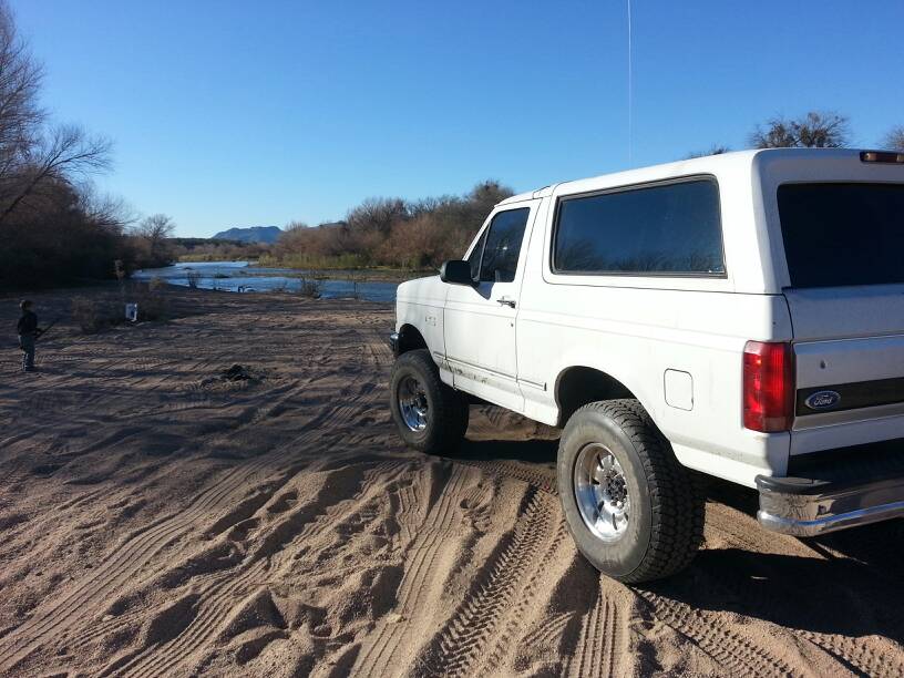

Ran out for a quick shake down thismorning and man am i impressed! Throttle response, shift points, over all power to the ground is a dramatic difference. Deaver coils and new lower spring plates did awesome as well, i missed these things! Bronco did great today, ill get an alignment this week sometime and get preped for KOH!

Re: Ryan's '96
Sounds like a better deal than going LS whatever and 4l80, huh? (and cheaper)
