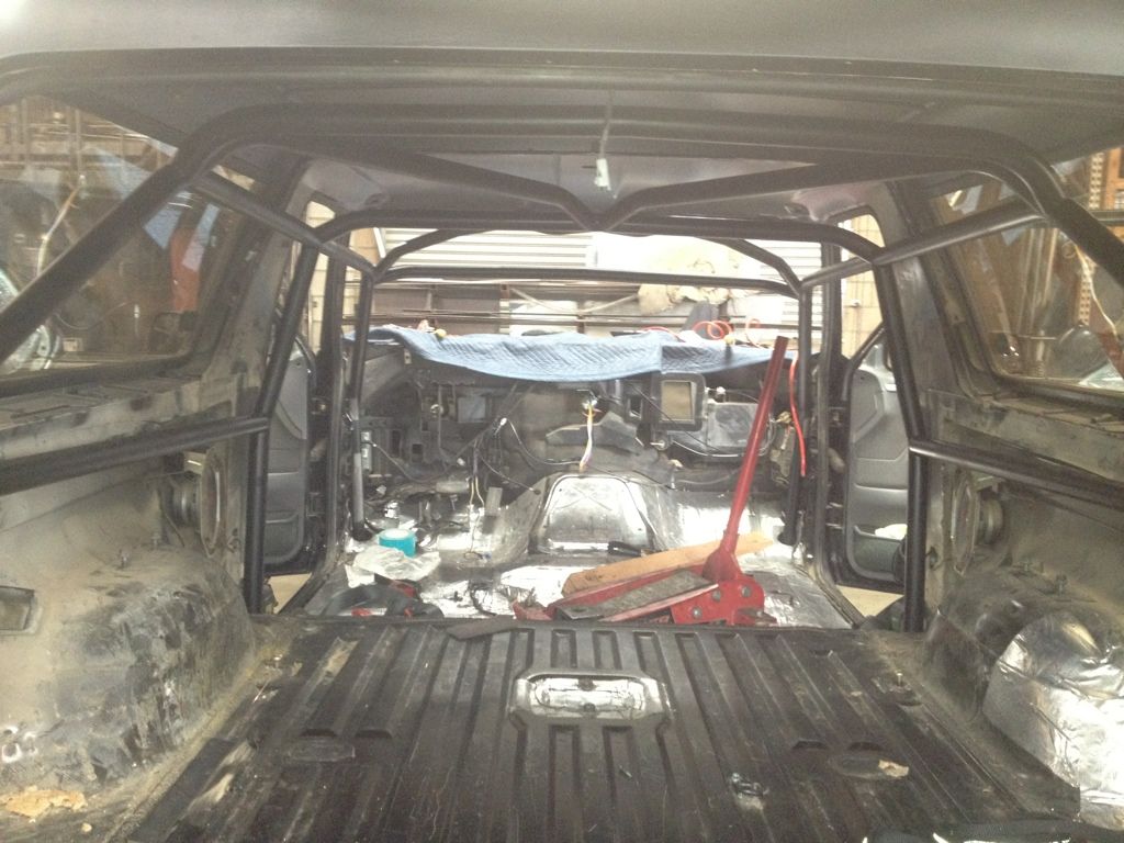

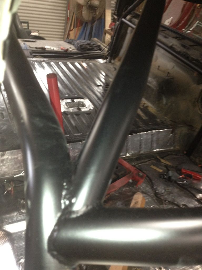

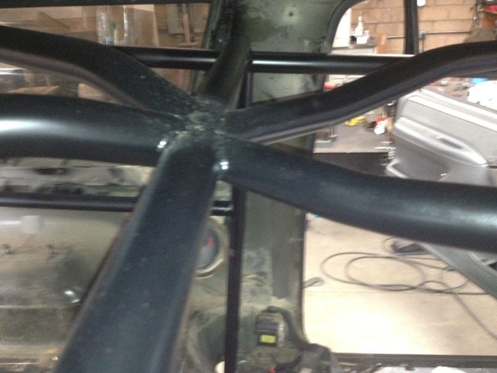

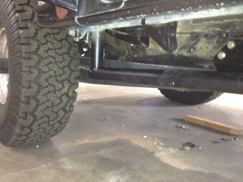

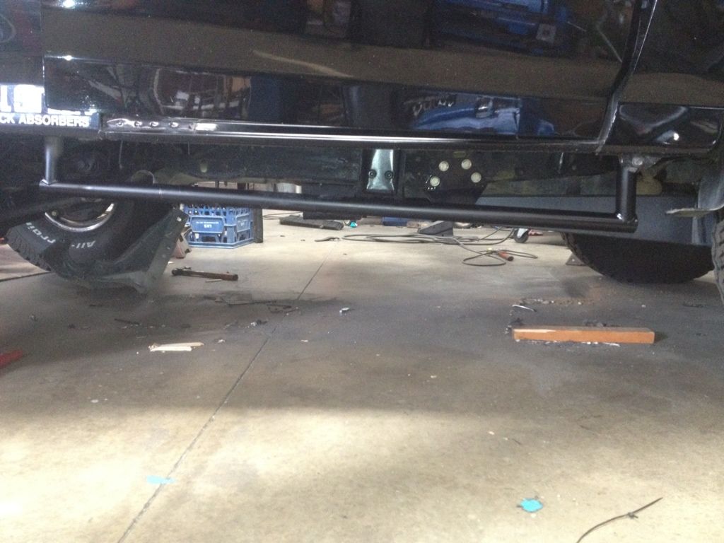

Updated pics:

Just curious, but why didn't you go with an "A" bar across the front windshield?
Integrity, Money, Relevance
1amD1cker1@gmail.com
Re: Tonys 93 bronco
D1cker1 wrote:Just curious, but why didn't you go with an "A" bar across the front windshield?
Hey Tony,
I didn't do a dash bar, and I'm trying to keep it as low key as possible while still being safe, so A was not an option.

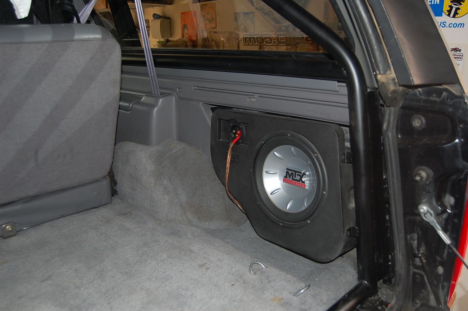

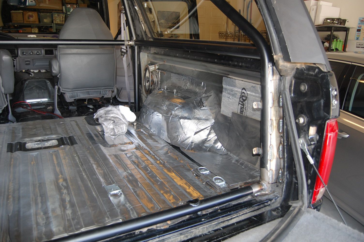

Tony, looking awesome! Question - how/where are you tying in the back the legs to the frame?
Re: Tonys 93 bronco
sydude wrote:Tony, looking awesome! Question - how/where are you tying in the back the legs to the frame?
Thanks!! The back legs are plated body, and then there will be a bar that is lying flat on the ground, that ties into the two most rear body mounts.....
Here is a picture of how we did it on my brothers:
Thanks, that's one my two options - the other is to have the legs extend through the bed and the square body cross-member, and then tie into the rear bumper system. Definitely much more work than your way, and I don't think that method's results are any better.
It looks like it does in your picture, but do the body mount bolts go through the tube that ties the legs together?
Re: Tonys 93 bronco
sydude wrote:
Yes, the bolts go through that tube.
