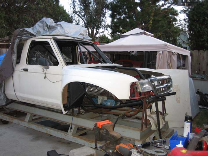

Ranger build was on dertrides eons ago. It left the stage you see above in about 2002 & went down to this. Funny thing is it started under the knife for a cage (needed it with the power plant!) & equal length beams. That snowballed to a 4-link and then a-arms up front, blah, blah, blah
12-x-02 Cab on Jig.jpg (178.13 KiB) Viewed 24861 times
12-x-02 Cab on Jig2.jpg (91.25 KiB) Viewed 24861 times
Sadly it has never come back (like everything else I own - see my signature...)
Work was solid in '03 & '04, then backed WAY off in '05 & '06. Perked back up in '07 & '08 a bit but only got as far as below = lots of work done, but no where near done. '08 was the last time i touched it. I moved on to the crew and it got left in the dust. I wanted to build something a little less "race" and prep intensive so as to be more realistic & my buddy who taught me to fab & helped me build it was going to buy it. It's in his shop still on the frame jig, but he like me has a family & too much going on, so he hasn't touched it & it needs to go. It'll be listed as soon as I can sack up to the loss I will take, cut emotional ties & let go. Wife is pushing but I've been dragging my feet.
Oh yeah, 3.8L SC was sold about a year after it came apart, and a 302 went in it's place. Plant was to have a 351w in it when said & done.

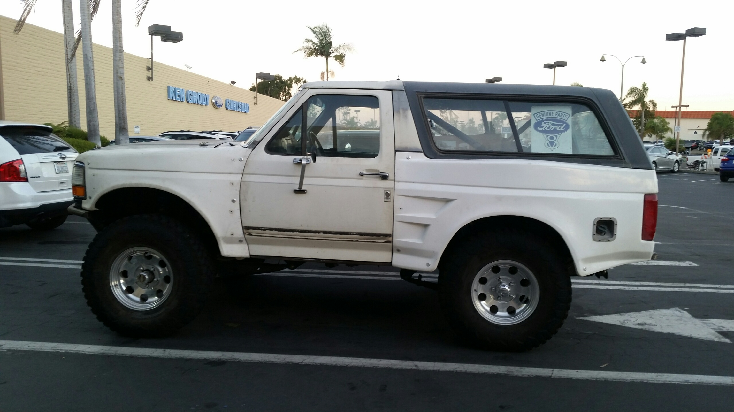

Back in CA for my sisters wedding. Took the bronco out to Ocotillo Wells for a couple trips to test the radiator and cooler Haha. First trip was mild, my buddy drove out his 71' CJ-5. We went through Borrego to truck haven. That thing blows my mind with how capable it is in stock form with the simple military tires. I'm bummed I didn't get more pics. ImageImage
Second day went out with my buddy w/ his Baja. We went all over the park, great time. Aside from the buggy throttle cable slipping and the shift linkage pin falling out no issues. ImageImage
Nothing more rewarding than pulling the Bronco out after 5 months and making 2 consecutive round trips with not a single issue. Over 600mi, 200+ of them off road, I'm happy. Now to put it back in storage till the next visit homeImageImage
