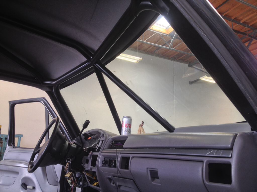

Got a bunch to tubes done today, got the cage all tacked up and slid it out the back to weld an paint. Still have to to do corner gussets and window v tubes. The cage is 2" and 1.75" fully tig welded, goes through the firewall in 4 spots, fully sealed, stock dash and stock headliner. My seats should be done in a week stoked to see it taking shape!

*Like* you gonna go into the b pillar with the b pillar down tube? Or are you gonna stay outside the plastic?

Seabass wrote:*Like* you gonna go into the b pillar with the b pillar down tube? Or are you gonna stay outside the plastic?
Going to stay outside and plate it to the sheet metal, not trying to get too crazy on this one.

Excellent work. Any shots of the firewall and the penetrations?

Thank you, i dont have any detail pics of the fire wall, all of the holes have been silicon bronzed to the tubes and painted already. My camera on my phone has been funky, but i have been cranking away and should have some updated pics soon!

Snapped some pics today, got the dash mounted (still have some finalizing to do), cage is fully painted, welded, and plated to the a pillars, and am in the process of mounting my seats.
