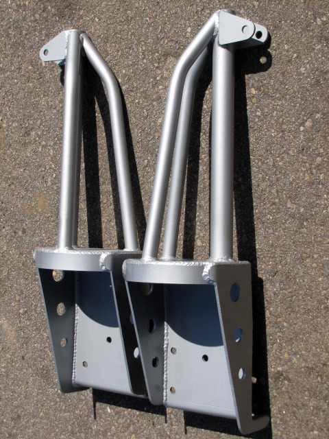

Getting closer. It's not exactly what I planned in the beginning but it'll work just fine. Originally the two support tubes were going to be straight and overlap the shock tabs adding some strength. Then I remembered how big a pain in the ass it is to taper two tubes into each other and that I would have to do that 4 times... screw that. The deviation from the original plan changed that but I can add gusseting later. For now I'm trying to make it drivable for tomorrow.
Thanks to Mike at Central Coast Prerunners for the help with the support tubes.

No plate with dimple dies??? C'mon!
Re: Steve's 84
Steve hates useless plating like that... the weak point on those is the shock tabs but they are still plenty strong. Eventually (A very long time from now) they might start cracking next to the weld.Nick wrote:No plate with dimple dies??? C'mon!
Re: Steve's 84
I'm saving the dimple dies and louvers for the body!Nick wrote:No plate with dimple dies??? C'mon!
Yeah, I hate the way they ended up. Had I known how the support tubes would end up, the tabs would have been completely different... oh well. I'll add some gussets later. I still need to add attachment points for a cross-bar.philofab wrote:the weak point on those is the shock tabs but they are still plenty strong. Eventually (A very long time from now) they might start cracking next to the weld.

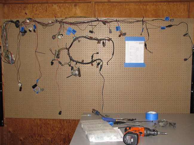

The EFI shenanigans have begun. I admit that hanging an EFI harness on the inside of your garage door is a little trashy (my wife said it looked like I was building a bomb), but this takes up no real estate in the garage and allows me to work on the harness whenever I want without having to drag it out of totes and spending an hour reorienting myself with it. I also now have the option to walk away from it without major clean up... major bonus.

SteveG wrote:y (my wife said it looked like I was building a bomb)
Hahahahahaha!! I thought you had a striking resemblance to that unibomber dude.

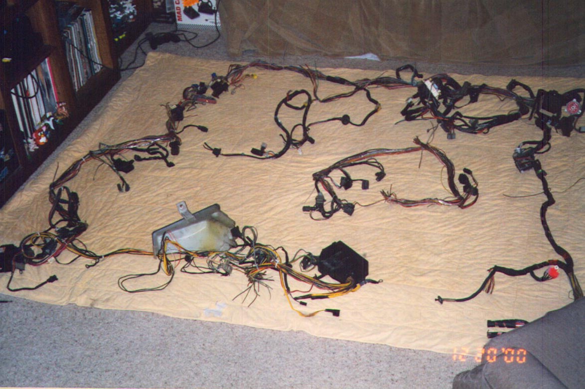

Steve - that is a cool idea for the wiring, and should serve your purpose really well.

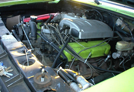

Your pic reminded me of this from when I did the ranger. I REALLY don't miss wiring...
- wringmess.jpg (151.86 KiB) Viewed 2246 times
Re: Steve's 84
There's a lot going on in that picture!ChaseTruck754 wrote:Steve - that is a cool idea for the wiring, and should serve your purpose really well.
I'm cautiously optimistic. So far things are going well with this harness. Many moons ago I put an EFI 5.0L in a Ranger and it was a ginormous pain in the ass. It's going much smoother and faster now that I have slightly more patience and a lot more information. Info was not quite as easy to come across 12 plus years ago.

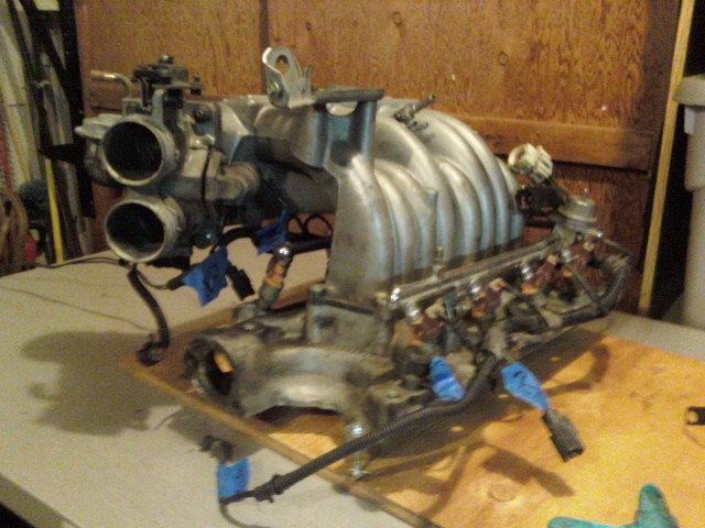

More progress on the wiring front. The harness I'm using is out of a late 80's 5.0L Mustang which means a lot of the wire lengths are not correct for a 5.8L Bronco. I've just about done everything I can without installing the harness in the truck and finalizing lengths and sealing up the harness.
The big hurdle at this point is fuel delivery. I haven't decided how I want to plumb it and what kind of fuel pump I want to use. I'm debating between an in-tank pump and an accumulator (with an in-tank pump inside) under the hood.
