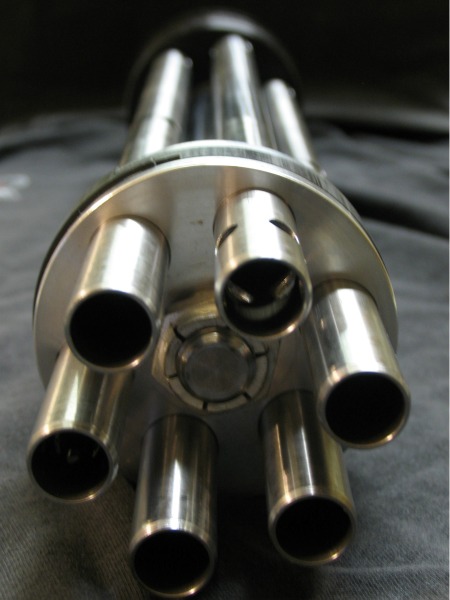

They work great....in the Pismo sand. Haha! Rebound is just too slow and they seem to stack up in tight whoops. Can't seem to get the front up on top. That could be lack of HP! I'm actually thinking that just drilling a few small bleed holes may do the trick. They're certainly not tapped out on the compression side and maybe it would help on square edges?? It would certainly rebound quicker. Oh! and they work great on street whoops. Nick will back me up on that. Haha!

Bleeds should be easy. Just tap for an Allen screw in case you need to block them up.
What does the piston look like in these?
Re: Brian's '96
philofab wrote:Bleeds should be easy. Just tap for an Allen screw in case you need to block them up.
It's round and has 6 holes in it. Haha! But that's about it. Plenty of land for bleeds.
Re: Brian's '96
Thinking #8-32. Bigger? smaller?
Re: Brian's '96
yikes wrote:Thinking #8-32. Bigger? smaller?
#6 or #8 is where I would start. I forget what SAW 2.5" pistons have, but it's one of those. I would try two #6 open to start.

Ditto on Philo's call... definintely drill and tap... easy way to go and adds the adjustabilility. I'd go #6 and go from there... if the #8 is too big, it's tough to go smaller...

philofab wrote:What does the piston look like in these?
SAW 4x12 bypasses 009-02.jpg (57.79 KiB) Viewed 1171 times
Re: Brian's '96
Oh wow, lots of room for free bleeds or one way valves. The piston looks thick enough to machine for a checkball, spring, and larger set screw with a bleed in it. Super cheap way to make a one way valve.
Re: Brian's '96
Free bleeds are all low speed damping. With the design of those shocks I wouldn't think too much low speed would be a problem. What you might be seeing is that in order to get the thing to not feel like a sloppy pig you screw in the adjusters and run into high speed problems. Running stiffer check valve spring might allow you to open up the mid stroke tubes with out the low speed getting out of control.

I wonder if you could fit a small shim pack between the bypass tubes on that.... looks like enough room for rebound shims.
