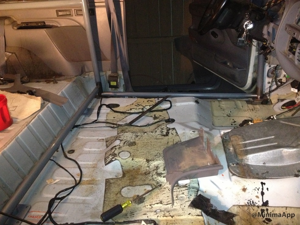

Whiddlin' on the floor bars past few nights.

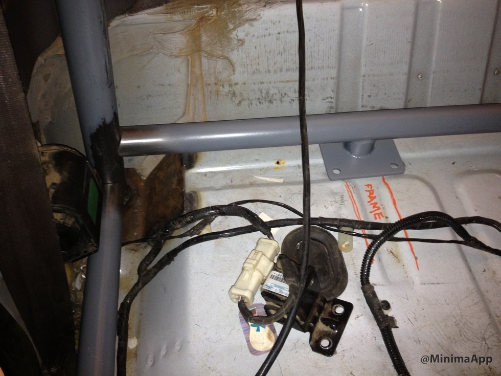

Well my plan is the 2 bars at the bottom of the doors will have 2 straight bars side to side with seat tabs stuck to them, on possibly both the front and rear front seat cross bars ill add floor tabs to further strengthen the structure that re-use the old stock seat mount holes to the body.
Attached to that rear crossbar there will be 2 sweeping bent bars the will attach to the rear shock cross bar, between these 2 the rear seat cross bars will be added agian re-using the pre-exsisting seat mount bolt holes to give strength. I assure you guys the seats, cab and cage will be solid as possible. I'm not a fan of being thrown about like a rag doll. Last time it happened.... Yes I said last time :D after giving a nice fat kiss to the roof and a belly bump I came to rest with my back landing on the shifter handle, it's wasn't a pretty roll over btw. 2 end over ends and 5 side rolls later I will go happily and completely overkill with attachment points.

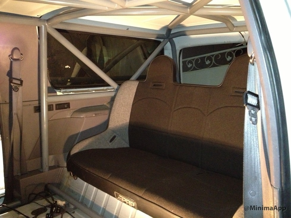

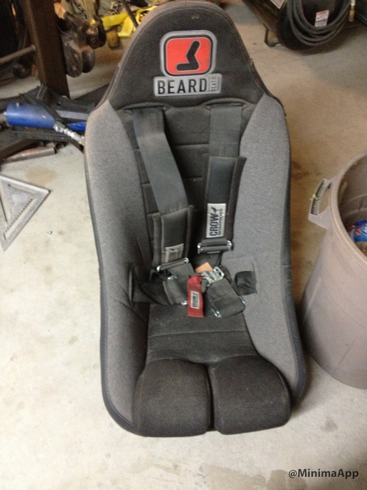

So I threw the bench in the back... It looks great. I'm not really feeling the front seats though. I'm thinking I need a jeep style suspension seat. The beards are super narrow and would be far from passenger friendly. With out the recliner it may also pose a uncompfortable knee senerio for the rear passengers too. :(
I'm also rethinking the rear seat brackets a bit too. I'm thinking a hoop on that rear floor bar would make life easier for bolting up the front tabs.

Here's the beards.
