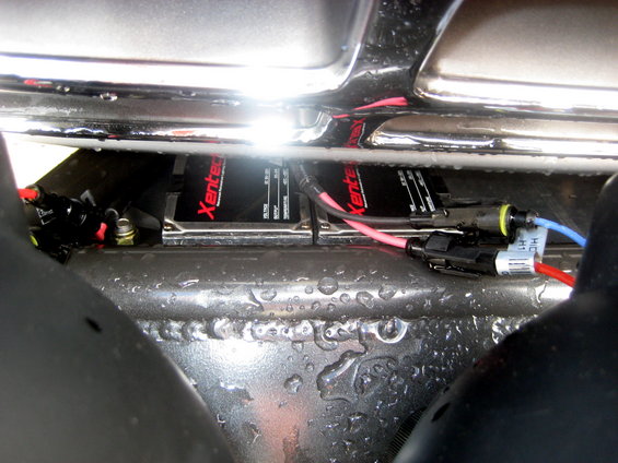

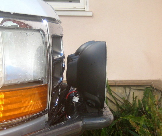

Not much to show right now. Been super busy with baseball. Beginning tear down for swapping the trans this weekend. Trying to resist temptation to upgrade things at this point. Too much time. Too much money. Spent a few hours mounting the ballasts for the lights and running wires into the engine compartment. Moved the outer lights toward the center to protect them better and facilitate mounting a bolt-on brush guard in the future (haven't made it yet). Also moved the lights forward 3/4" so the grill can be removed without removing the lights. Didn't want to hack the grill up to do so. Mounted the ballasts to the skid plate. Had them there in the past with double sided tape. Worked well, so I just bought some cheap brackets and bolted them on. Didn't want to put them on the core support. More crack inducing weight. Haha!Garlic Bronco wrote:any updates? would love to see some more pictures even of old work

No progress on the trans, but finally got the HID's installed on the headlights. Now the workbench is clear again, so it's time to lay (on) concrete.

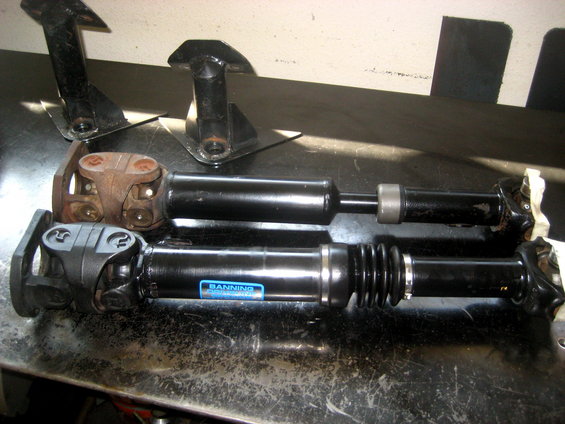

Got my driveshafts ready to go. Shortened the Primary and replaced the seal and a u-joint on the spare. Gonna build a mount for it in front of the spare tire.

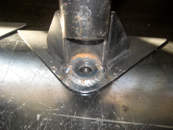

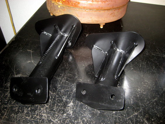

Making some modifications to my cross-member links because they started cracking at the backing plates. Not finished, but got a couple washers welded in.

Added a center gusset to the cross-member links. Should help prevent cracking.
