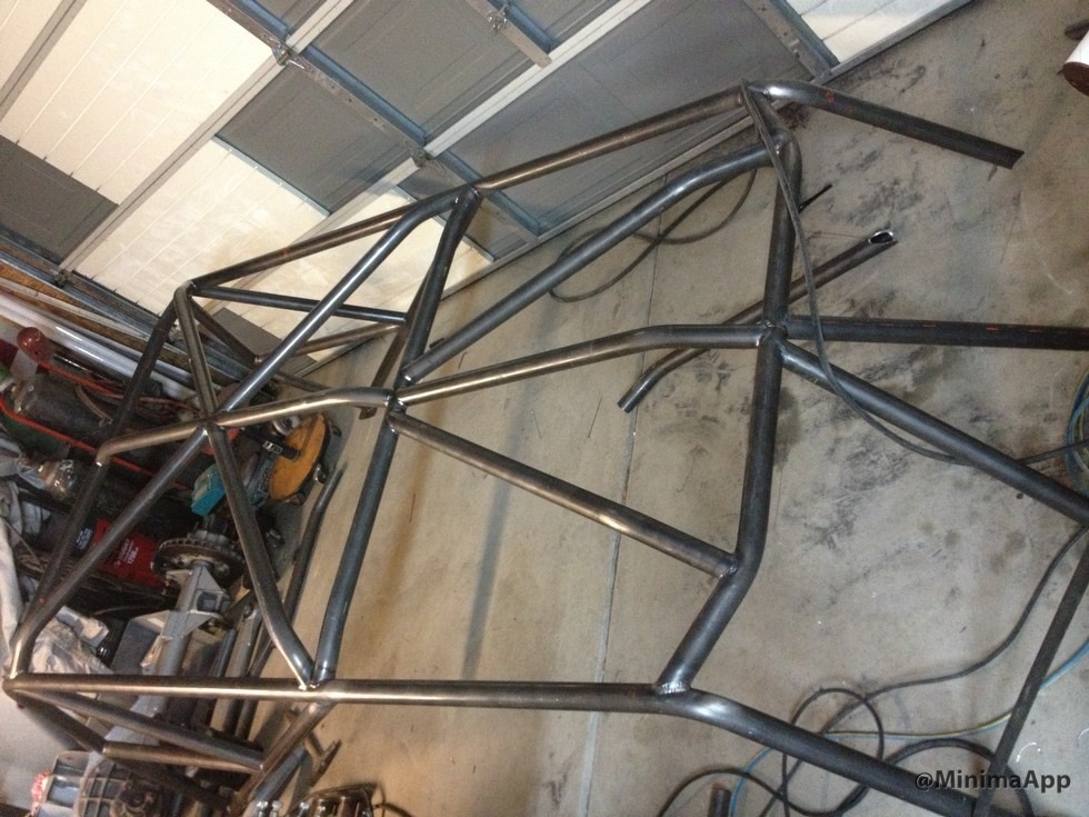

Wow! How are you tying both the upper and lower section in?
Posts: 6026
Re: RMC's el hefe build.
What do you mean upper and lower? There's the the front windshield bar, the B pillar tubes, and that's it besides all the frame ties.
Posts: 4619
That's what I meant. How does it tie into the frame?
Posts: 6026
Oh gotcha. Well j tubes at the A pillars, crossbar on the floor at the b pillars with straight inline floor plates, at the C pillar 2 diagonals with floor plates above the frame rails. So after all this junk I will install solid body mount set and short risers to floor plates between the floor and frame. So 6 cab frame ties total, 4 via floor plate, 2 via J tube with floor plates.

I'm half inclined to build a giant jig to replicate this thing but that would be quite a mission all by it self. It would sure be nice to be able to buy something like this plug and play.

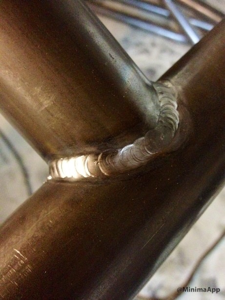

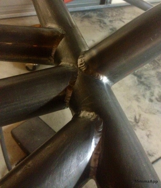

Welds look killer!!!!
Posts: 6026
Thank you sir!! I officially have 9 hours experience under my belt lol.

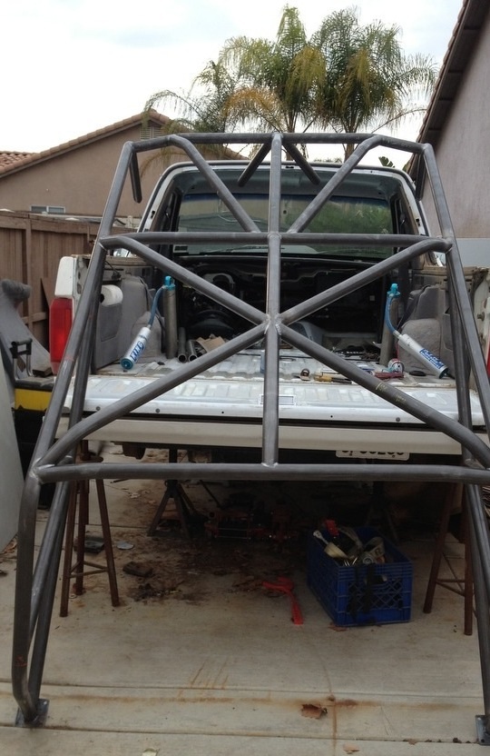

Finished welding up the cage this past week, ready for install agian. 2 last bars to fit in place then final install. I also ordered a 4ft sheetmetal brake today so I'm stoked!

So this past weekend I had a friend help me slide the cage back in for fitment of the last 2 tubes. Next up, remove it and paint it before final install.
