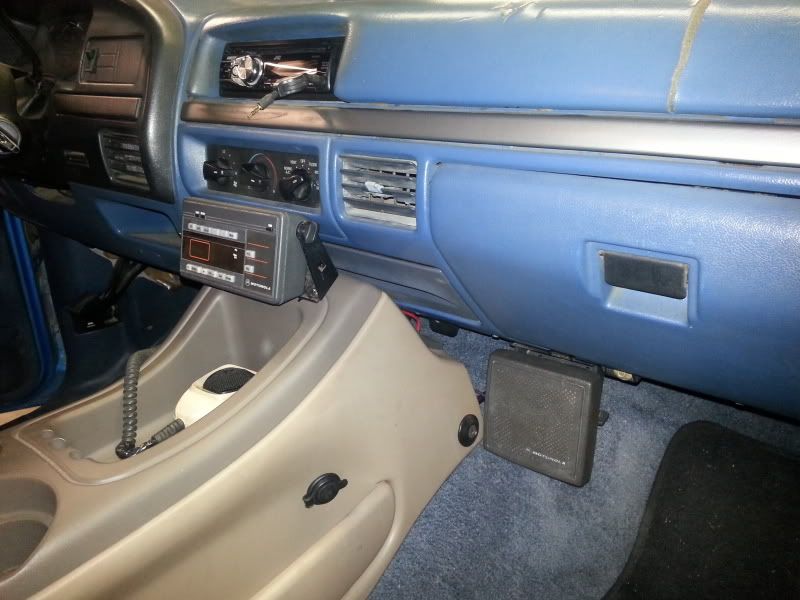

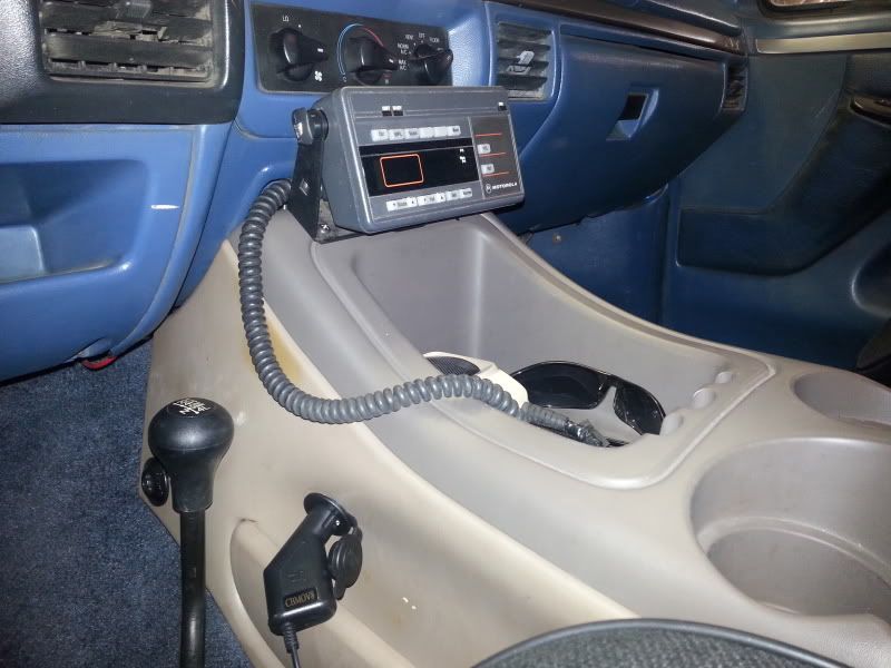

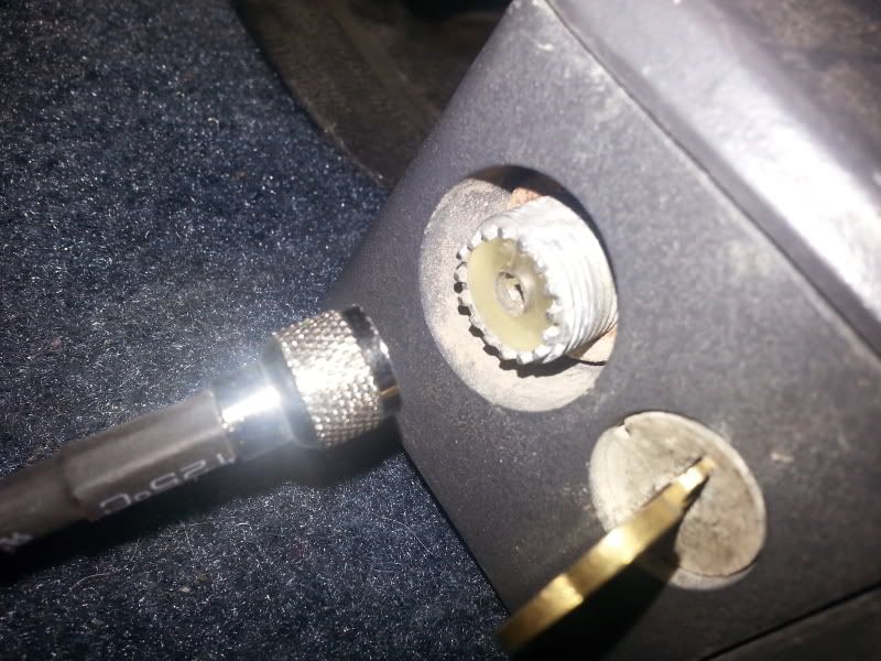

Got some stuff done this afternoon. Installed 2 power ports and the race radio. Ran into a problem when I went to screw in the antenna to the radio, it didn't fit. Do I need an adapter or do I have the wrong antenna? ImageImageImage
Looks like the wrong antenna Kelly, you want one with a PL-259 connector if memory serves me right.
Kel Fab Creations
Posts: 727
Bronco Info: 95 Bronco
Location: San Jacinto, Ca
Post by Kel Fab Creations »
:( This is the one you gave me. :(
Kel Fab Creations wrote::( This is the one you gave me. :(
Then looks like I owe you a new antenna cable...
Looks like you need a UHF mini to pl259 adapter. When I do Motorola Mcs 2000 radios it's needed.
JA_gonzalez
Posts: 115
Joined: Sun May 12, 2013 2:39 am
Bronco Info: 95 F150 4x4 only has a 6in lift soon getting some solo Motorsports radius arms and
Post by JA_gonzalez »
Go to radioshack they carry all of the adapters
