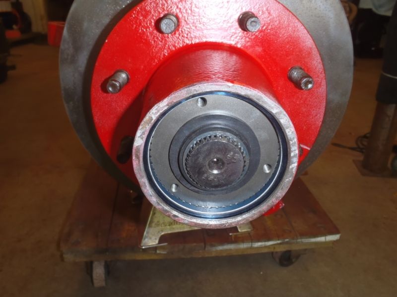

why are you opposed to a drive flange? all the bolt on full floats ive been around the get used in the dezert (ultra4 racing) all weep and leak.

Because I've seen what happens when a drive slug fails, and I have seen those fail literally just driving down the street. I've never seen a bolt-on drive axle fail in moderate use, i.e. more or less the use they were designed for. I'm not crawling or racing this thing with 40's on it. I just don't like semi-floating axles. Racing is a good extreme circumstances test, but it really doesn't address real world longevity.
I'll contend that those that are weeping/leaking were not put together with the intended gasket (14bbff), face seal o-ring (Sterling 10.5), or with Hylomar. People used to think my FJ60 FF axle was leaking. It was not. They were seeing dust stuck to the Hylomar.

ok this has been bothering me for a number or reasons, but how did you see an internal drive flange fail? theoretically, there is no room for it expand and the axle shaft would twist long before the internal or external splines would.ntsqd wrote: ↑Sat Aug 01, 2020 6:41 amBecause I've seen what happens when a drive slug fails, and I have seen those fail literally just driving down the street. I've never seen a bolt-on drive axle fail in moderate use, i.e. more or less the use they were designed for. I'm not crawling or racing this thing with 40's on it.

Sheared the splines off the ID. Which un-wound the Detroit Locker. Explosively. This on a simple, from a stop, left turn onto a residential street. This was in a Warn FF conversion kit, but I have no idea if the slug was a Warn part or someone else's.

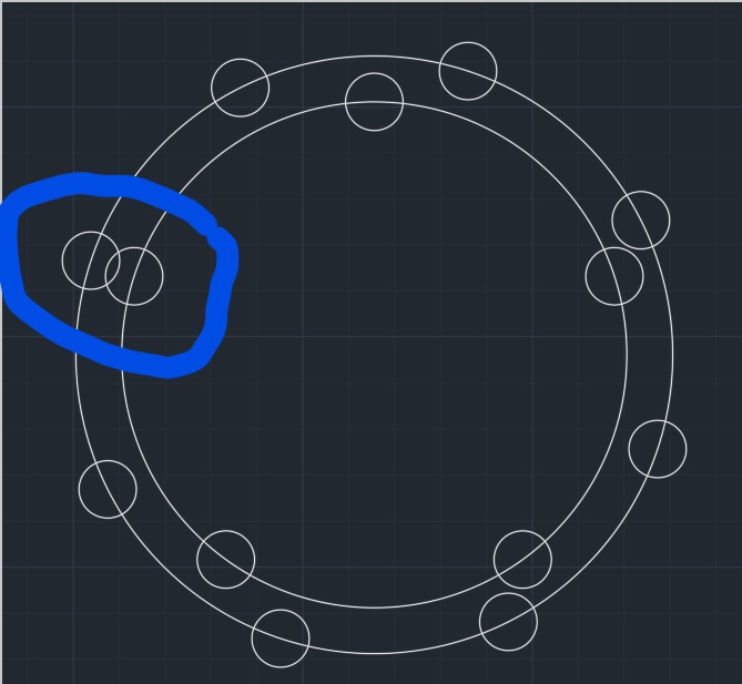

I bought a set of D44 TTB knuckles, spindles, & wheel hubs with the idea of looking into what it would take to convert them to 8 lug. Ideally what I'd like to do is use D60 LA or D50 TTB front spindles and wheel hubs on the D44 knuckles, and use something like the rotors and calipers off of a current gen Tundra. I've seen some comments about using some or all of the D50 TTB's axle shafts in a D44 TTB to increase the strength of that part of the front axle assembly, but I do not yet know those details. I am hopeful that the outer shafts wouldn't have to be custom parts.

you could always chop the 44 beams at the knuckle and weld the d50 stuff on if you want the bigger stuff.
a simple way to accomplish what you want would be to drill the d44 for 8 lug. just weld one of the hold shut before machining and youd be good to go.
