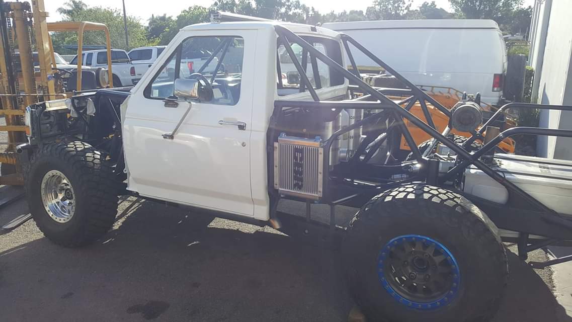

Lol yes we do all of Dave's stuff these days. The fodge is hardly the fodge anymore. Only thing left from fodge days is the frame rails we built completely new truck in house for Dave. Ill dig up a pic of her for you.

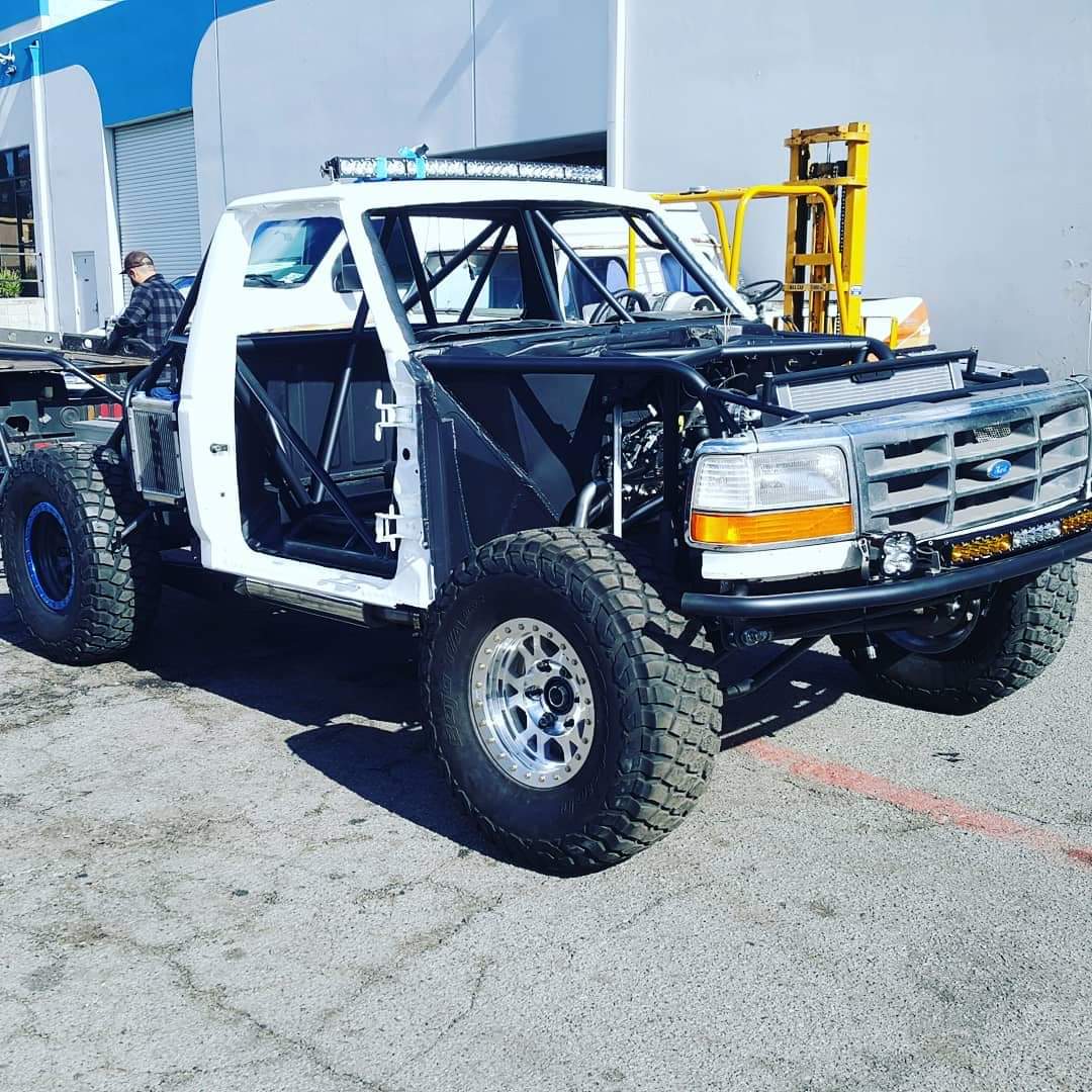

Here's whats left of the fodge.

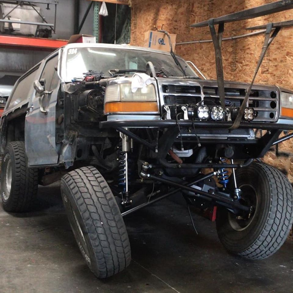

We finally spent some time on the Bronco over the last month or so. Pretty happy with how it is coming together. Another 25-30 hours and I will be able to drive it hopefully. I hope everyone is staying safe and healthy in these crazy times.
Bronco 2.jpg (136.13 KiB) Viewed 38226 times

Does the front axle spin freely drooped out like that? Would expect yokes to bind up and snap if spinning while dropped like that.
We clearanced the heck out of ours and still could not get that much angle out of them.
Now we run an RCV CV joint in the crossover joint.

baja-chris wrote:Does the front axle spin freely drooped out like that? Would expect yokes to bind up and snap if spinning while dropped like that.
Hey Chris. This was before we strapped the front end. We strapped it so it will not have this much droop I just had this pic from moving bronco around shop with forklift to show the CHO beams we installed. Once budget allows I plan to go RCV axles with center cross over joint.

I had to clearance my passenger side diff yoke significantly, I had to cut the axle shaft, and I had to get creative on welding the cap to get full travel. The most deceptive part was you can drop your beams and a welded cap will hold. But if you dropped your beams before you put axles shafts in, then you know your clearance. After you put the shafts in, your clearance is limited dramatically. This is all relative to Cut and Turned beams giving the 4" lift.
Attached is a pic of the rough 1/2" I had to cut off from the axle shaft and comparing it to the factory. After this I now have a spring in the yoke, and yes the yoke axle cap is welded in. I had to grind the yokes a lot to get the clearances since it would bind before hitting full drop. Even then the axle shaft was the limitation so I had to chop the 1/2" off it.
Also attached is what it looks at full droop where you can see the axle shaft blew out well past the yoke pushing the spring out and busting the cap. Regardless, it's the shaft that's took long which is very evident.
After all said and done, no cap busted and I've hit full droop unstrapped several times even in 4x4 :)
