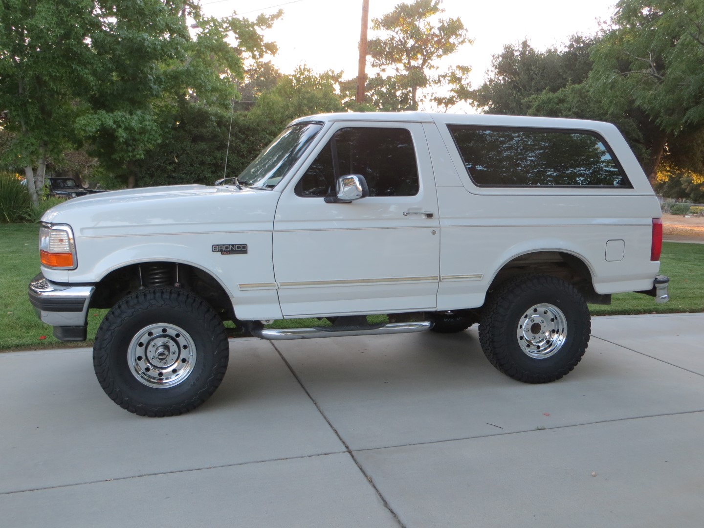

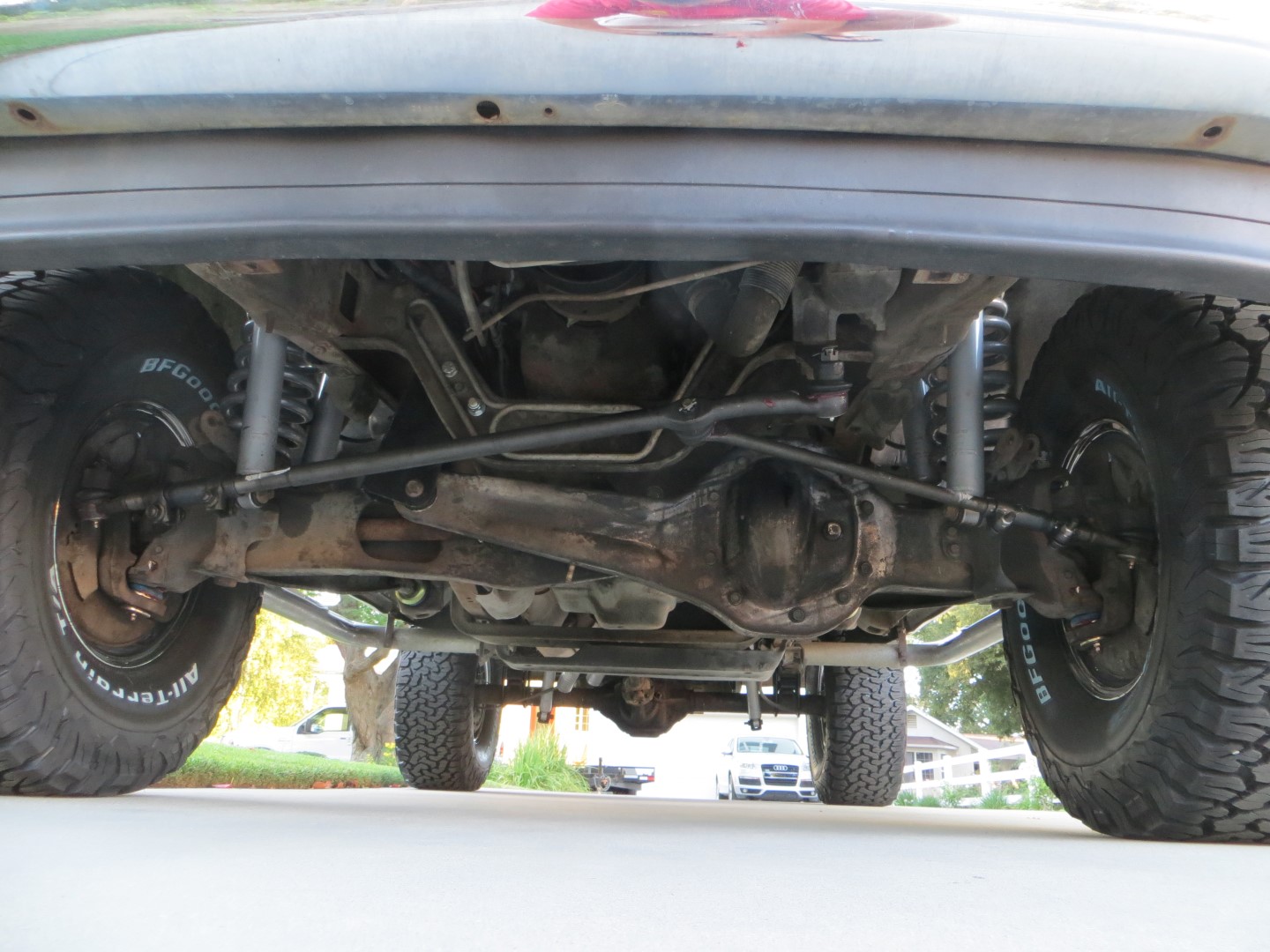

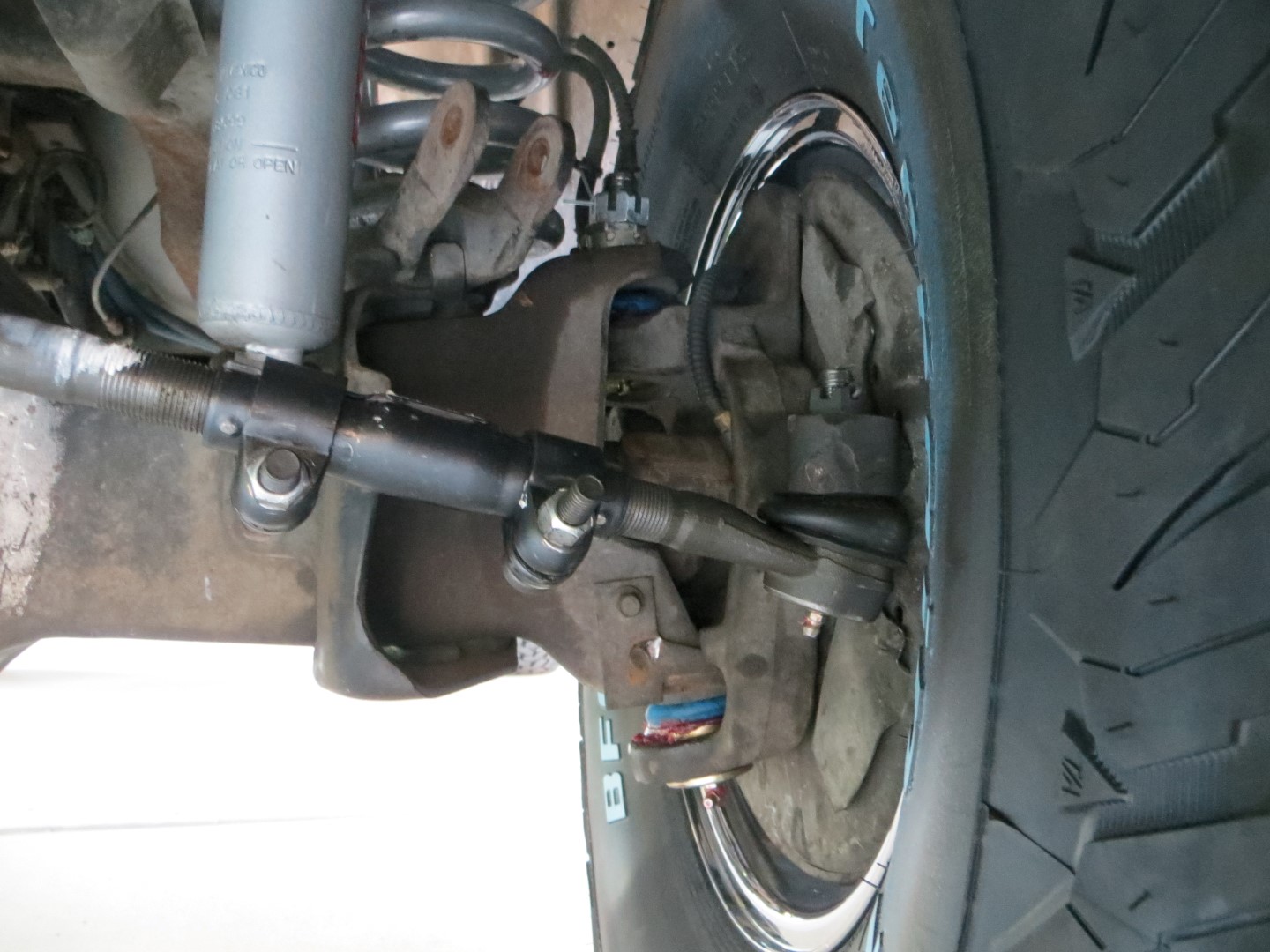

With its loose and weepy 8.8, Mom & Dad's Thanksgiving Bronco is home with new shoes, Napa blues, all new ambulance steering and an alignment making it go down the street as straight as an arrow. Quite a bit more mannered on the road than Jim & Paige's Bronco.....perfect for a temporary DD.

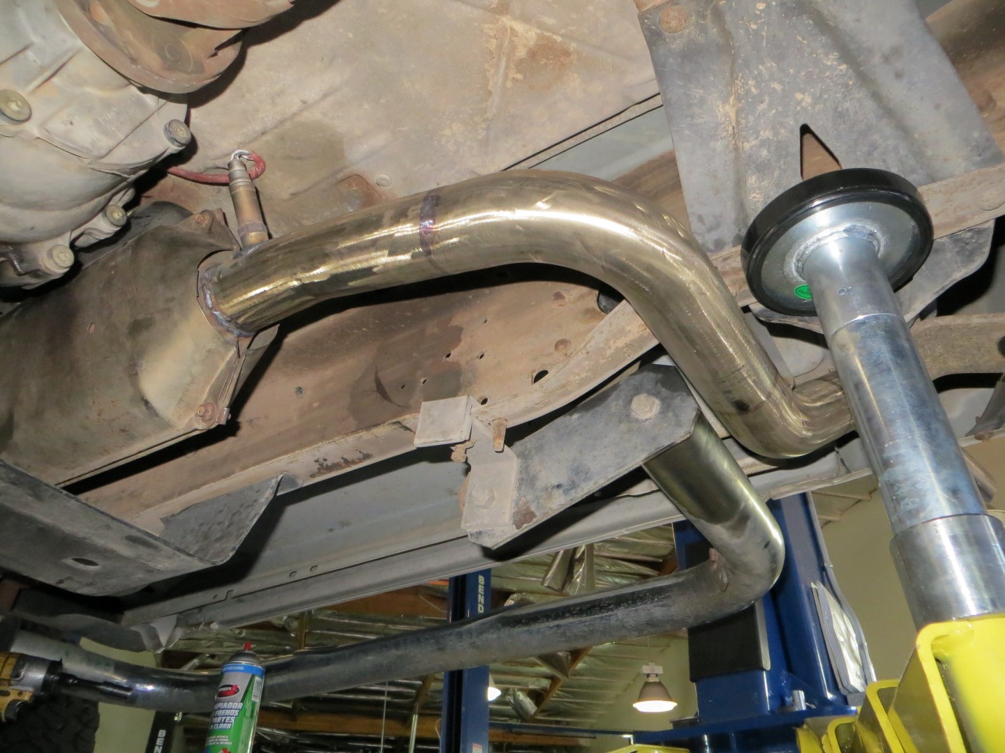

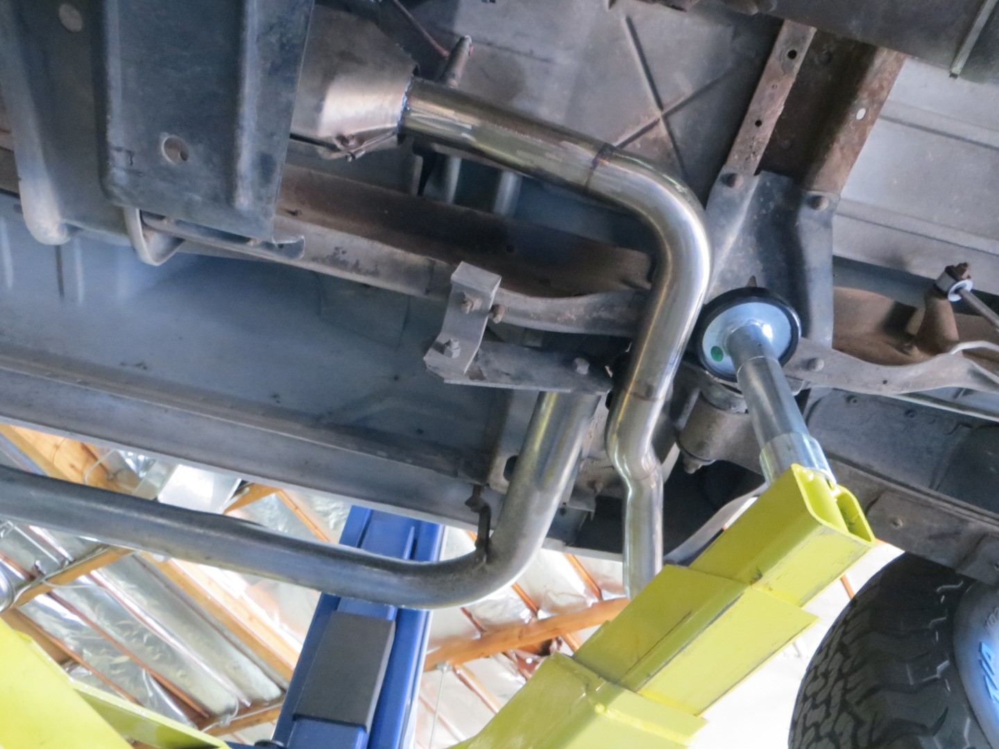

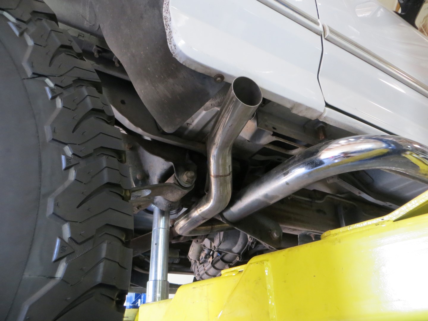

In the meantime Mom & Dad's Thanksgiving Bronco got a new stainless tailpipe but I've got to get rid of those silly chrome steps. Pretty sure Mom is going to need a little AMP Research help. Anybody have a good hookup for pricing on some of those neat little devils?

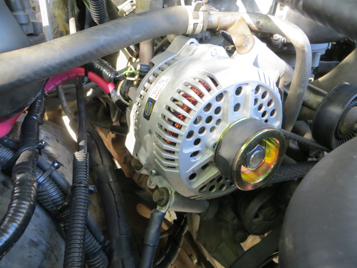

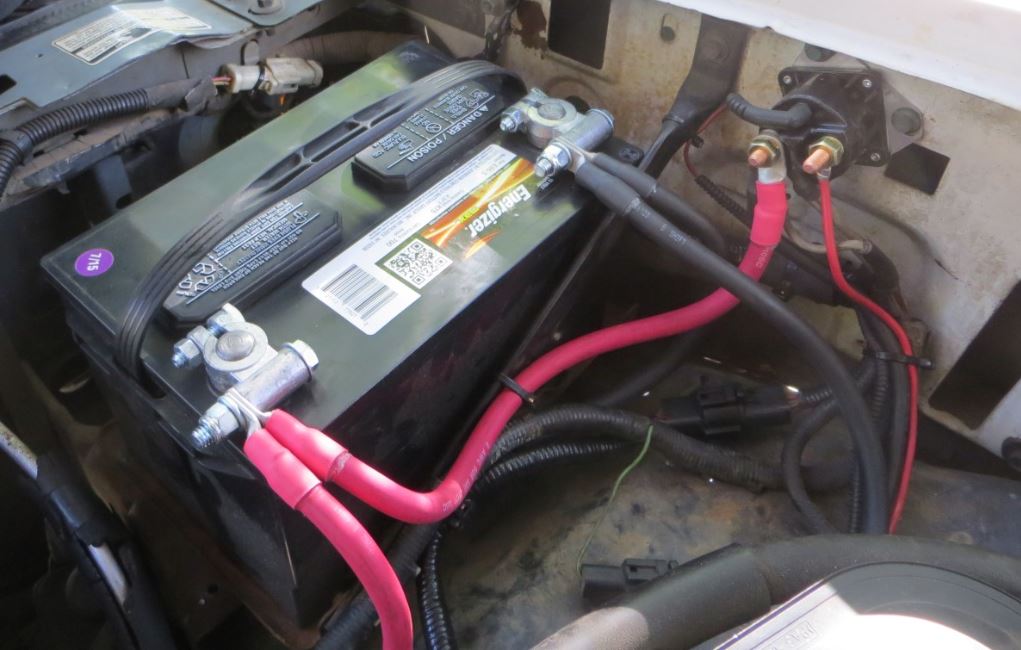

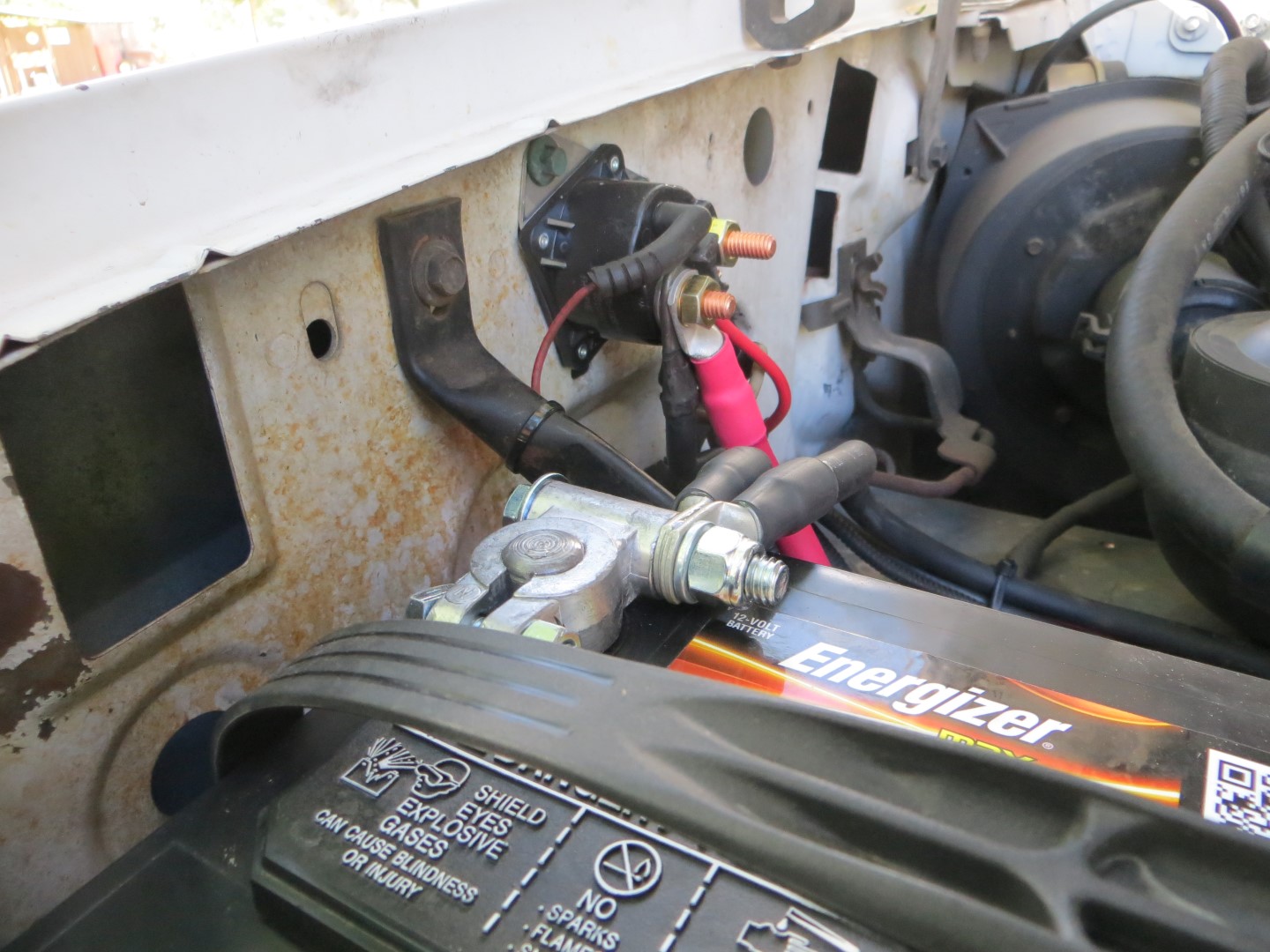

Stopped driving the Bronco recently because the voltmeter on the dash was moving all around and I knew some of the PO's wiring under the hood was a bit jinky. Been gathering parts and I finally had a weekend at home, so yesterday Mom & Dad's Thanksgiving Bronco got a new 130A 3G, Motorcraft relay and #2 battery cables. All good now.....Red Head next.
