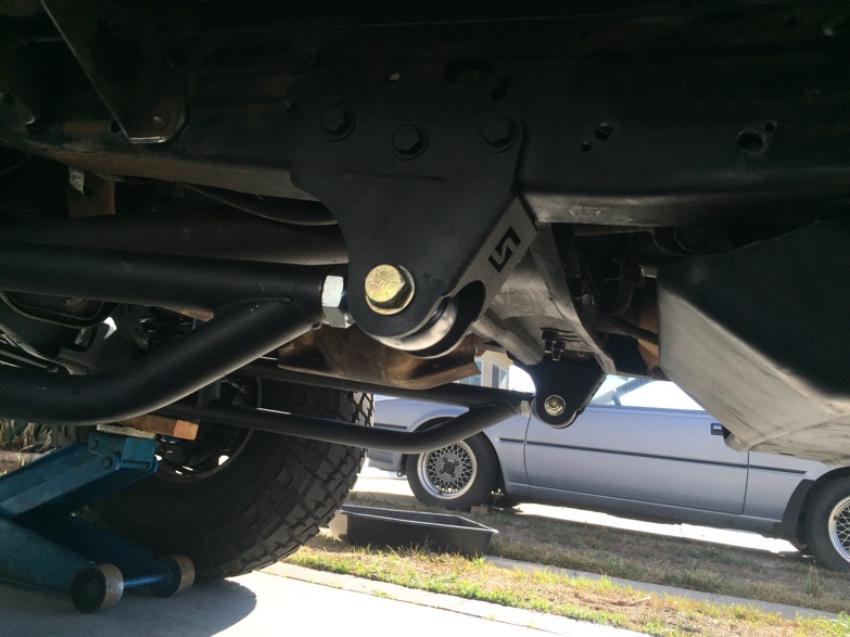

Been bad about updating my thread lately. Lots of
work out of town and stuff but the Bronco is finally back up and running. Long story short, me trying not to save money and keep it simple from the get go failed, because the radius arms only work with a drop bracket..with a cut and turn the camber ended up being way screwed and I needed like 6 degrees to bring it back to stock. I called Bobby and Paul over at solo trying to figure out where to go from there, and they confirmed my suspicion that my radius arms were in fact the issue....next thing I knew I forked out the dough and Solo was good enough to drop the radius arms to me at the job I was working. Threw those bad boys on after work and dropped the bronco at my buddies shop for alignment on my way out of town for work last week. Picked it up yesterday when I got home and put about 50 miles on it. Thing got hot and kept stalling out on me. Not sure what's going on with it, but maybe the truck has the wrong thermostat on it or something. No codes but it's obd1 and I don't have a lot of experience with those. Anyone have any idea what might be going on?

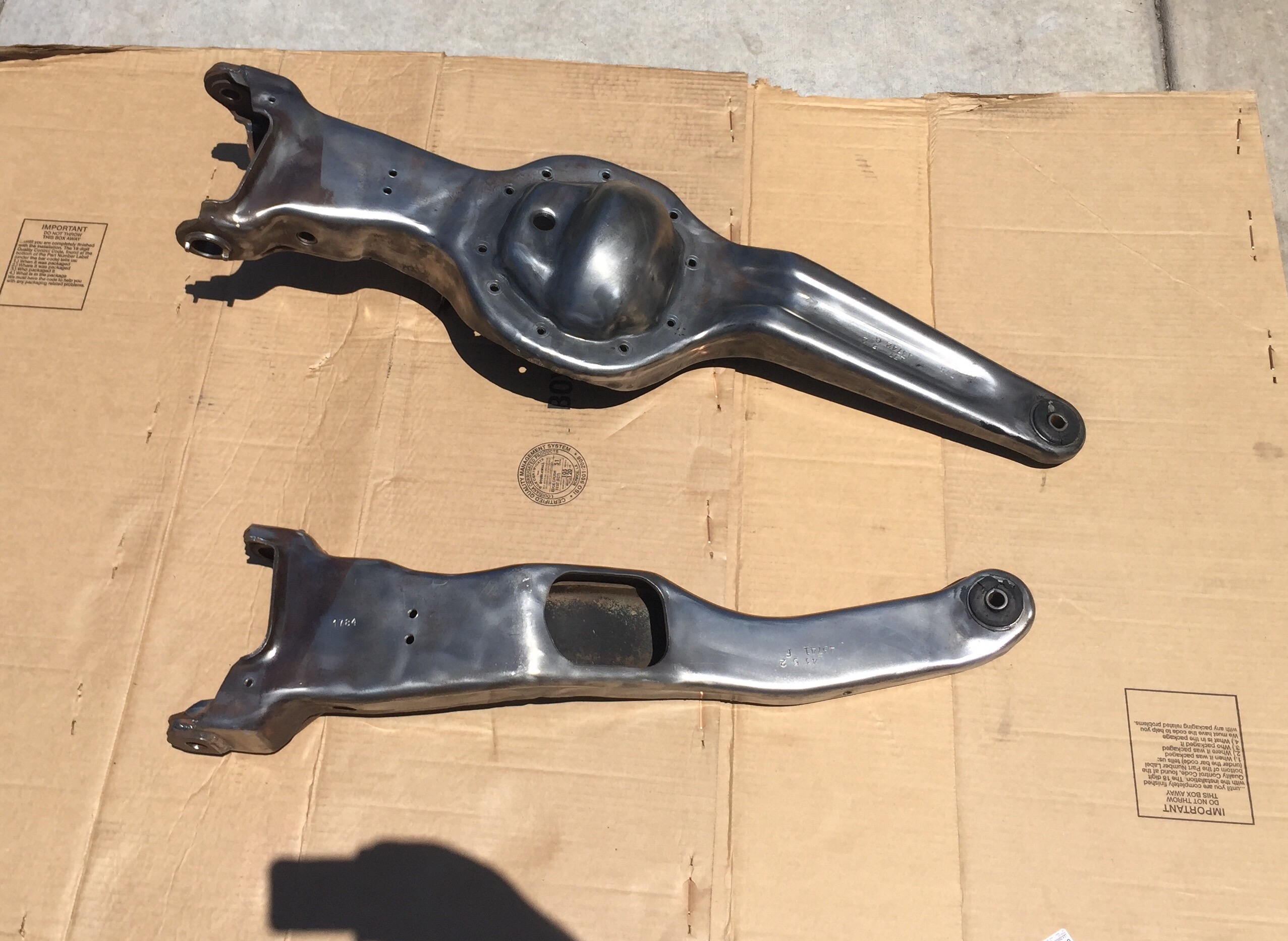

Picked up my beams from Dave and started cleaning them up.

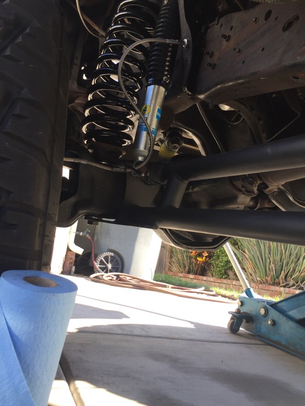

Stabbed my Saginaw pump in. One day I'll get around to cleaning up this engine bay.

Hey just wondering why you went with threat motorsports with cut n turn beams and with the radius arms you went with solo? Was it to save money? Why not just go with one company? Like your set up. Clean looking ride.S00TLYFE wrote:

Solo was really busy when I called for the beams and Dave had them done in a day. Plus I bought the beams from another member on here who lives out that way so he was able to drop the beams off with Dave for me. I tried to do this whole thing on the cheap and slow to avoid having it down for a long time, hindsight being 20/20 I would have just bought Solo's complete stage one kit and been done with it as I sourced the F53s from another member here. I might have saved a couple hundred bucks but the amount of time it would have saved me wouldn't have been worth saving a couple $ (to me at least)
That being said, I don't think you can go wrong with Solo or Threat, both really know their stuff and make a quality product.

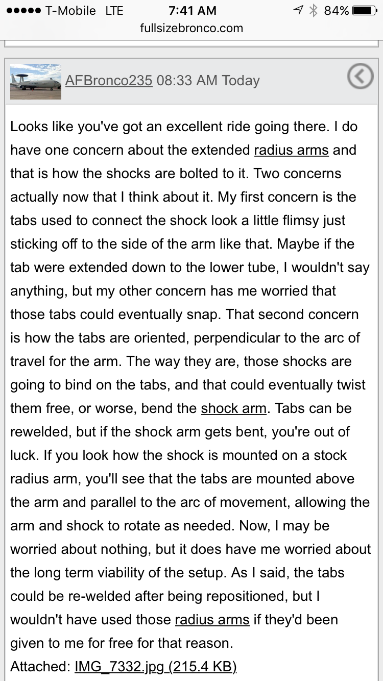

Well, apparently according to FSB Solo Motorsports doesn't know how to make quality radius arms and they aren't worth running even if they're free.
Now I know what you guys are talking about when you say stay away.

Haha! He wouldn't use $900 super beefy radius arms if they were free just because of a shock tab. Wow. Those tabs are way way stronger than than anything stock on the bronco.S00TLYFE wrote:Well, apparently according to FSB Solo Motorsports doesn't know how to make quality radius arms and they aren't worth running even if they're free.

Haha I've seen that dude on there saying plenty of interesting stuff. I wasn't aware being in the military automatically makes you a master engoneer based off of a couple pictures on the Internet.

To play devil's advocate, I would argue one of his points is valid. The shock tabs are in rotation as opposed to on top of the beam like the OE mounts. They are out of phase, but so are the OE mounts, just in the opposite direction. They aren't perpendicular to the beam/arm arc like he said though... he obviously doesn't know as much as he thinks he does!

SteveG wrote:To play devil's advocate, I would argue one of his points is valid. The shock tabs are in rotation as opposed to on top of the beam like the OE mounts. They are out of phase, but so are the OE mounts, just in the opposite direction. They aren't perpendicular to the beam/arm arc like he said though... he obviously doesn't know as much as he thinks he does!
So what's this Hydroturf stuff you speak of?
But like Travis pointed out, doesn't that lend itself better to the way the suspension cycles better than oem?
