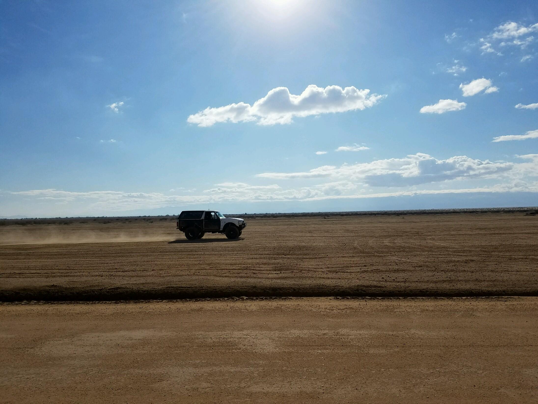

After picking up the bronco from Brandon and heading to Plaster City we had an awesome 4 days out there. Put about 230 Offroad miles on the bronco and it ran perfect. I could not be happier with the new motor and everything else that Brandon did for me. Can't believe I waited this long for the upgrade. I had a great experience dealing with Brandon, will definitely have my bronco back up to him for some updates in the near future. The bronco looks good from far but is far from good so this is the only pic I saved all weekend.

I am beyond stoked that you are happy John. It came down to the wire literally lol. But with picture messaging and text it worked out and we were able to tap into the factory harness and make her run happy. Big thanks to Travis with helping to wrap it up as well. Thank you for the opportunity and we look forward to the evolution of your bronco. Now if I just had time to get mine wrapped up for some plastercity trips.
