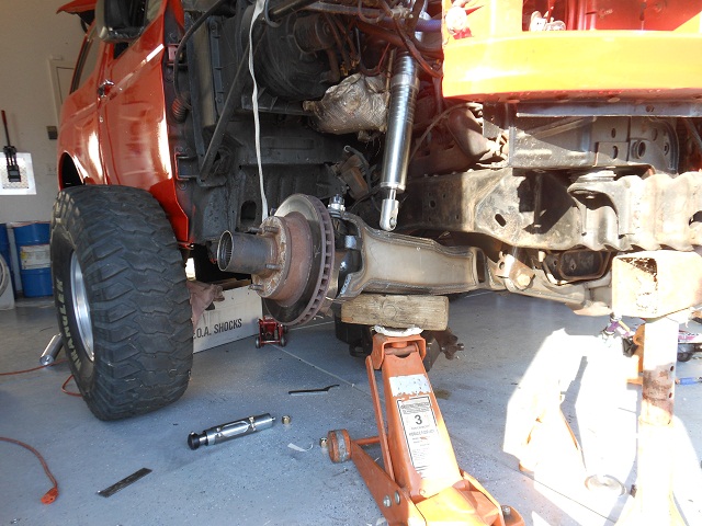

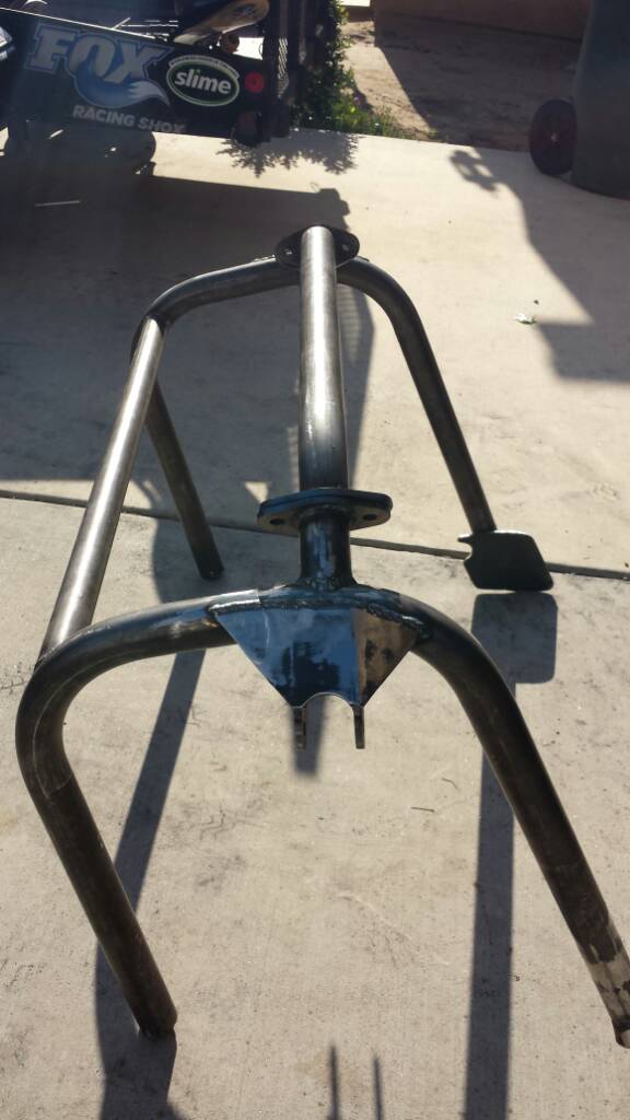

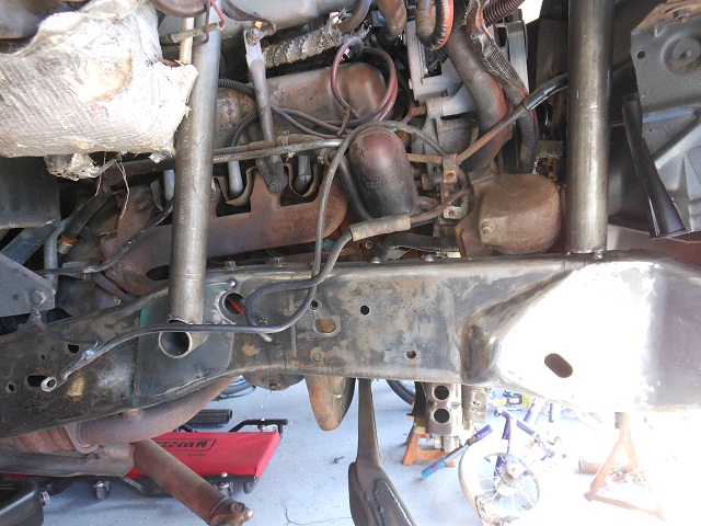

some shock hoop work last weekend

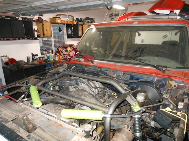

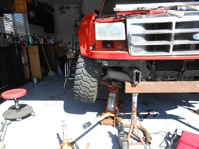

had the day off the other day so started getting the hoops tied in

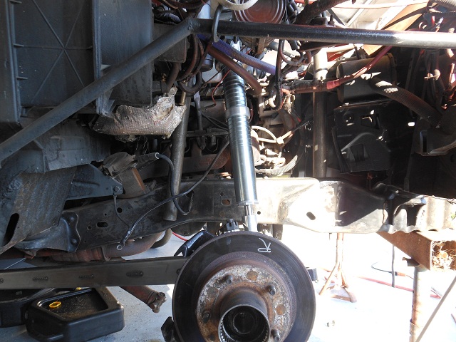

well got the shock mounts and cross bars all tacked in yesterday. going to take the engine cage out today and finish up the welding.

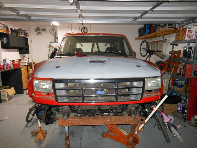

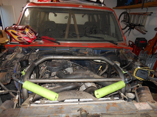

A friend of mine owed me some money so i took his hood. had to fit it on last night to see how it all tied together. i like it. also had to make sure everything cleared under it.
Re: "project orange juice"

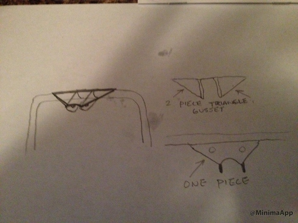

I'd add triangle gussets to the outside of each tab. Ill draw you a pic. You could either make one big one to go over the top or 2 singles per side. Just trying to think of ideas to make your upper shock mount more stout due to the leverage agianst it.

Yea I was a little concerned about that

I was going to box them in top and bottom. I tried to get the shocks further in bored but couldn't quite get tge angles of the shock right.

I do like the 1 piece idea Rmc but its just not feasible do the rear mount being at the bend. Goint to cut out some gussets tomorrow for each side.

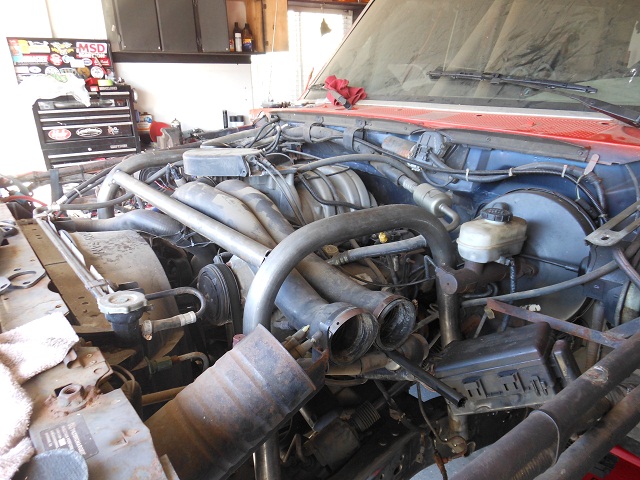

All torn apart for final weld and paint

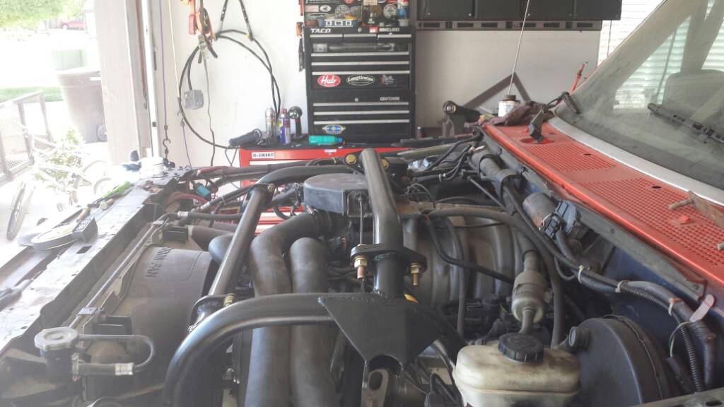

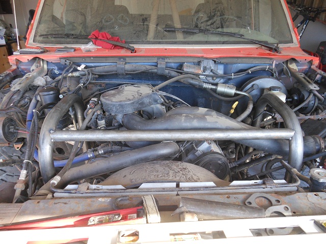

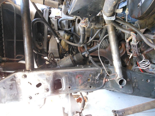

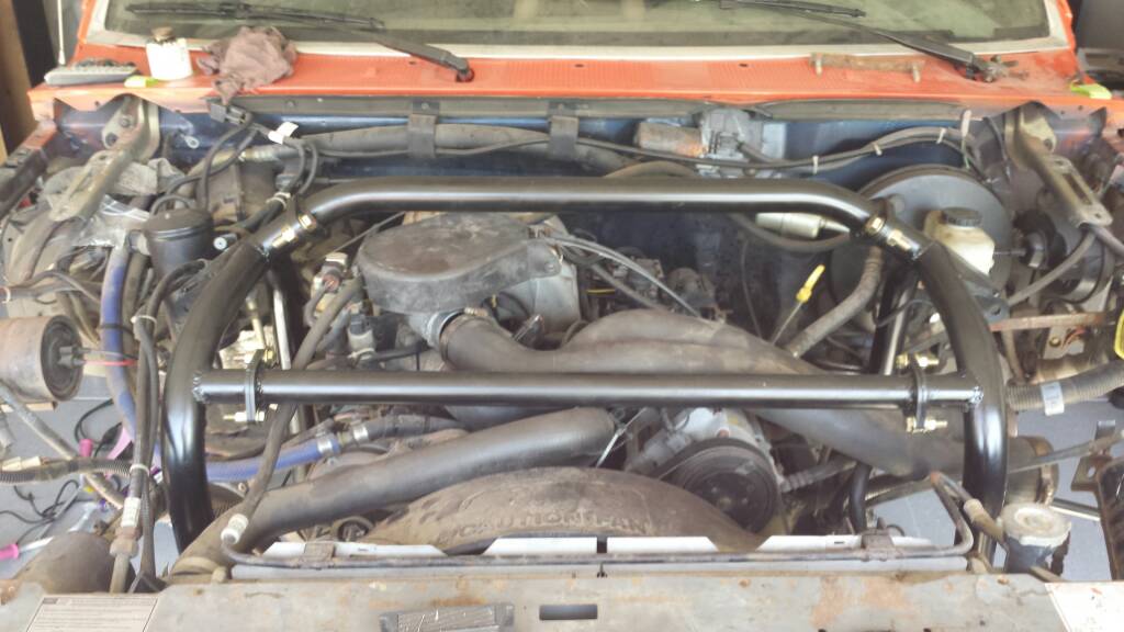

So engine cage is done and welded in.

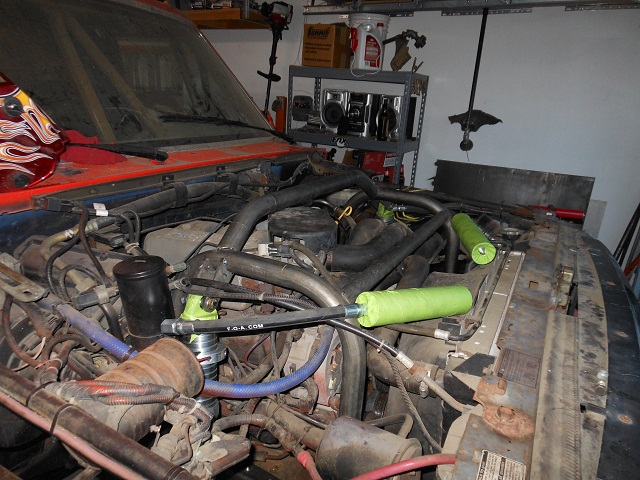

Side view

Upper drivers side view.
