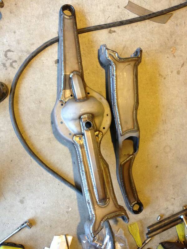

Got this picture from Dave today, I can't wait for them to show up.

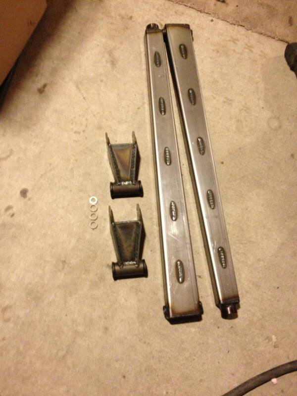

Another picture

Tell Dave to stop teasing you and ship em lol
It's gonna be good bro, just make sure you put the stitch welded side out on the radius arms. One way it's like 16 degrees caster and upside down ( stitch in) it's like 26 degrees or something like that. Confirm that with Dave I may have it backwards but its important. Just looking out for you man. Can't wait to see the progress.

I'm the one that keeps asking for pictures. I guess I like torturing myself. Thanks for the heads up on the arms. I'm hoping Monday and Tuesday I can greet some work done on the engine cage. I have the next 12 days off but will be snowmobiling and snowboarding most of them.

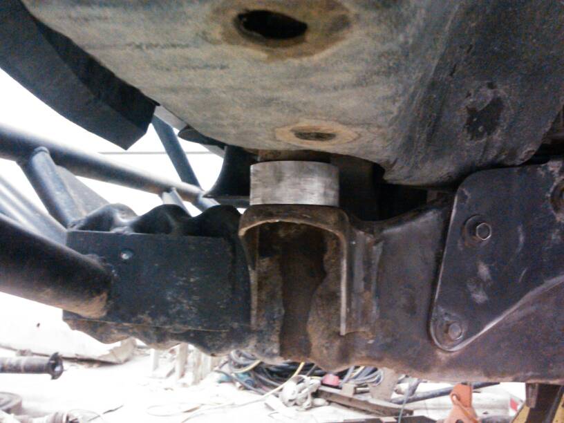

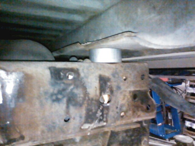

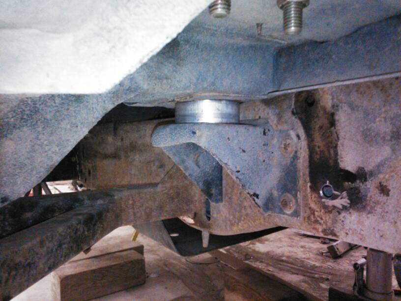

Post by snowman429 »
Got some work done on the Bronco today. Was able to get my solid body mounts in. Wasn't to bad but did have to take a BFH to a couple of them to separate them.

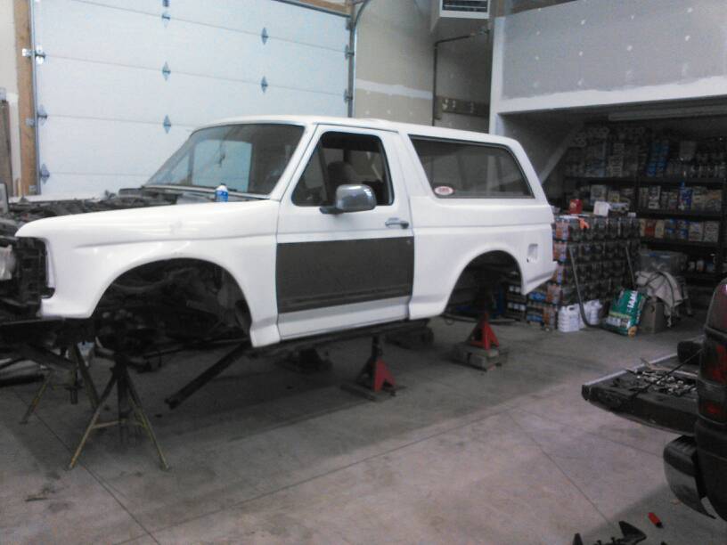

Got the fenders off this afternoon and had to set the fiberglass on to see what it was going to look like.
