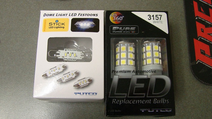

So got some Putco LED bulbs for the taillights and the dome light. I hope they perform well. plan to put them in tonight. before and after pics will come later tonight.

So the tail light bulbs were a total failure. I put them in and they didn't light up at all. not on breaks, running lights, turn signal, nothing! They did work on the wife's Yukon however so I guess she'll get them. The dome light bulb worked great, but I never realized that my real issue was how brown my dome light lens is! I took it off to change the bulb and was surprised how bright the old bulb actually was. Once I get a new lens it will be awesome!

Did you try flipping them 180° ? LED's are directional and power only flows in one direction. I'm sure you know this but have to ask... :)

Yeah I did. Still didn't work. :x I'll have to try to mess with them when I get home. There is still the possibility that it was operator error.

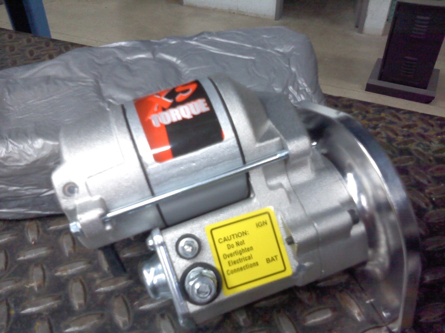

So almost ever since I've had my Bronco the thing has been hard to start when it's hot. I've tried everything I can think of, new battery, new starter, new solenoid, check the timing, make sure the connections are good, eliminate the cat. Still, if I stop for gas on the way home or to run into a store for a minute, it acts like it has a dead battery and cranks slow. So todays project is to install a new Power Master XS Torque 200lbft starter. Hopefully this will do the trick! I'll get some pics once it is installed!

So got the starter installed and it did the trick. It cranked over well after an hour driving making several short stops.

Wow you went big! Thats one hell of a nice starter! Glad it solved your problem :D

Yeah. I didn't want to take the chance of it not fixing the problem. Go big TO go home in this case. lol. :)
