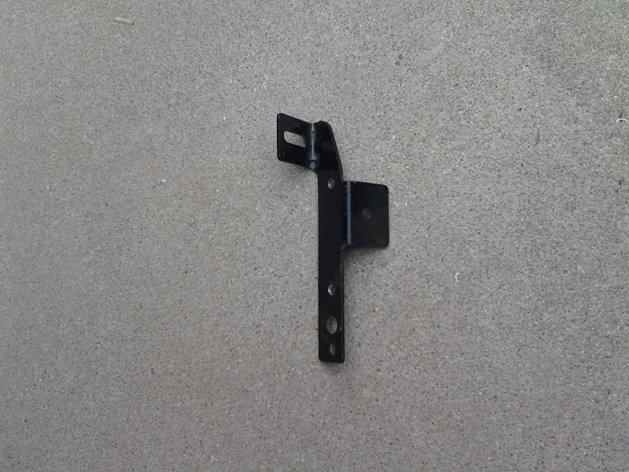

My motor was missing those stand off bolts that the coil bracket mounts to. So, I got those too but they aren't the right ones. Slightly larger... I am gonna have to open up the holes on my bracket a little bit. Maybe tomorrow.
Re: 95 XL hunting truck
Nice! I still need to make one of those or order it
