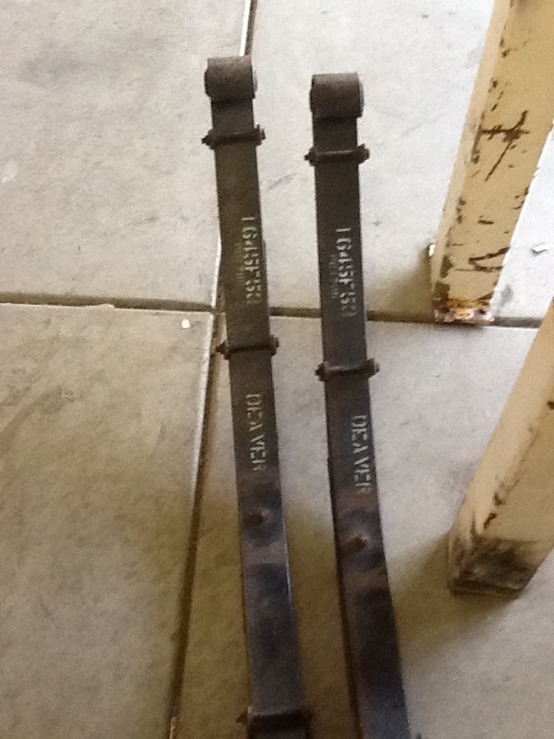

Just picked up some more pieces to my puzzle from Kel Fab creations. I have to say the man does awesome work!!!! I'm only sorry that while he was spending time making these for me, I took time away from him working on his own project.
I also have to thank Robertcrav, I picked up F53's last week from him. Another piece to my on going puzzle.
It was nice meeting both of you, and I thank you both.

Nice! Andy (Jones) picked some of these up and I got to see them in person... Very nice pieces! Looks like you scored, rear of the Bronc is almost ready!

Looks Awesome! Kelly does some great work. How long are those shackles?

Was nice meeting you too Jose. As I followed you on the freeway for a bit i was staring at your truck dreaming about mine. Lol.
Andy, the shackles are 9" center to center. Get your order in soon shackles are going up in price.
