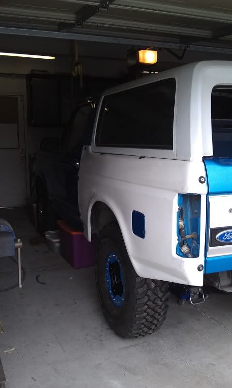

I used u-nuts on my quarters... allows for the fender to be moved around a little for fitment. My Autofab glass didn't fit perfect around my tail light either... but I think John mentioned that it was made for the earlier (80s) Bronco rear.
I think on your glass I would just trim the back off off and do a little fiberglass work to match it up.
I was bashing. But then again I'm the a-hole that does that and I really dislike the quality of 90% of the off road glass I've seen. I know much better can be done. I've done it and so has John.

Man, why didn't I think of those u nuts. That would have been easier. I'll probably do the fiberglass reshaping after I get all the new suspension under it.philofab wrote:I used u-nuts on my quarters... allows for the fender to be moved around a little for fitment. My Autofab glass didn't fit perfect around my tail light either... but I think John mentioned that it was made for the earlier (80s) Bronco rear.

Haha. I have heard that autofab's glass is top notch but I prefer the flat top, wrap around, and tapered rear of the fiberwerks.ChaseTruck754 wrote:I was bashing. But then again I'm the a-hole that does that and I really dislike the quality of 90% of the off road glass I've seen. I know much better can be done. I've done it and so has John.

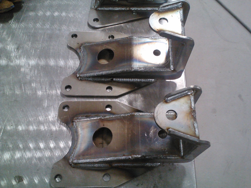

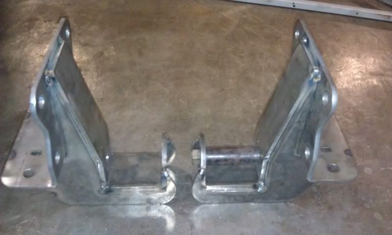

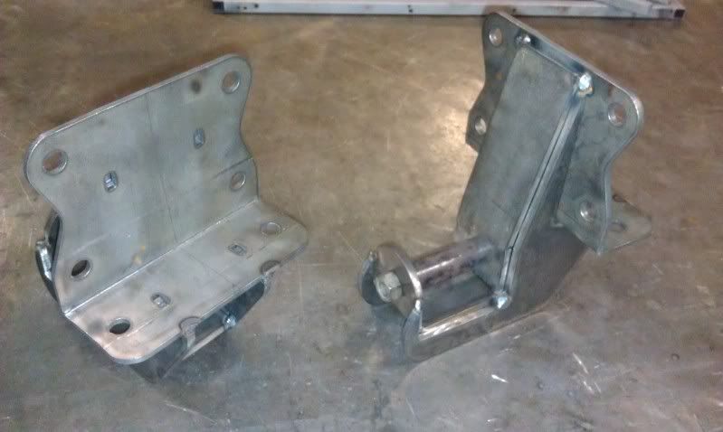

rear dropped shackle hangers.

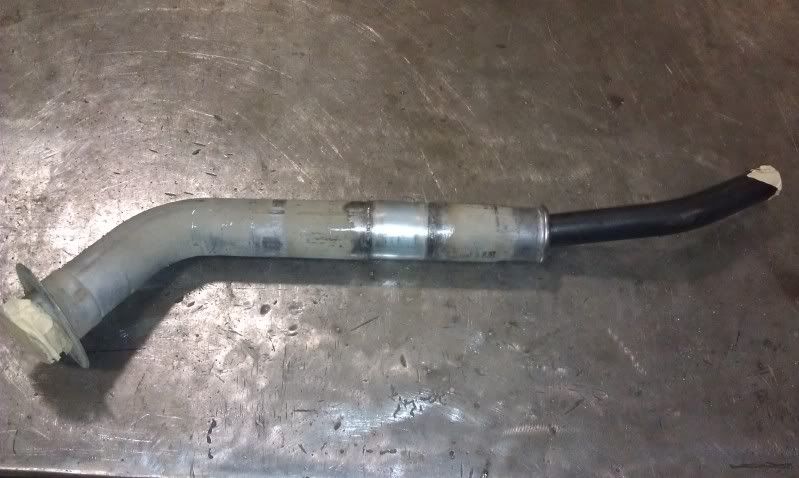

extender fuel filler to fit up to new glass.

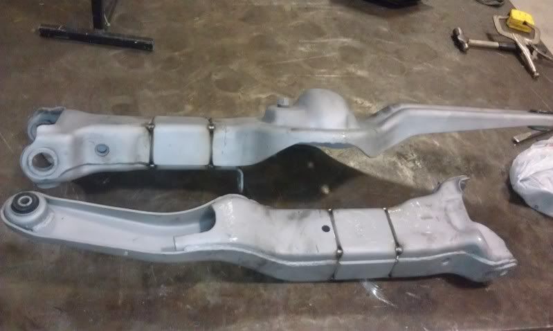

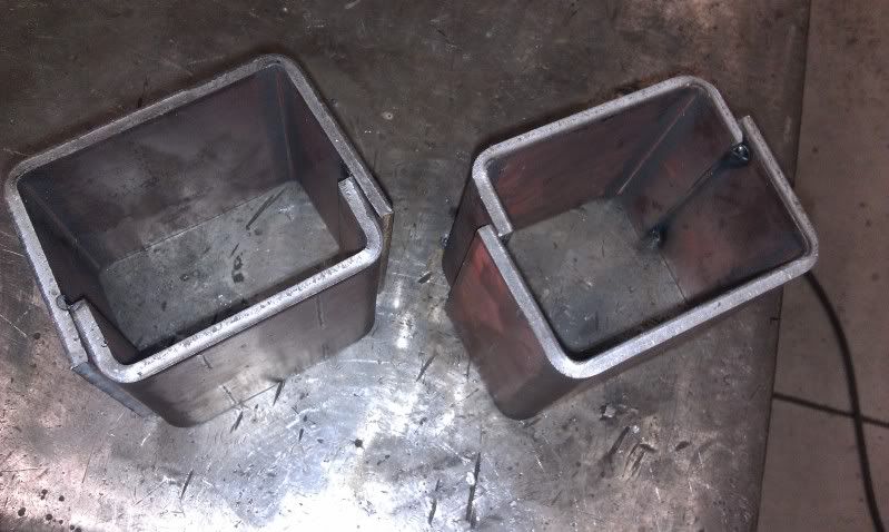

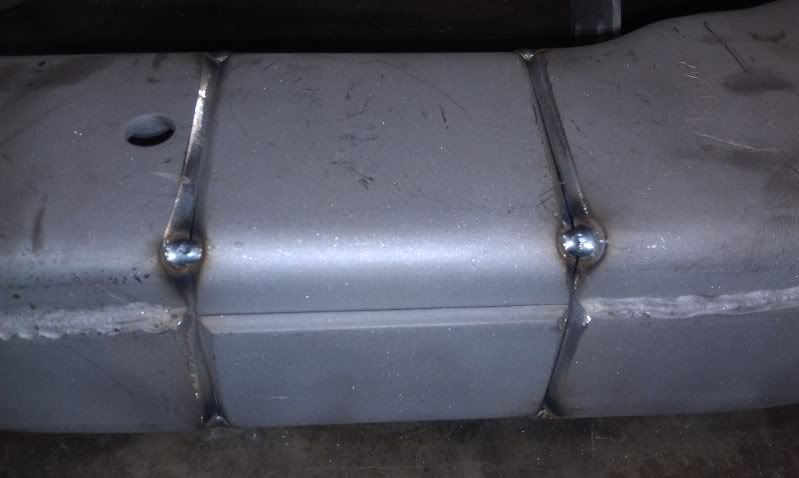

started working on beams. 4.5 extension. pretty stoked on these extension pieces.

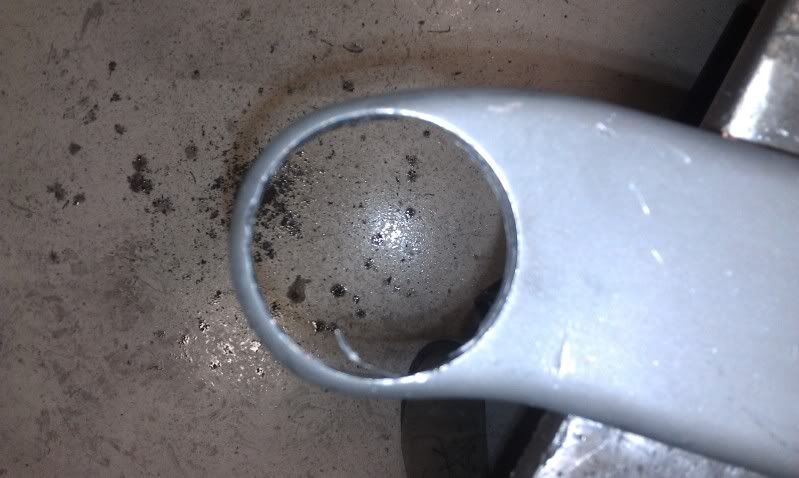

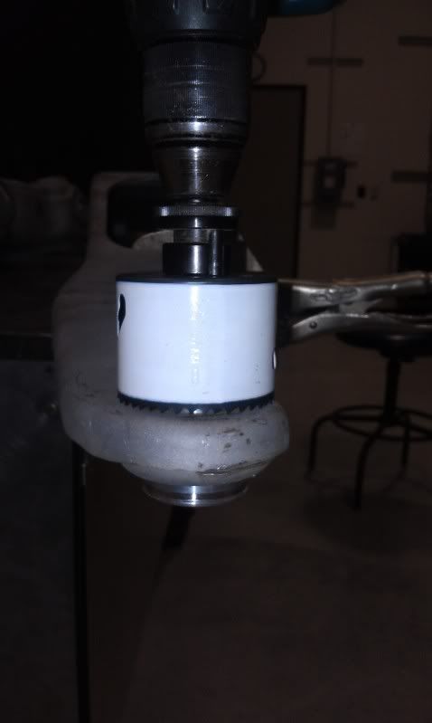

machined this hole saw pilot adapter thingy up. never opened these up for a uniball before but this is what i came up with. worked great. i got a tip that some guys are doing something similar to this but keeping the bushing in there while doing it but my bushings were squished so the sleeve wasn't exactly in the middle anymore. My way just seemed to lessen any further clean up afterward. the cup fits snug. not sure if anyone has a better way to do it but this worked quite well.

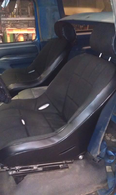

got new seats too, mounted on stock sliders. got the sliders from a guy that had em on his 96. i expected the pass. side to have the tilt with no slide. What year did that end? would my floor even fit that style direct bolt in? as it sits you would have to climb in between the front seats to get to the back but i wanna have a center console. ideas?

My 92 only slid forward. I just built my center console to hole the weight of a person getting in the rear. I do not believe the flip style will fit.

I dig your hangers!

i did the 96 slider on my 86 its not direct bolt in . but does fit the floor

Yours look cool too.ESHALLBETTER wrote:I dig your hangers!

Do u still have the tilt one? Just had to drill some holes?greaslife wrote:i did the 96 slider on my 86 its not direct bolt in . but does fit the floor
Kelly @ Kel Fab Creations
greaslife
- Posts: 1128
- Location: inland impire
no tossed the tilt. yah drilled holes you have too remove a heat shield
- Kel Fab Creations
- Posts: 727
- Bronco Info: 95 Bronco
- Location: San Jacinto, Ca
That damn heat shield rivited on sucks. For those 2 holes u can't get I just ended up drilling the holes out bigger and tapped for 1/2".

Very Nice!! will you be selling your shackle Hangers?.. I have the Solo Motorsports one's.. they just drop the stock hanger and relocate it for the 9" shackles.. I would like somthing more like yours.
- Kel Fab Creations
- Posts: 727
Ya, i'll be selling these hangers. Off the top of my head they are only like a 1.25 drop I think. Just enough to clear the 6.25? center to center shackles I got with the 64 kit. let me know if u want some dropped more. I'll be selling these for 225.
