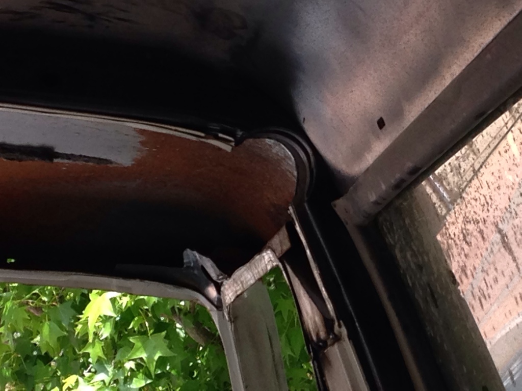

Welded the front parts of the tubes, plated the cage to the a-pillar, and now ready for the new windshield to get put in tomorrow.
Tucked!
Tried getting as much head room as physically possible.

Man, I am retarded for not thinking of notching the roof like you did. That cage looks good!

philofab wrote:Man, I am retarded for not thinking of notching the roof like you did. That cage looks good!
haha. I haven't cut the shell or checked the seal or anything yet. That's all tomorrow. Top of seal should be untouched though, so should still be sealed, i think. I'll figure it out either way. The extra inch is nice!

I cut mine to tuck the cage. No issues with the seal. This for the b-pillars and up to the deal in the center cab

Also pulled and cut out the area of the shell that was interfering with the cage being tucked further up. Both seals still like original.
