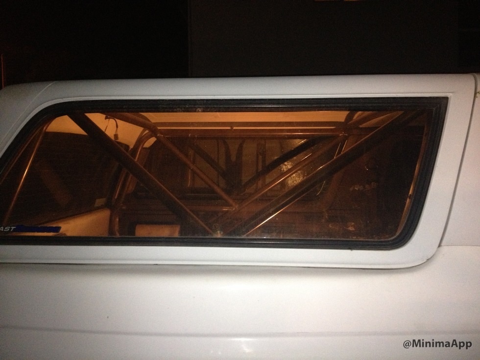

One more crossbar, then all the roof shit and I can pull the top, slide it out and finish the tops of the joints. Last tie ins as I mentioned will be 4 windshield bars and 2 B pillars. Everything is being done in modular sections to go around cutting holes in the floor or roof.

ChaseTruck754 wrote:Dig the C pillar tube setup
Thanks man! the plan is to have 2 diagonals at the flat section toward the frame rails. There will be floor plates there. Under the floor will be a matching floor plate sandwich style to the frame. In the end the cab will still be removable if need be. I only plan on 6 or 8 frame attachments for the cab.

Sounds like a good way to go. I love the fact that you're planning for the body/cage to be able to come off the frame. Most guys don't put the extra effort in for this. It's something I try to do for the "just in case" or prep, painting, etc. factor.

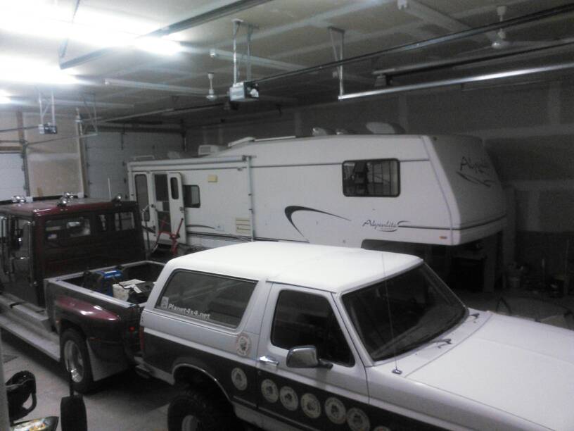

Unless you're shop was like this.
