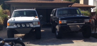

Got her home and cleaned up. Very happy with the purchase. Gonna take care of the registration stuff on Monday and then throwing the seats in. Heading down to prerun the 500 next weekend.

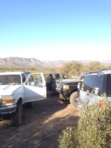

Just got home from some prerunning for the 500 and the initial shakedown with the new rig and I couldn't be happier with the maiden voyage. Tina's a big softie.
Here's a brief rundown:
We lost the low pressure line on the power steering pump on our way to the border which was a little hair raising (see: smoky). Got a new line and clamps on her and kept trucking. The truck ran flawlessly after that for the rest of the trip. For being a handful on the street, she boogies in the dirt.
I went down with the crew from Giant Motorsports who are gonna be racing Geoff's Sportsman truck. They had some transmission problems with their Bronco, so we weren't able to get as many miles in as we'd hoped but were still able to do Santo Tomas to race mile 230 (150 miles of race course). We had a good, mellow crew though, and it was a low stress affair. We figured it was better to call it then to push our luck on the last leg to Mike's which we had heard was pretty damn nasty.
I was lucky to have my good friend who's a hell of an off-road driver riding with me. We switched off driving a bit and he put her through the paces and got a real good grasp of the truck's capabilities. The stretch of course we ran offered up a good range of terrain so it was perfect test run. He was hammering on her, and she kept right up. Definitely very very comfortable to ride in.
This little run did give me a good idea of what upgrades will have to be made.
The truck definitely doesn't like being loaded down. The preload will have to be adjusted before trips based upon how much weight is gonna be in the truck. There was a significant difference in handling when we had a fourth person in the car. I think bump stops on all four corners will also have to be added. The 2.5" shock out back held up surprisingly well, which was awesome. I was expecting them to be nuclear hot, but they did great.
The steering definitely leaves something to be desired. Right turns a a piece of cake, but the body roll when turning left can get pretty gnarly. I'm wondering if a single swing steering set up will help to correct this. It seems to want to push through turns sometimes. It's fine for the cruising around that I'm doing down there most of the time, but when it comes to pushing her a bit harder, I feel like it'd be worth the investment. I'm gonna lower the ride height an inch or so when I get bumps. I think the lower COG will help.
Creature comforts will be gettting dealt with before I head back down for the 500, starting with the fixing of the power door locks, windows and the pass side door handle that broke off. The AC needs some loving too. I think the compressor might be shot. I tried loading it up with a can of the Kragen DIY refill but it wouldn't take it.
I'm also gonna have to hunt down any and all leaks into the cab. The interior has a fresh new coat of authentic Baja silt which I attempted to deal with this afternoon to no avail. The fumes were also pretty bad inside the cab. The exhaust dumps straight down underneath the truck. I have to figure a way of having it dump out elsewhere. Not sure if it's possible with the suspension configuration.
All in all, it was a great first run. She felt equally adept at eating up whoops, plowing through the silt in 4x4, and cruising at 70 on the highway. The cantilever set-up was a hit with anyone who actually noticed it. Keeping the space inside the cab is soooo nice. I don't think I'd have the room I need with any shocks poking through.
Here's a couple pictures for proof. Can't wait to head back down.
