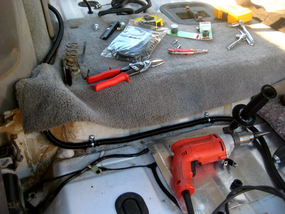

Little progress. Trying to keep the wiring simple.
Found more cracks while looking for routing points for the battery cable. These really suck. Can't ignore them. The good thing is this should be the source of the clunking I was hearing before, not to mention the wet floor. Won't be able to avoid a cage for too much longer.

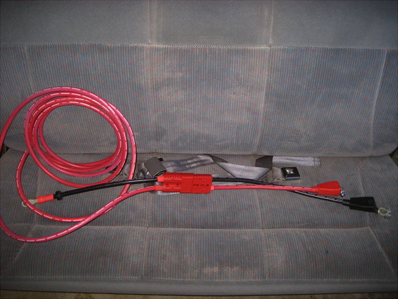

You running dual batteries? What did you get the disconnect plug for, pulling the battery or charging?
Looks good!!!
Re: Brian's '96
Silverslk wrote:You running dual batteries? What did you get the disconnect plug for, pulling the battery or charging?
Looks good!!!
In all honesty, that is just there to slow down the thieves when in Baja. I'll have it hidden and disconnect it whenever I'm away from the Bronco. I'm sure there are other secret ways to prevent them from driving away with it, but like I said, this should slow them down....at least 30 seconds. Haha!

Add a small (20-30amp) circuit breaker around the connector, that way you don't loose radio setting and the ECM learn. If someone tries to start it will just pop the breaker and kill everything.
Re: Brian's '96
philofab wrote:Add a small (20-30amp) circuit breaker around the connector, that way you don't loose radio setting and the ECM learn. If someone tries to start it will just pop the breaker and kill everything.
You gotta understand Philo. I'm electrically inept. This is already pushing my competency. Haha!

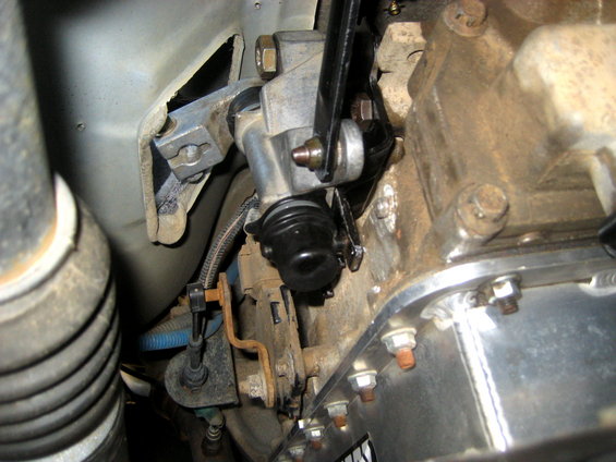

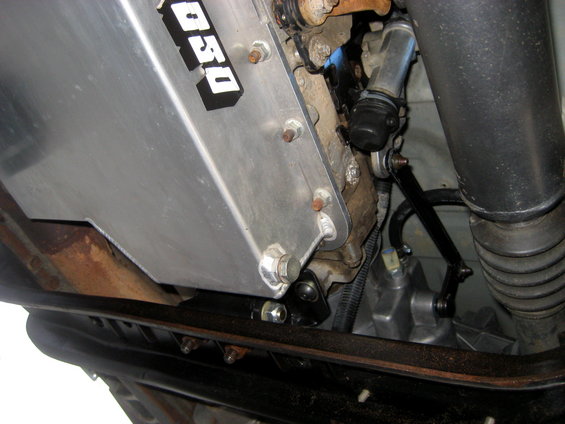

This week was a capital B. Worked 9hrs today, but managed to at least get the T-case shift handle made. Woohoooo! One more thing down. Gonna get it powder coated along with the battery tray.
Couple shots of the shifter.

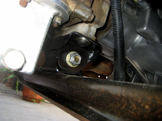

Autofab trans mount
The shifter. Maybe chrome would be good? Haha!

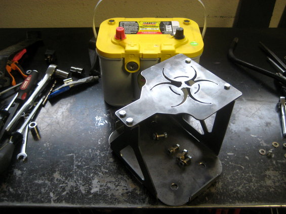

Picked up battery tray #3 (haha) on Ebay. $35!! and I like it better than the previous two.
