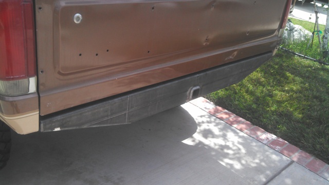

And I'm getting to C H O status on the welds haha. Making a new rear bumper and they're coming out pretty nice. ImageImage

Darren those are some beautiful looking welds!! Is that with the flux core welder you were telling me about?

dtbback wrote:Darren those are some beautiful looking welds!! Is that with the flux core welder you were telling me about?
Haha no way! It's my Miller. I could probably do something a little similar with flux core but I don't think it would be nearly as pretty.

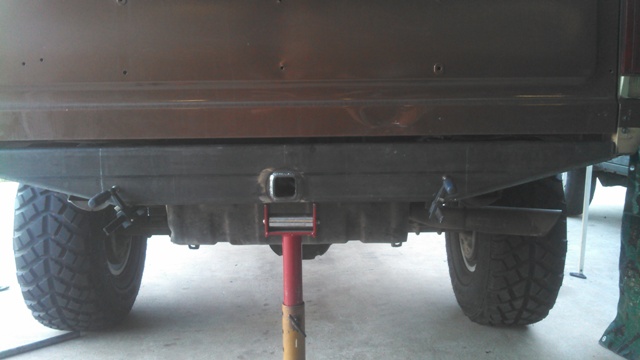

And started on the bumper. Lights on the outside and hitch in the middle. What do you guys think? Image

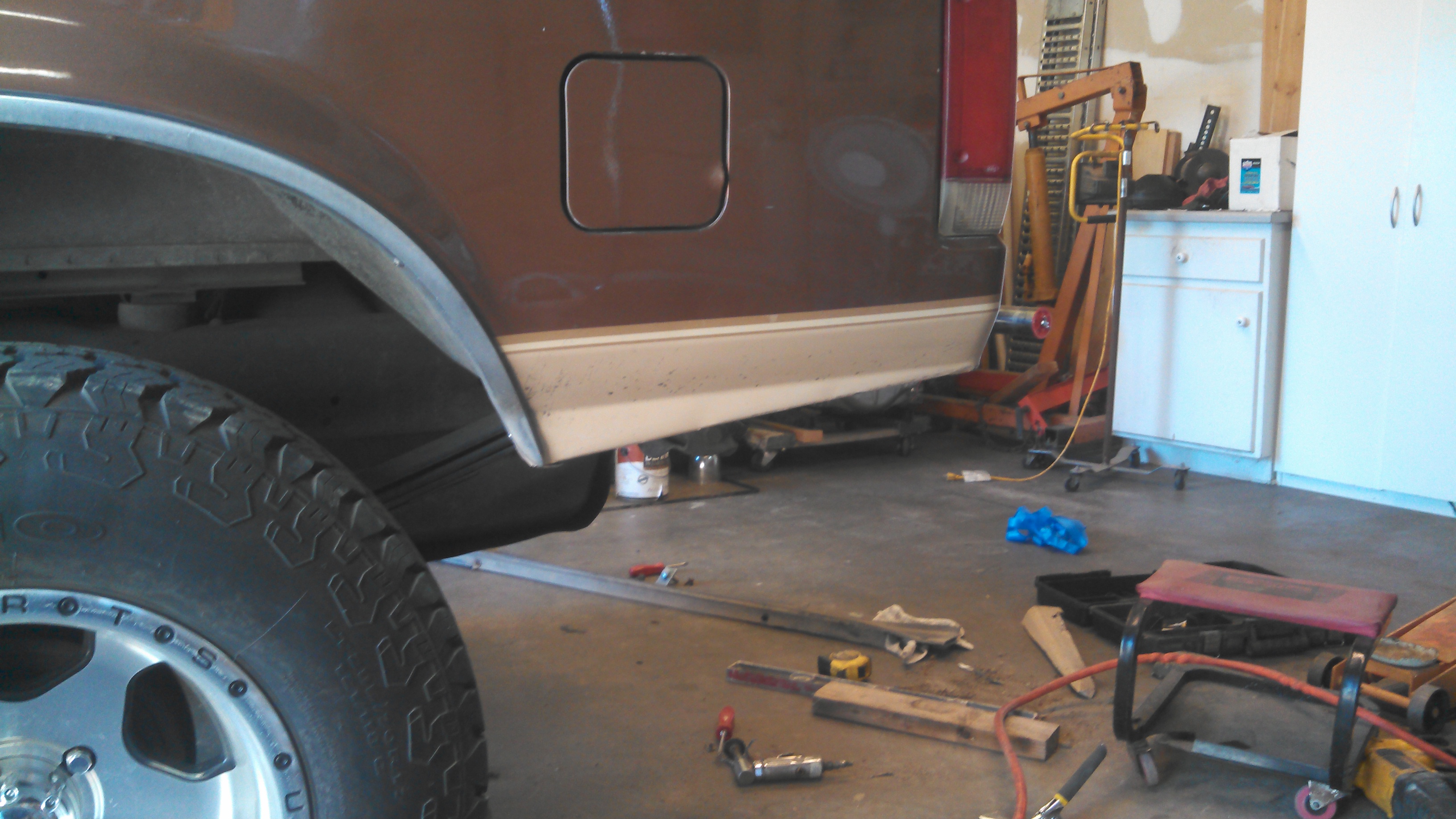

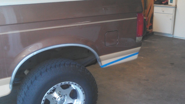

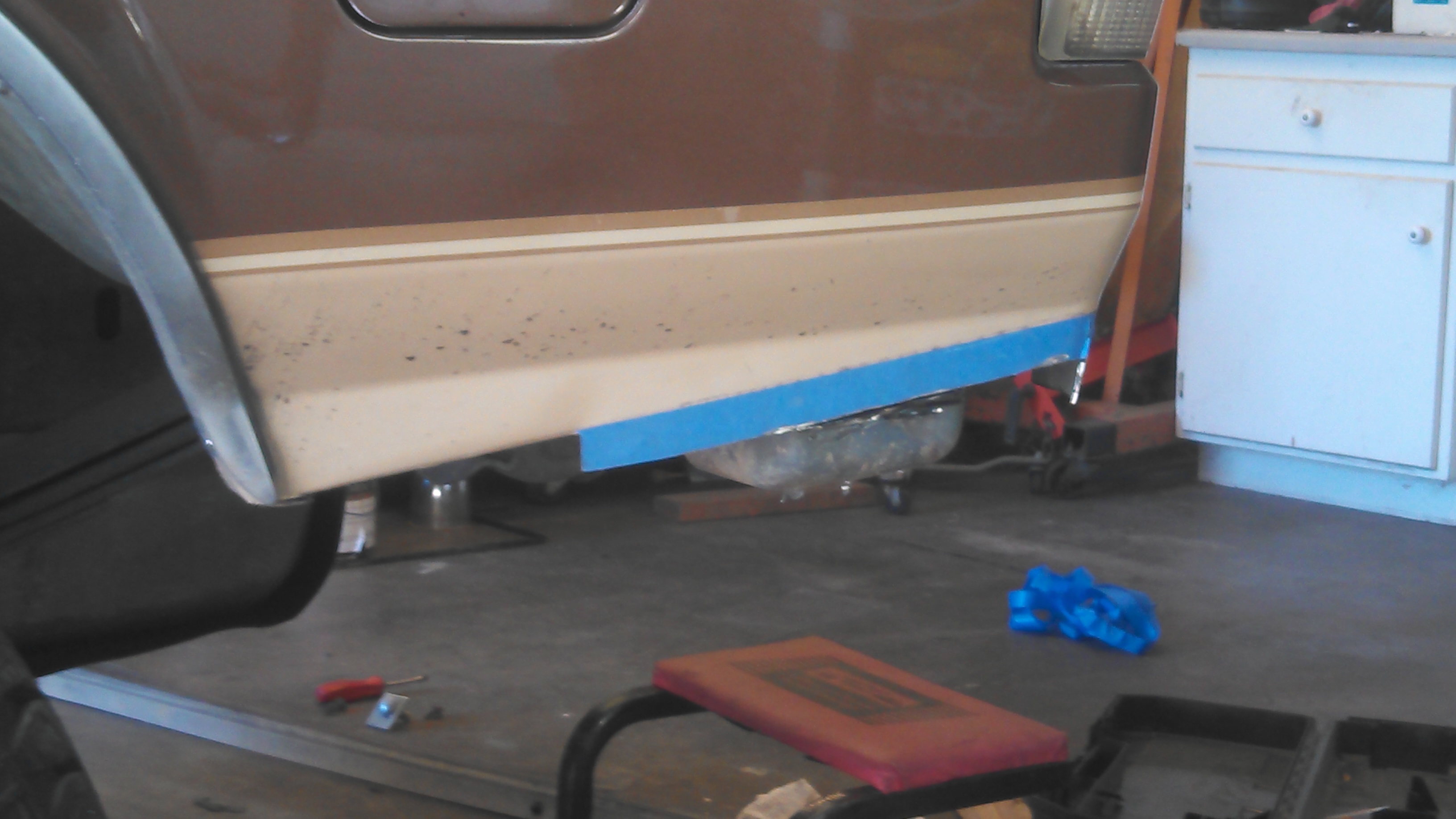

And I'm going to trim the fenders to match. Do I just cut them? Or do u need to worry about structure? A lot of sheet metal meets right there
Re: Nighthawk!
I was thinking about how I'd do this the other day. I would tape and mark up where I wanted the new line to be and then drop that line 5/8", trim there and then use a hammer and die to bend to the desired line. If the fender is a little flimsy after trimming a piece of rod could be attached cleany to limit any movement.
I have done several bumpers, a rock crawler style and a tube bumpers and one thing I like is to protect the corners. Please excuse the Chevy, it is the last one I have pictures of. I am not sure how I am doing mine this next time but I will probably have some type of corner protection.

I was considering corner protection and actually had something cut out already, but the aluminum panel on the tailgate will hit it. If I took the panel off (I don't want to) it would clear. Image
You can kinda get the idea. Cut it at the yellow line and that is the most narrow part of the fender. And then between the two sides I wanted to run a piece of 1-1/2" tubing to kind if make it "prerunner" and not so rock crawler. I don't want to move the bumper any lower because of the gap between the gate and bumper. I'm already 1-1/8" gap. I just really like the aluminum panel. Thoughts?

On one I had done, I put a filler plate under the tailgate after leaving space to clear the tailgate when down.
It might be interesting to radius cut the plating on the ends to follow the corner and tuck it close to the bottom of the fender. This is a basic idea with a bad sketch.

I'm not sure if I want it to wrap around the body, I was thinking just to the edge. I'm worried I might catch it on something. And the bumper sticks out from the body about an inch right now. I'm considering cutting the brackets, which are of course fully where's right now, off and moving the bumper in an inch to make it flush with the body. Then I'll have about 2-1/2" to work with without it hitting the tailgate.
Posts: 2230
Ya, I understand the worry of catching on stuff. I am interested to see how it turns out. It all ends in a compromise for one thing or an other.

I did my 1/4 panels by cutting and then adding a 1/2" bend for rigidity. I used 3 hand sheet metal clamps I picked up from Harbor Freight for $15 bucks. Worked pretty good, didn't even chip the paint.
