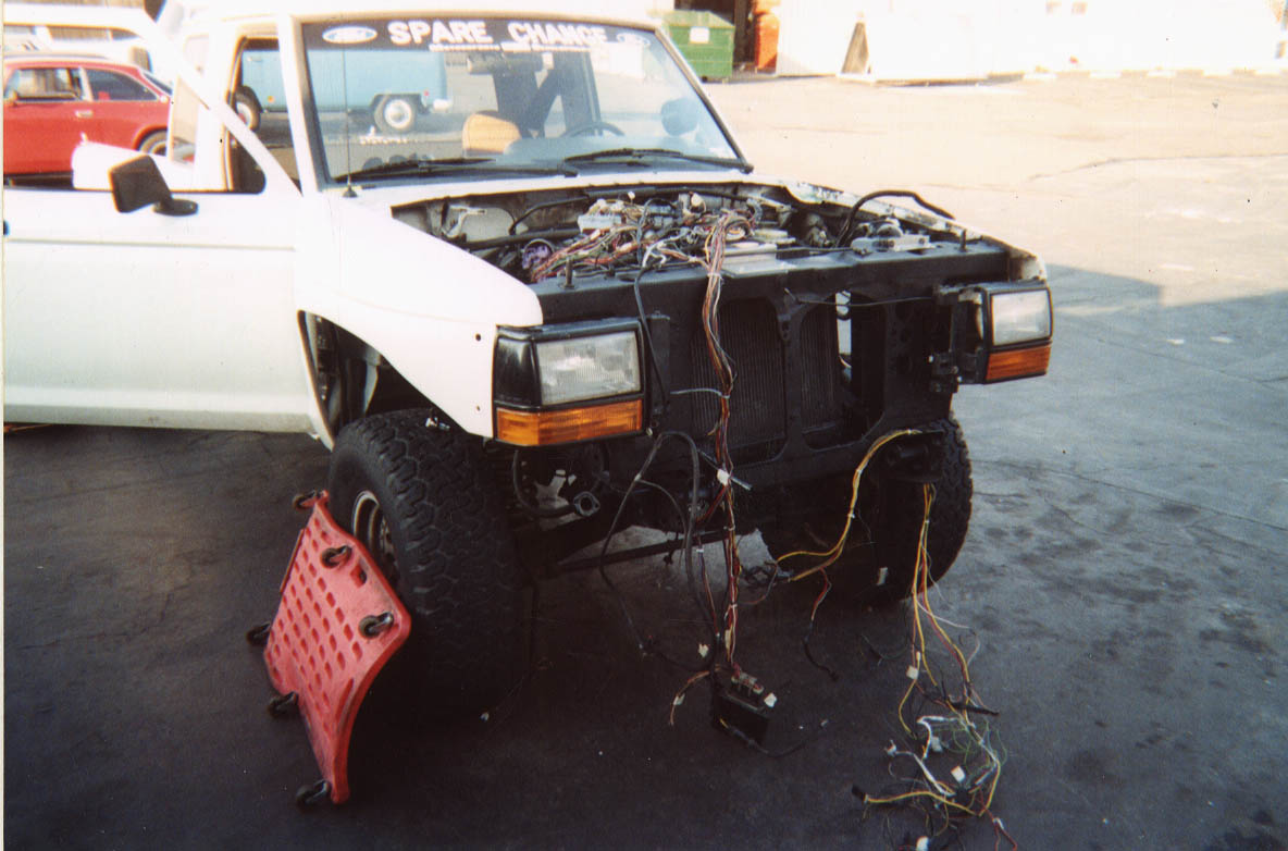

I see your abs harness and raise you whole engine compartment harness hahaImage
Andy J's 1995 xlt
Just reworking mine to tidy it upImage
Andy J's 1995 xlt
cs_drums wrote:Just reworking mine to tidy it upImage
Holy hell !! Right on !
I'm gonna do that next .
Finished my Shit for today .! Just need to loom it up, and make it look pretty .

I think everyone hates wiring. Reminds me of splicing the ranger wiring harness & the T-bird supercoupe harness together when I put the motor in the ranger. chiltons & haynes wiring diagram for each motor as they were each different & some right/some wrong, & then a lot of floorspace. Was SO glad when it was done. It was worth it though - just like this will be.
Re: Andy J's 1995 xlt
I like spaghetti but not that much.
That is one of my future duties on my Bronco. I am pulling the whole 1986 wiring and I have a 1990 wire harness along with the computer and 351w/408 swap. I plan to simplify the harness to the basic engine wiring. I plan to change the location and the engine bay connector to a waterproof military spec connection.
