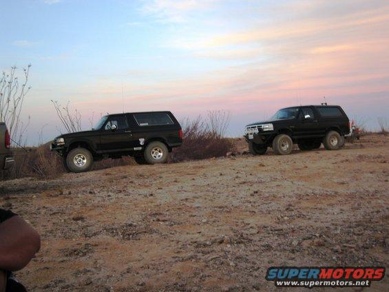

Out in the dirt... with Jelly!

Went to Barstow to play chase for Matt and the Kavedudes! Had a great day. Came home, and now the Bronco went to Keifer for a little love!
