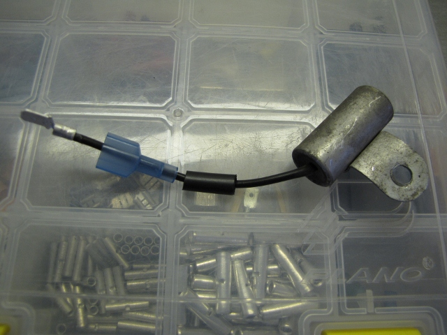

Progress is taking place. I've removed the complete EFI harness & started tidying it up... again. While it's out, I decided to add another filter. I have one at the ignition coil power lead (just as the factory does) but I decided (on my EFI guru's recommendation) to put one at the ECM as well.
Normally, I use OE connectors for just about everything but I didn't feel like digging through my totes full of harnesses to find the matching connector for the OE filter. I typically hate using insulated crimp connectors but for a non-critical connection like this, I don't mind using it. But, I do take some extra time to make sure it's not going to give me any grief later.
Crimped, soldered and ready to re-insulate. I did the same for the harness side except I added a piece of white heat-shrink tube and labeled it. No fancy connector kit required!

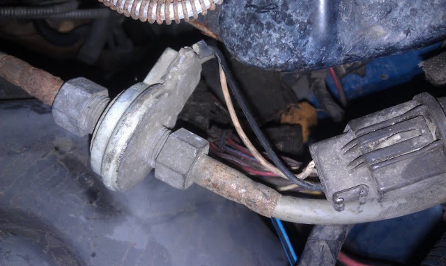

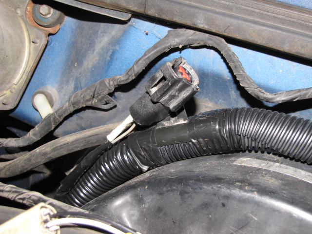

The harness is back in. I made a couple small changes while I had it out. I relocated the MAP sensor, altered the Oxygen Sensor lead and, most exciting, relocated the speed sensor. I originally added a speed sensor at the transfer case where the speedo cable was. This required several feet of wire (no big deal but more to route, loom and secure) and a custom speedometer cable... boo! Instead, I ran the speed sensor wires to above the brake booster and left the connector right on EFI harness loom. Then (here's the exciting part!), I tapped into the cruise control speed sensor and hung a connector out of the CC harness that will plug right into the EFI harness. Simple, effective, less climbing under the vehicle and one less sensor!

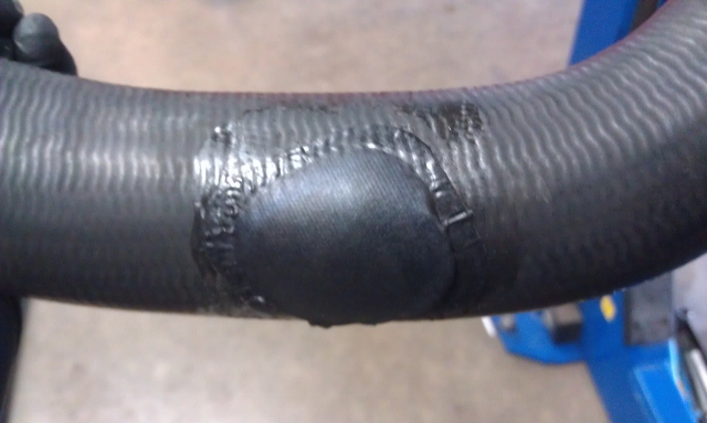

Good progress today. First, though, a repair that will make even the most discerning critics proud. A slight eyeball miscalculation resulted in a bit of fan/upper radiator hose contact. I was already going to get a different hose that fits better with the carb engine accessories and EFI intake but needed to drive it in the meantime. No problem. I got patches!

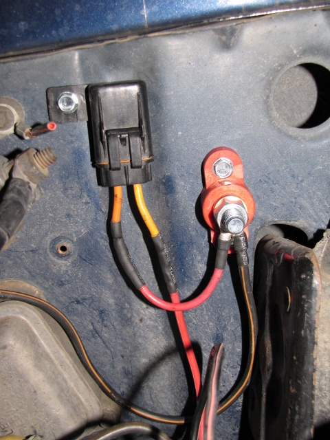

I also finally started permanently wiring in the radio. I used a junction post for battery to keep from having a bunch of battery power wires terminating at the battery cable end. I love these things. The really help clean up wiring. On a related note, I recently picked up some "marine" heat-shrink tubing at Harbor Freight. I had my doubts, but for $3.99 a box, it was definitely worth a shot. So far it works great and I'm loving having cheap adhesive-lined heat-shrink. I'll keep using the expensive stuff for critical wiring (EFI an such), but for just about everything else, heck yeah!
Here's how I usually terminate power/ground circuits that will be exposed to the elements.
Crimp uninsulated terminal and solder the end of the terminal and the seam.
Adhesive lined heat-shrink between the terminal body and wire insulation.

I forgot to add the photo of the junction post. Note the weather resistant fuse holder as well. I might add a small fuse box later but I have a few of these fuse holders, so I might as well use them. I still need to add loom to the cable from the battery to post for abrasion protection. I called it a night before started on the ground circuit for the radio. Maybe tomorrow.

Oh, almost forgot... Love the radiator hose patch/repair. Didn't even know that could be done. Gotta remember that one for future field repairs.
