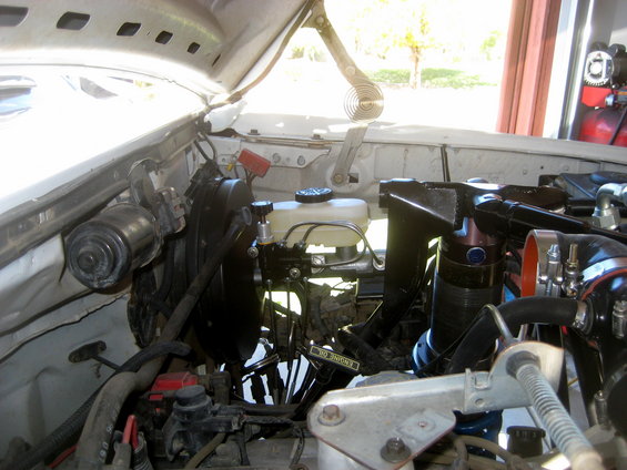

Big thanks to SteveG for doing all of the leg work on these shocks. I would have been in way over my head if he hadn't prepared everything for me. He had all of the parts, paperwork from Swayaway and build notes. Good stuff!! Thanks Steve!
Re: Brian's '96
yikes wrote:Heavy suckers too. They'll be over 80 with tenders and dividers.
Ha! I hated mocking up with those things when they were empty! Hopefully they don't have to come out for a long, long time!
Re: Brian's '96
The pistons in those things allow the shaft to rotate right?
Re: Brian's '96
philofab wrote:The pistons in those things allow the shaft to rotate right?
Yup.
Re: Brian's '96
Those things are just plain monsters! Wow! 8-) Cool factor of 10! Nice job Brian. I can't wait to see it out and about!

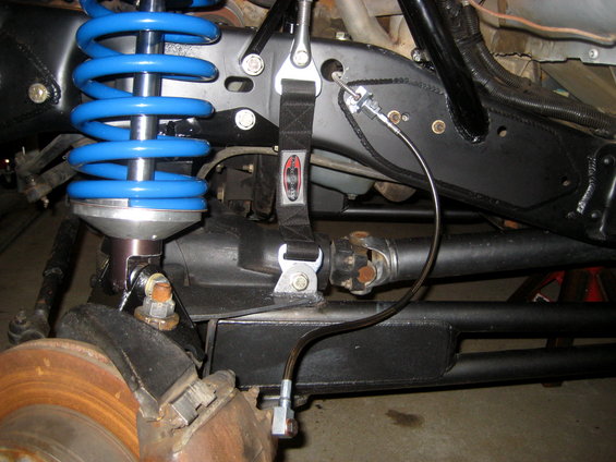

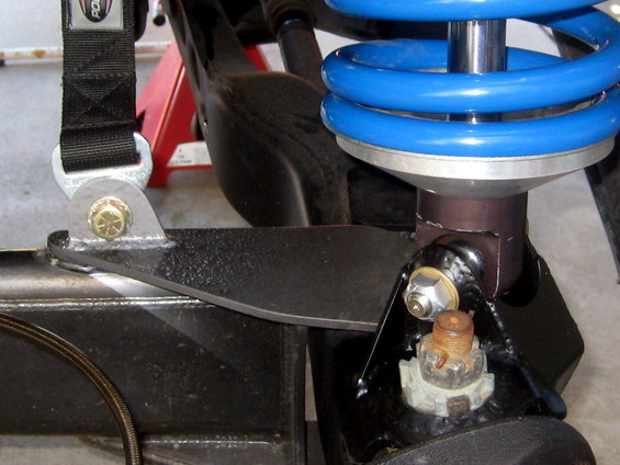

Added another gusset to the lower shock mounts...couldn't resist. It just looked like a weak spot.
Bumped, strapped and SHOCKED!!! Woohoooo!!

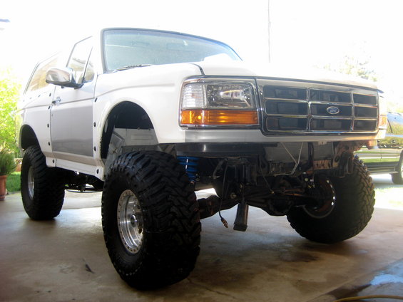

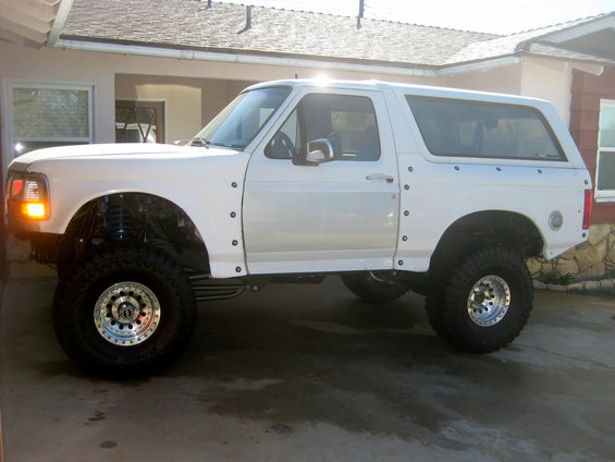

Look...no jack stands!! Woohooo! This is a monumental occasion for me. Still a long way to go, but I can finally see the light.
It's sitting an inch or two high right now because it's around 500lbs light in the rear and 200 in the front, but guess what? It's resting on the front coils with no tenders and around 1/4" preload. Should settle in just about right.
The brakes were the usual pain the neck. One of the factory fittings leaked at the master cylinder. Had to disassemble everything with fluid in it. Ahhhhhh! Hate brake systems sometimes. But they're plumbed, bled and ready to adjust in.

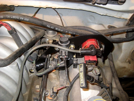

Managed to knock out one of the brackets tonight. I'm wiped though. After four 12-14 hour days I'm ready for a couple of hours of relaxing. Anyway. When I put headers on a few years ago, I removed a strut to the coil mount and never put it back. That resulted in repairing cracks a number of times. Haha! I didn't like using the header bolts for an anchor point, so as is the norm, I took the more unconventional approach.
