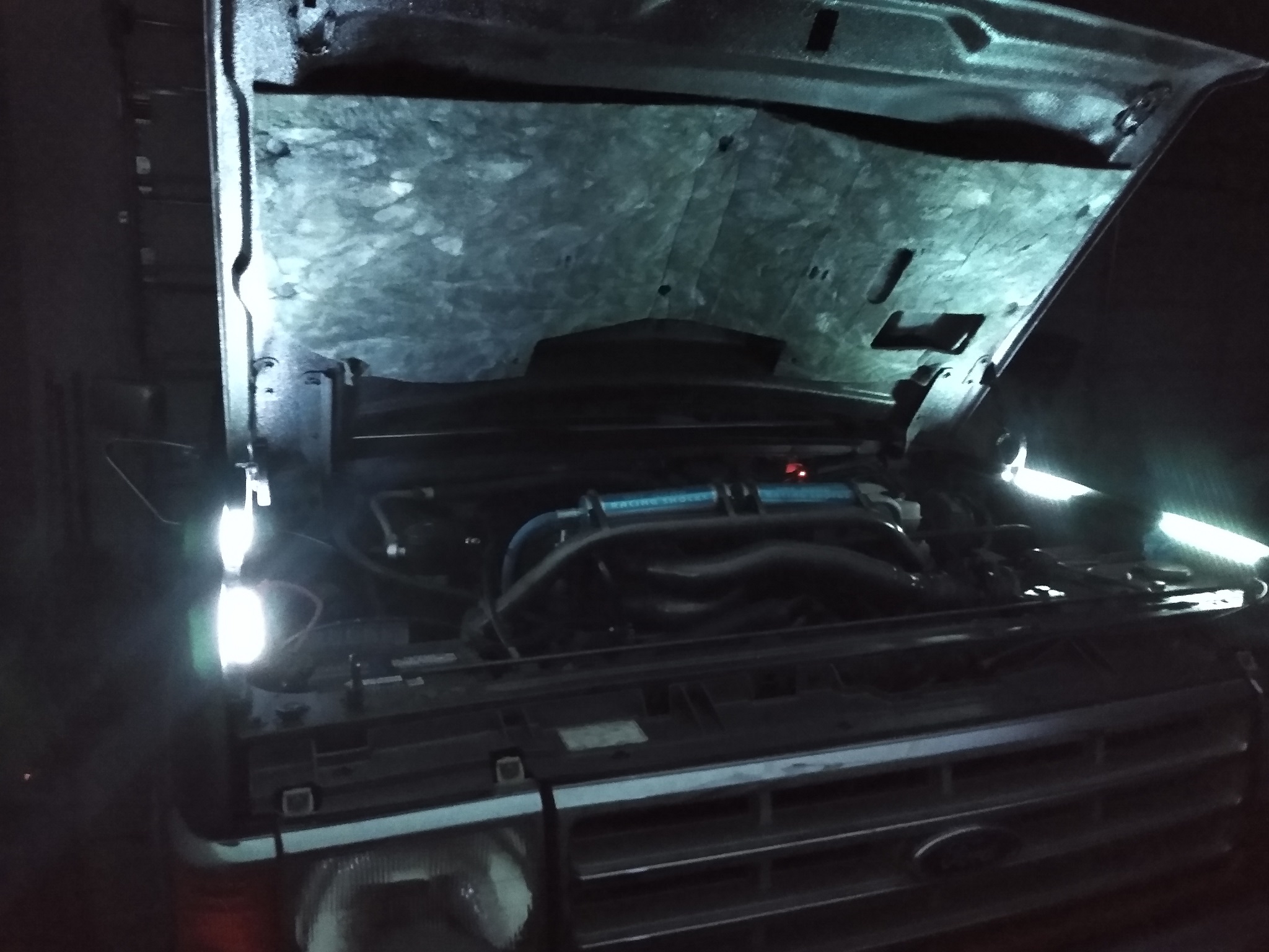

I almost went with a single point of light for the hood bay but I decided to use some waterproof LED strips instead. As you said, it's a constant hot wire so I spliced in my LED light strip switch so I now have an on/off button so they're on when I want.
I attached magnets to each strip and put them on the fender rails for the hood to rest on. So if I wanna go mall crawler, I can light em up and set em to the color I want and the light shows through the hood edges but really what matters is they stay in place and since they're located at all 4 points with long wires, I can move them around, stick em where I want, and/or use em as light sticks. They're long enough that I can pull a stick and check the front of my timing cover or anywhere on the sides/back of the block. I can even light up the fuel injectors under the plenum

Re: 1996 Eddie Bauer
Sometimes you need a pic to tell the story

Those underhood strips are nice! I thought about going that way, and copying what i had on my Tacoma. I don't have any pictures handy, but i used a plunger switch, so it came on automatically when you popped the hood, and turned off when you shut it.

Smart! I have a fiberglass hood so I lost the "pop the hood n turn the light on" function since it's grounded through the hood steel. I think my hood is open more than I drive it too so I'd say my battery is happier but that plunger idea is good if shit stops breakin

Interesting, the older ones must be different. Mine had a 2 wire pigtail, and i put the plunger on the fender. It would be in the core support.entity-unknown wrote:Smart! I have a fiberglass hood so I lost the "pop the hood n turn the light on" function since it's grounded through the hood steel. I think my hood is open more than I drive it too so I'd say my battery is happier but that plunger idea is good if shit stops breakin
