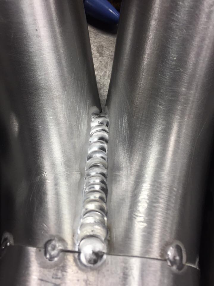

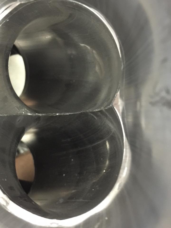

Some quick updates as we get close to Norra and stuff. For starters Edelbrock jumped on board and sent some Victor Jr. aluminum heads and other goodies as well as ZSR race engines. So I decided to pull the trigger and build a 408w. A lot of different people talked me into this versus go with a ford crate motor. This allowed me to consult the right people and build for my needs and make it Mexico reliable without questioning running Pemex.
After realizing that the constricting issue with Ford EFI is the availability of air at the intake we have decided to make a in house 3" to dual 2.25" intake manifold for packaging reasons and to help it breathe a little better.

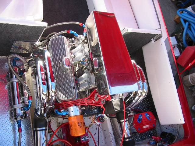

MOTOR OPTIONS ....or if your thinking BBF motor ....why not a BBC ....cause I got this for sale. 730hp BBC 700 foot pounds of torq. make you a killer deal low hours and cheaper then building new. haha
