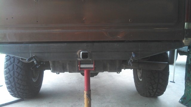

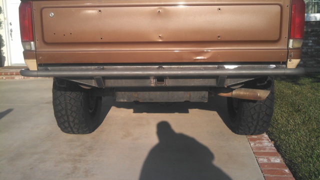

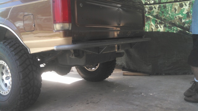

So I'm going to build a back bumper soon. I want it to have a receiver and be able to tow something. Obviously nothing huge but if I need to pull a small flat bed or something I'd like to be able to. Does anyone have any good pics of how the mounted theirs and if they can tow with it? I would appreciate any pictures. I'm thinking I might do some sort of hybrid tube/plate bumper.

Re: Nighthawk!
Taylor (Nubreed71) just had a sweet rear bumper made for his F-150. Pics in his thread. It's not a bronco, but close enough.
And I think RobertCrav has pics of his seat move in his thread.

Nubreed's bumper is pretty sweet! I was debating running mine a bit wider to cover the rear corners.

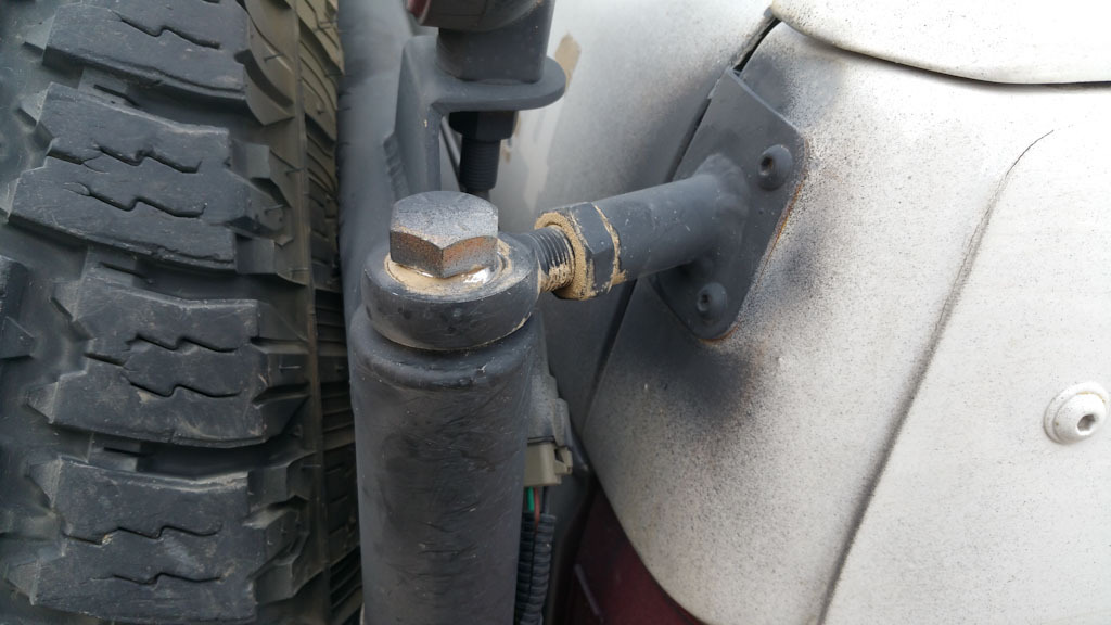

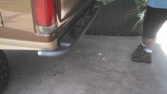

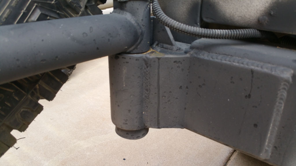

Almost finished with mine. I still need to add a removable dual spare tire mount and plate the top....Also doubles as a 2 gallon air tank, I just need to find the right compressor and plump it.
Cool design! Id like to see how you will do the hinges for the spares.
Re: Nighthawk!
Cactus Cooler wrote:Almost finished with mine. I still need to add a removable dual spare tire mount and plate the top....Also doubles as a 2 gallon air tank, I just need to find the right compressor and plump it.
I'm loving how that is lookin!! Really similar to the one I have pictured in my head.

Hey Cactus is that 2x6? I really like that. I'm also interested in the way you're going to mount the hinges for the carriers.

Cactus do you have pics of the mounting? Just 1/4" plate? And reinforcements?

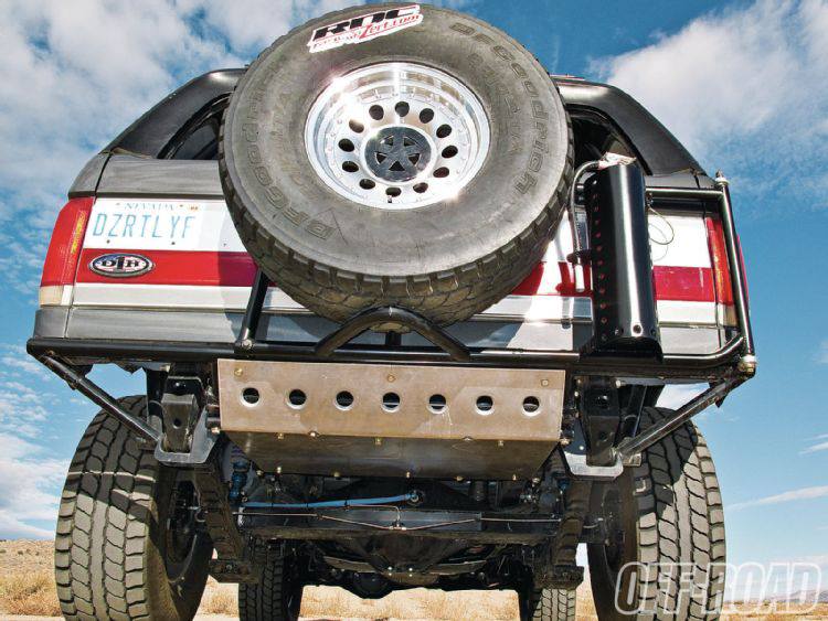

Thought was to use a spindle mount inverted on the bumper( spindle being mounted on the rack) and plated top and bottom (so when not in use it could be removed), then for the top of the tire hanger use a heim and some how it be tied into the cage ( like 1st & 4 pic ). Probably over kill, but why do it twice. Really just coping some ideas that I have seen on here and with some tweaks making it my own. Not sure if will be for 2 spares.... or 1 and cooler... or what ever. At the moment my tire is mounted in the drivers side behind the back seat.

And yes Nighthawk 2x6, had some left over from another project.
